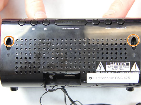

    • Disconnect the radio from all power sources.
    • Remove the two 10 mm Phillips #1 screws from the bottom of the device.
    • Remove two 10 mm Phillips #1 screws from the back side of the device.

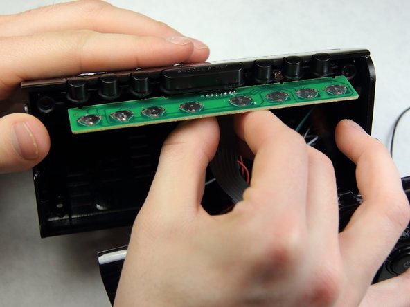

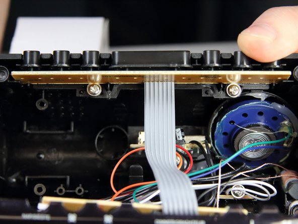

  4. Electrohome EAAC475 Speaker Replacement: crwdns2935265:04crwdnd2935265:01crwdnd2935265:03crwdne2935265:0 Electrohome EAAC475 Speaker Replacement: crwdns2935265:04crwdnd2935265:02crwdnd2935265:03crwdne2935265:0 Electrohome EAAC475 Speaker Replacement: crwdns2935265:04crwdnd2935265:03crwdnd2935265:03crwdne2935265:0
    • Carefully and slowly pull the lower case away from the rest of the device.
    • Do not completely separate the lower case. There are several wires connecting the two halves of the device.
    • Flip the device over to access the button assembly.
    • Slowly remove the button contact board from the assembly.

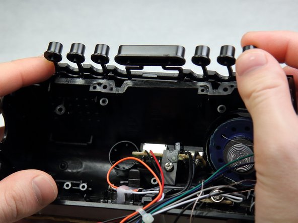

  5. Electrohome EAAC475 Speaker Replacement: crwdns2935265:05crwdnd2935265:01crwdnd2935265:02crwdne2935265:0 Electrohome EAAC475 Speaker Replacement: crwdns2935265:05crwdnd2935265:02crwdnd2935265:02crwdne2935265:0
    • Remove the two 7 mm Phillips # 1 screws holding the buttons.
    • Remove the plastic buttons.

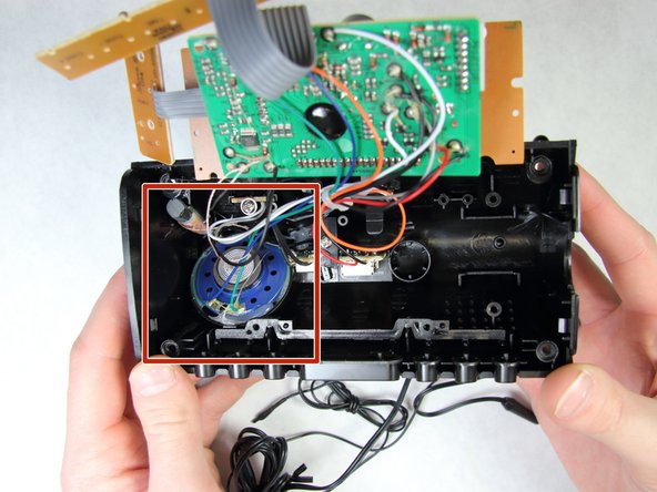

  6. Electrohome EAAC475 Speaker Replacement, Speaker: crwdns2935265:06crwdnd2935265:01crwdnd2935265:02crwdne2935265:0 Electrohome EAAC475 Speaker Replacement, Speaker: crwdns2935265:06crwdnd2935265:02crwdnd2935265:02crwdne2935265:0
    • Carefully and slowly detach one side from another.
    • Make sure the opposite sides are not separated completely.
    • Locate the speaker the inside of the back piece of the device

  9. Electrohome EAAC475 Speaker Replacement: crwdns2935265:09crwdnd2935265:01crwdnd2935265:01crwdne2935265:0
    • Detach the wires on the speaker and replace them with new ones.
