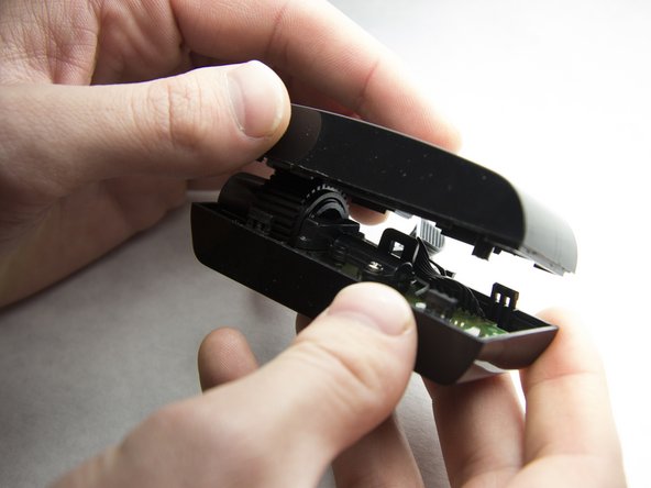

  3. Electrohome EAAC475 Projector Lens Replacement, Projector Lens: crwdns2935265:03crwdnd2935265:01crwdnd2935265:01crwdne2935265:0
    • Slowly and carefully move one side away from another without detaching anything on the device.

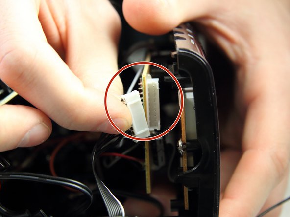

  5. Electrohome EAAC475 Projector Lens Replacement: crwdns2935265:05crwdnd2935265:01crwdnd2935265:02crwdne2935265:0 Electrohome EAAC475 Projector Lens Replacement: crwdns2935265:05crwdnd2935265:02crwdnd2935265:02crwdne2935265:0
    • Unplug the projector's connector from the circuit board.

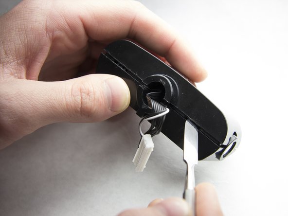

  7. Electrohome EAAC475 Projector Lens Replacement: crwdns2935265:07crwdnd2935265:01crwdnd2935265:03crwdne2935265:0 Electrohome EAAC475 Projector Lens Replacement: crwdns2935265:07crwdnd2935265:02crwdnd2935265:03crwdne2935265:0 Electrohome EAAC475 Projector Lens Replacement: crwdns2935265:07crwdnd2935265:03crwdnd2935265:03crwdne2935265:0
    • Using a metal spudger, pry into the crease until it separates enough to slip the spudger between the pieces.
    • Slide the tool along the crease to separate.
