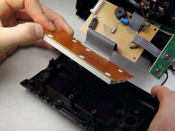

    1. Electrohome EAAC475 Display Replacement, Buttons: crwdns2935265:03crwdnd2935265:01crwdnd2935265:02crwdne2935265:0 Electrohome EAAC475 Display Replacement, Buttons: crwdns2935265:03crwdnd2935265:02crwdnd2935265:02crwdne2935265:0
      • Disconnect the radio from all power sources.
      • Remove the two 10 mm Phillips #1 screws from the bottom of the device.
      • Remove two 10 mm Phillips #1 screws from the back side of the device.
    2. Electrohome EAAC475 Display Replacement: crwdns2935265:04crwdnd2935265:01crwdnd2935265:03crwdne2935265:0 Electrohome EAAC475 Display Replacement: crwdns2935265:04crwdnd2935265:02crwdnd2935265:03crwdne2935265:0 Electrohome EAAC475 Display Replacement: crwdns2935265:04crwdnd2935265:03crwdnd2935265:03crwdne2935265:0
      • Carefully and slowly pull the lower case away from the rest of the device.
      • Do not completely separate the lower case. There are several wires connecting the two halves of the device.
      • Flip the device over to access the button assembly.
      • Slowly remove the button contact board from the assembly.

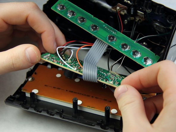

    1. Electrohome EAAC475 Display Replacement, Display: crwdns2935265:06crwdnd2935265:01crwdnd2935265:02crwdne2935265:0 Electrohome EAAC475 Display Replacement, Display: crwdns2935265:06crwdnd2935265:02crwdnd2935265:02crwdne2935265:0
      • Remove the two 8 mm Phillips screws supporting the circuit board.
      • Pull off the circuit board to access the panels below.
    2. Electrohome EAAC475 Display Replacement: crwdns2935265:07crwdnd2935265:01crwdnd2935265:02crwdne2935265:0 Electrohome EAAC475 Display Replacement: crwdns2935265:07crwdnd2935265:02crwdnd2935265:02crwdne2935265:0
      • Remove the two 6 mm Phillips screws supporting the mini circuit board for the frontal buttons.
      • Remove the mini circuit board.
    3. Electrohome EAAC475 Display Replacement: crwdns2935265:08crwdnd2935265:01crwdnd2935265:02crwdne2935265:0 Electrohome EAAC475 Display Replacement: crwdns2935265:08crwdnd2935265:02crwdnd2935265:02crwdne2935265:0

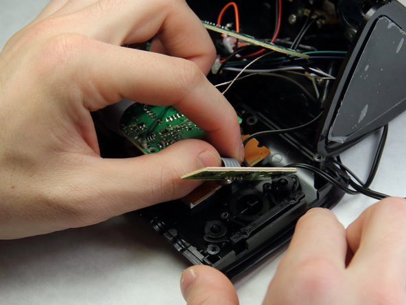

      • Move the now free circuit boards away from the display.
      • Remove the final two 7 mm Phillips screws securing the display.
      • Pull the display screen away from the casing.
    4. Electrohome EAAC475 Display Replacement: crwdns2935265:09crwdnd2935265:01crwdnd2935265:01crwdne2935265:0
      • You have successfully accessed the display.
      • Replacing the display with a new one will be challenging as soldering and connecting micro wires are necessary.
