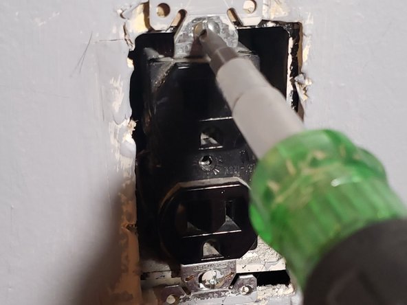

    • Using a flat-head screwdriver, remove the outer cover plate of the outlet by unscrewing the middle screw.

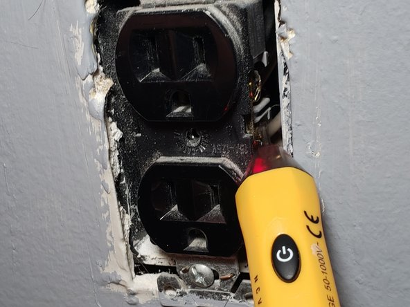

  3. Electrical Outlet/Receptacle Replacement, Determine voltage absence: crwdns2935265:03crwdnd2935265:01crwdnd2935265:02crwdne2935265:0 Electrical Outlet/Receptacle Replacement, Determine voltage absence: crwdns2935265:03crwdnd2935265:02crwdnd2935265:02crwdne2935265:0
    • Use a Duspol or any other Voltmeter to test if there is voltage at the contacts.
    • You can also use a single pole phase tester, but that's not the proper way to do it.
    • Do not work on live circuits if you are not an experienced professional.

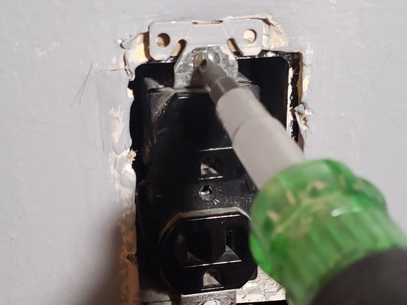

  4. Electrical Outlet/Receptacle Replacement: crwdns2935265:04crwdnd2935265:01crwdnd2935265:02crwdne2935265:0 Electrical Outlet/Receptacle Replacement: crwdns2935265:04crwdnd2935265:02crwdnd2935265:02crwdne2935265:0
    • Unscrew the top and bottom screws holding the outlet into the interior electrical box.
    • The screws on outlets vary. They may have either a phillips head or a flat head, so use the screwdriver that works with your screws

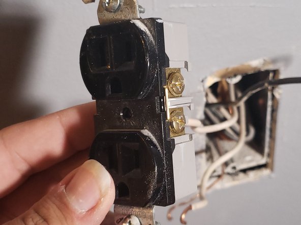

    • Holding the top and bottom tabs of the outlet, pull the outlet away from the wall, exposing the wires inside the electrical box.
  6. Electrical Outlet/Receptacle Replacement: crwdns2935265:06crwdnd2935265:01crwdnd2935265:02crwdne2935265:0 Electrical Outlet/Receptacle Replacement: crwdns2935265:06crwdnd2935265:02crwdnd2935265:02crwdne2935265:0
    • Unscrew each screw and free the wire from under it.
    • Styles that have wires inserted into the back of the outlet will require you to pull and twist the outlet to free the wires.

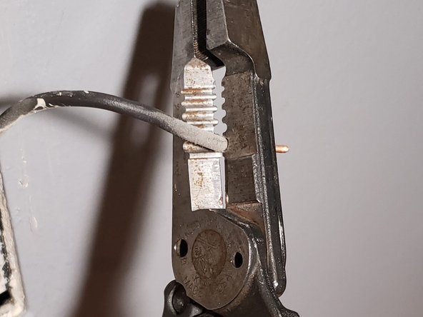

    • Using a pair of wire strippers, place the wire into each groove, closing the wire strippers around the wire to find the size that barely does not fit around the wires.
    • In the United States, residential wires are typically 12 gauge or 14 gauge, denoted by 12 and 14 on the wire strippers.
  8. Electrical Outlet/Receptacle Replacement: crwdns2935265:08crwdnd2935265:01crwdnd2935265:02crwdne2935265:0 Electrical Outlet/Receptacle Replacement: crwdns2935265:08crwdnd2935265:02crwdnd2935265:02crwdne2935265:0

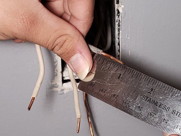

    • For each wire, approximately 0.75 inches (2 centimeters) away from the clipped end of the wire, clamp the strippers down on the wire and pull the strippers toward the clipped end of the wire, revealing the bare wire underneath.

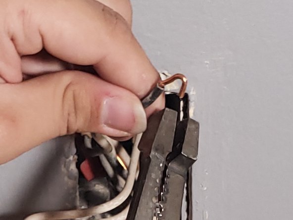

  9. Electrical Outlet/Receptacle Replacement: crwdns2935265:09crwdnd2935265:01crwdnd2935265:03crwdne2935265:0 Electrical Outlet/Receptacle Replacement: crwdns2935265:09crwdnd2935265:02crwdnd2935265:03crwdne2935265:0 Electrical Outlet/Receptacle Replacement: crwdns2935265:09crwdnd2935265:03crwdnd2935265:03crwdne2935265:0

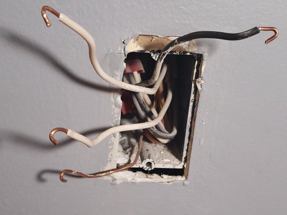

    • For each wire, using a pair of wire strippers or pliers, take hold of the exposed tip of the wire, and curve the tip of the wire, making a small hook.
    • Separate the wires so that the black wires are on the right and the rest are on the left, with the ground wire at the bottom.

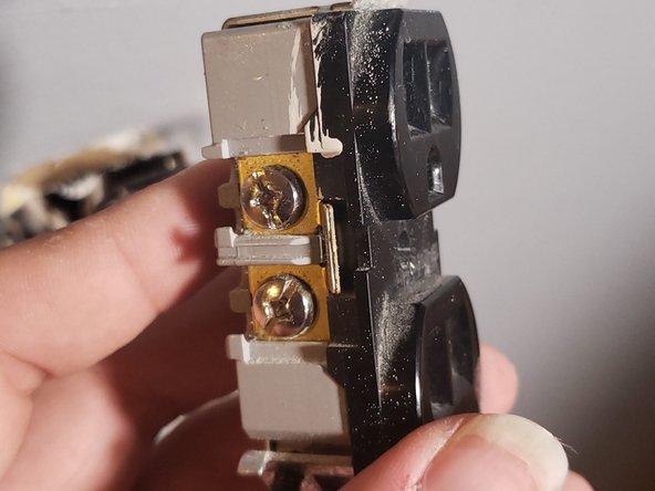

    • Loosen all of the screws on the new outlet
  12. Electrical Outlet/Receptacle Replacement: crwdns2935265:012crwdnd2935265:01crwdnd2935265:02crwdne2935265:0 Electrical Outlet/Receptacle Replacement: crwdns2935265:012crwdnd2935265:02crwdnd2935265:02crwdne2935265:0
    • Hold the outlet with face of the outlet pointing toward you, with the copper screws on the right, and the silver screws on the left.
