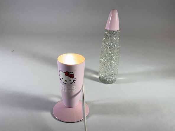

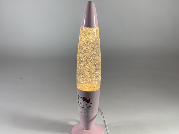

    • Unplug the electric lava lamp and wait for it to cool down.
    • Warning: If the lightbulb/lamp is still hot while trying to replace it, it could cause severe burns and injuries

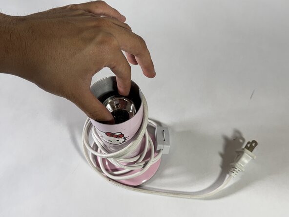

  2. Electric Lava Lamp Lightbulb Replacement: crwdns2935265:02crwdnd2935265:01crwdnd2935265:02crwdne2935265:0 Electric Lava Lamp Lightbulb Replacement: crwdns2935265:02crwdnd2935265:02crwdnd2935265:02crwdne2935265:0

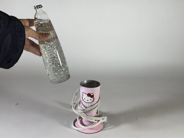

    • Remove the pink covering of the lava lamp by simply lifting it, and do the same for the bottle section.
  3. Electric Lava Lamp Lightbulb Replacement: crwdns2935265:03crwdnd2935265:01crwdnd2935265:01crwdne2935265:0

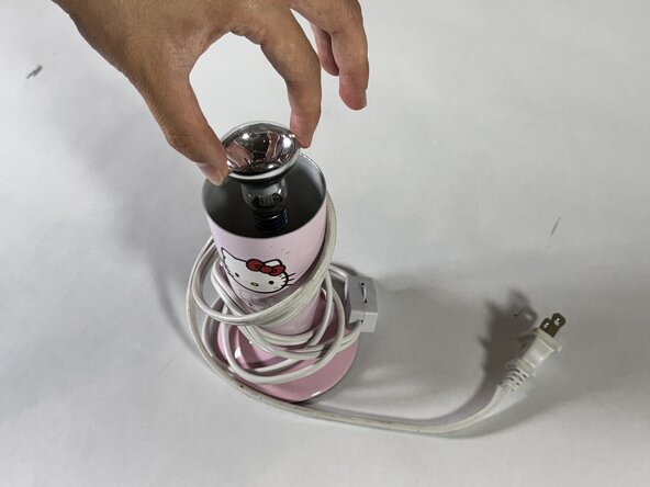

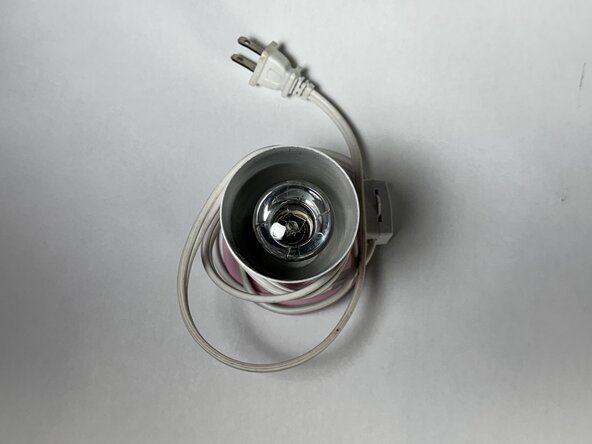

    • Once everything has been removed the lightbulb will be visible.
  4. Electric Lava Lamp Lightbulb Replacement: crwdns2935265:04crwdnd2935265:01crwdnd2935265:03crwdne2935265:0 Electric Lava Lamp Lightbulb Replacement: crwdns2935265:04crwdnd2935265:02crwdnd2935265:03crwdne2935265:0 Electric Lava Lamp Lightbulb Replacement: crwdns2935265:04crwdnd2935265:03crwdnd2935265:03crwdne2935265:0
    • Place your fingers around the lightbulb and slowly twist in a leftward (counterclockwise) direction until it becomes loose.
  5. Electric Lava Lamp Lightbulb Replacement: crwdns2935265:05crwdnd2935265:01crwdnd2935265:02crwdne2935265:0 Electric Lava Lamp Lightbulb Replacement: crwdns2935265:05crwdnd2935265:02crwdnd2935265:02crwdne2935265:0

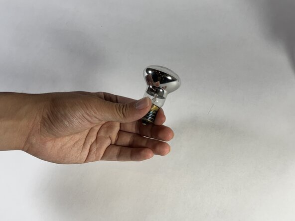

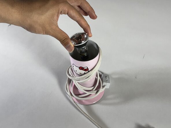

    • Slowly take out the lightbulb and replace it with the new one.
  6. Electric Lava Lamp Lightbulb Replacement: crwdns2935265:06crwdnd2935265:01crwdnd2935265:02crwdne2935265:0 Electric Lava Lamp Lightbulb Replacement: crwdns2935265:06crwdnd2935265:02crwdnd2935265:02crwdne2935265:0
    • You've successfully replaced the lightbulb!
