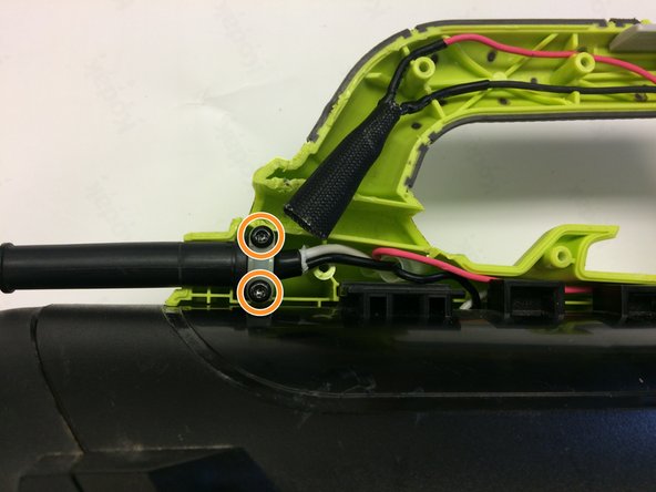

    • Locate the 7 screws along the handle and remove them with the #16 5 point star screwdriver
    • Locate the 2 additional screws on the under-body and remove them

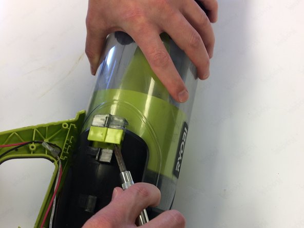

    • Gently wedge apart the handle being careful not to damage the wiring inside.
    • Carefully separate the two parts of the handle

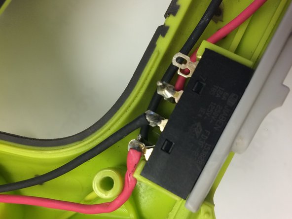

    • Remove the grey switch plate. Note how the wiring is laid out on your particular model as it may vary.
    • Remove the 2 screws and spacer holding the plug in.

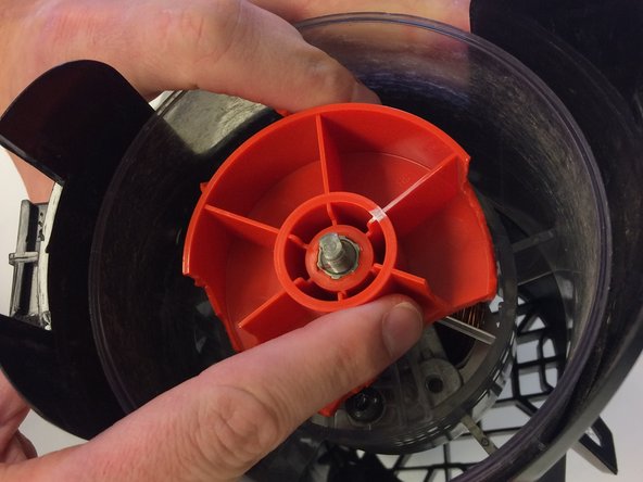

  5. Electric Jet Fan Blower blade fan Replacement: crwdns2935265:05crwdnd2935265:01crwdnd2935265:03crwdne2935265:0 Electric Jet Fan Blower blade fan Replacement: crwdns2935265:05crwdnd2935265:02crwdnd2935265:03crwdne2935265:0 Electric Jet Fan Blower blade fan Replacement: crwdns2935265:05crwdnd2935265:03crwdnd2935265:03crwdne2935265:0

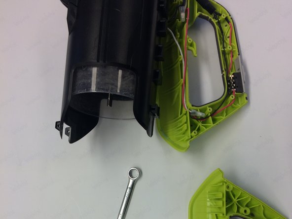

    • Gently wedge the chute away from the main carriage. It may be on tight but should come apart with light pressure.
  6. Electric Jet Fan Blower blade fan Replacement: crwdns2935265:06crwdnd2935265:01crwdnd2935265:03crwdne2935265:0 Electric Jet Fan Blower blade fan Replacement: crwdns2935265:06crwdnd2935265:02crwdnd2935265:03crwdne2935265:0 Electric Jet Fan Blower blade fan Replacement: crwdns2935265:06crwdnd2935265:03crwdnd2935265:03crwdne2935265:0

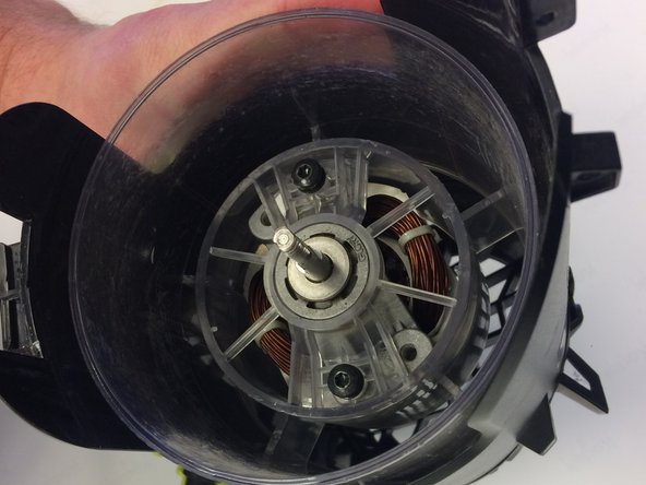

    • Remove nut with a ½” wrench (or socket) clockwise while holding the fan blade still.
    • The fan blade should easily slide off once the nut is removed. If you are looking to replace your fan blade, you are now able to slide one on.

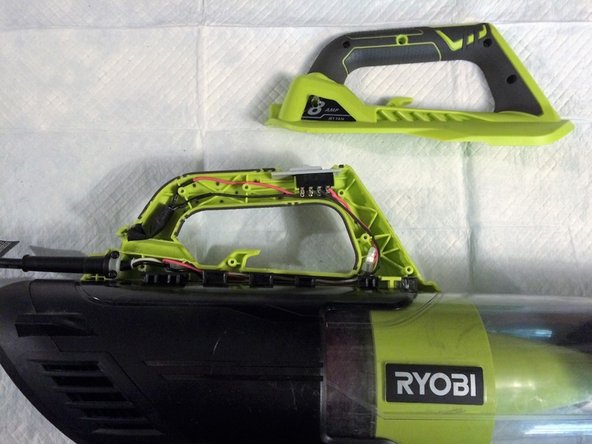

  7. Electric Jet Fan Blower blade fan Replacement: crwdns2935265:07crwdnd2935265:01crwdnd2935265:01crwdne2935265:0
    • The fully disassembled Ryobi Electric Jet Fan Blower
