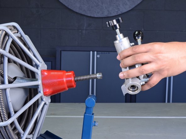

  1. Electric Eel Top Feeder Assembly Replacement, Remove the Guide Spring: crwdns2935265:01crwdnd2935265:01crwdnd2935265:03crwdne2935265:0 Electric Eel Top Feeder Assembly Replacement, Remove the Guide Spring: crwdns2935265:01crwdnd2935265:02crwdnd2935265:03crwdne2935265:0 Electric Eel Top Feeder Assembly Replacement, Remove the Guide Spring: crwdns2935265:01crwdnd2935265:03crwdnd2935265:03crwdne2935265:0
    • Unplug your drain cleaner before starting this guide. Because this device may have been used in a septic setting, it should be cleaned and disinfected as much as possible before disassembly.
    • Wear gloves to protect your hands from injury when handling the cable.
    • Ensure the cable is completely retracted into the auto-feeder.
    • Twist the guide spring counter-clockwise to unscrew it from the auto-feeder.
    • Remove the guide spring.

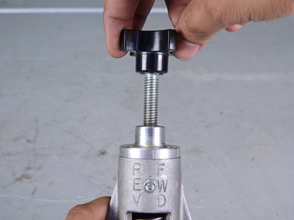

  2. Electric Eel Top Feeder Assembly Replacement, Release the Tension Spring: crwdns2935265:02crwdnd2935265:01crwdnd2935265:03crwdne2935265:0 Electric Eel Top Feeder Assembly Replacement, Release the Tension Spring: crwdns2935265:02crwdnd2935265:02crwdnd2935265:03crwdne2935265:0 Electric Eel Top Feeder Assembly Replacement, Release the Tension Spring: crwdns2935265:02crwdnd2935265:03crwdnd2935265:03crwdne2935265:0
    • Unscrew the tension knob to loosen the tension spring in the top feeder assembly.

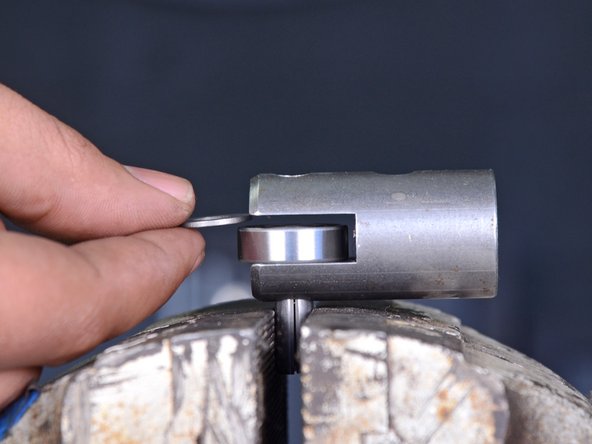

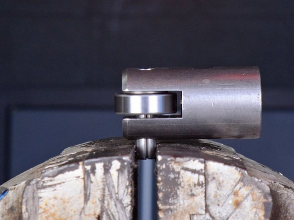

  7. Electric Eel Top Feeder Assembly Replacement, Install the Roll Pin: crwdns2935265:07crwdnd2935265:01crwdnd2935265:01crwdne2935265:0
    • Use a vise to compress the roll pin until there is no longer space in the roll pin's slot.
  8. Electric Eel Top Feeder Assembly Replacement: crwdns2935265:08crwdnd2935265:01crwdnd2935265:03crwdne2935265:0 Electric Eel Top Feeder Assembly Replacement: crwdns2935265:08crwdnd2935265:02crwdnd2935265:03crwdne2935265:0 Electric Eel Top Feeder Assembly Replacement: crwdns2935265:08crwdnd2935265:03crwdnd2935265:03crwdne2935265:0
    • Use a dead blow hammer or mallet to tap down the bearing carrier onto the roll pin until the pin just begins to peek into the bearing channel.
    • Ensure you are using the correct bearing carrier for this step. The top bearing assembly uses the shorter carrier, while the two lower bearing assemblies use the longer carrier.
  9. Electric Eel Top Feeder Assembly Replacement: crwdns2935265:09crwdnd2935265:01crwdnd2935265:03crwdne2935265:0 Electric Eel Top Feeder Assembly Replacement: crwdns2935265:09crwdnd2935265:02crwdnd2935265:03crwdne2935265:0 Electric Eel Top Feeder Assembly Replacement: crwdns2935265:09crwdnd2935265:03crwdnd2935265:03crwdne2935265:0
    • Insert a bearing and the bearing spacer into the bearing channel.
    • Ensure that the bearing and spacer are aligned with the roll pin and hole in the bearing carrier.
  10. Electric Eel Top Feeder Assembly Replacement: crwdns2935265:010crwdnd2935265:01crwdnd2935265:01crwdne2935265:0
    • Continue to tap down the bearing carrier until the bearing and spacer are fully secured around the roll pin.
    • You will need to unclamp and reposition the roll pin upwards to continue tapping it into the bearing carrier. Do this as many times as is necessary to sufficiently support the roll pin.
  11. Electric Eel Top Feeder Assembly Replacement: crwdns2935265:011crwdnd2935265:01crwdnd2935265:01crwdne2935265:0
    • Use a roll pin punch to finish seating the roll pin into place.
    • Place a piece of cloth or mat on top of the vise below the bearing carrier to prevent marring the outer surface of the bearing carrier.
    • Before moving to the next step, ensure the roll pin is fully seated and completely within the bearing carrier. A slightly exposed roll pin may damage the inside of your feeder body when the bearing carrier assembly is being installed.

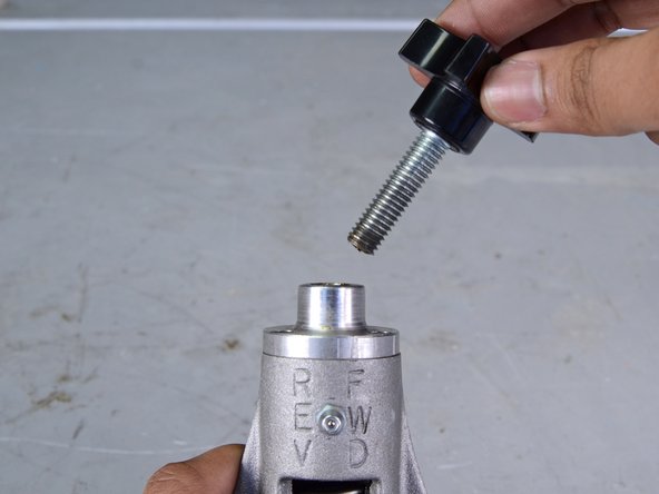

  12. Electric Eel Top Feeder Assembly Replacement, Remove the Tension Knob: crwdns2935265:012crwdnd2935265:01crwdnd2935265:03crwdne2935265:0 Electric Eel Top Feeder Assembly Replacement, Remove the Tension Knob: crwdns2935265:012crwdnd2935265:02crwdnd2935265:03crwdne2935265:0 Electric Eel Top Feeder Assembly Replacement, Remove the Tension Knob: crwdns2935265:012crwdnd2935265:03crwdnd2935265:03crwdne2935265:0
    • Unscrew and remove the tension knob from the top feeder assembly.

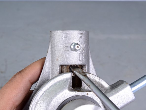

  15. Electric Eel Top Feeder Assembly Replacement, Remove the Control Finger: crwdns2935265:015crwdnd2935265:01crwdnd2935265:01crwdne2935265:0
    • Use a flat head screwdriver to remove the top control finger.

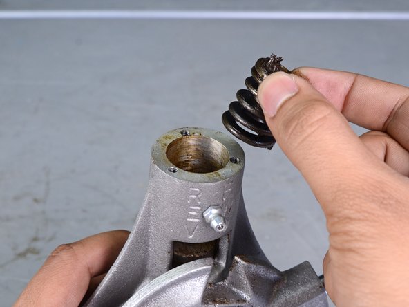

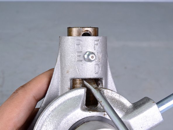

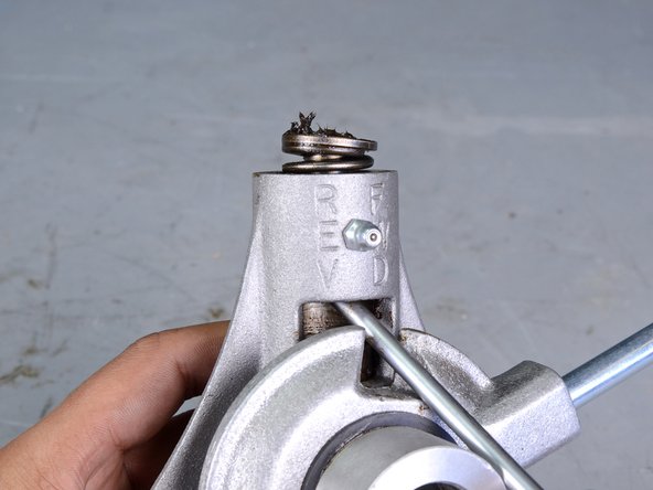

  16. Electric Eel Top Feeder Assembly Replacement, Remove the Tension Spring: crwdns2935265:016crwdnd2935265:01crwdnd2935265:02crwdne2935265:0 Electric Eel Top Feeder Assembly Replacement, Remove the Tension Spring: crwdns2935265:016crwdnd2935265:02crwdnd2935265:02crwdne2935265:0
    • Insert a flathead screwdriver or other long tool underneath the tension spring in the top feeder assembly.
    • Use the tool to push up on the spring and ball bearing carrier so you can remove them by hand.
  17. Electric Eel Top Feeder Assembly Replacement: crwdns2935265:017crwdnd2935265:01crwdnd2935265:02crwdne2935265:0 Electric Eel Top Feeder Assembly Replacement: crwdns2935265:017crwdnd2935265:02crwdnd2935265:02crwdne2935265:0

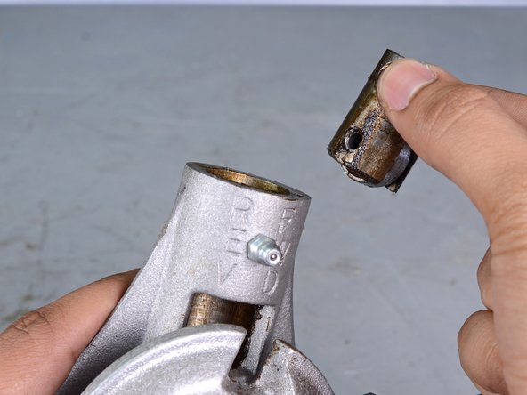

    • Remove the ball bearing carrier and tension spring.

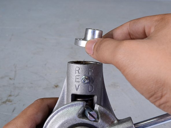

  18. Electric Eel Top Feeder Assembly Replacement, Remove the Bearing Carrier Assembly: crwdns2935265:018crwdnd2935265:01crwdnd2935265:03crwdne2935265:0 Electric Eel Top Feeder Assembly Replacement, Remove the Bearing Carrier Assembly: crwdns2935265:018crwdnd2935265:02crwdnd2935265:03crwdne2935265:0 Electric Eel Top Feeder Assembly Replacement, Remove the Bearing Carrier Assembly: crwdns2935265:018crwdnd2935265:03crwdnd2935265:03crwdne2935265:0
    • Use a flathead screwdriver or other long tool to push up on the bearing carrier so you can remove it by hand.
  19. Electric Eel Top Feeder Assembly Replacement: crwdns2935265:019crwdnd2935265:01crwdnd2935265:02crwdne2935265:0 Electric Eel Top Feeder Assembly Replacement: crwdns2935265:019crwdnd2935265:02crwdnd2935265:02crwdne2935265:0
    • Remove the top bearing carrier assembly from the feeder body.
After reassembly: Ensure the assembly you just installed is sufficiently lubricated using the Zerk fitting on the feeder body.
