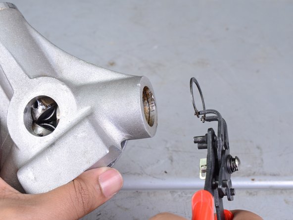

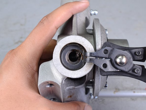

  12. Electric Eel Lower Feeder Assembly Replacement, Remove the Retaining Ring: crwdns2935265:012crwdnd2935265:01crwdnd2935265:03crwdne2935265:0 Electric Eel Lower Feeder Assembly Replacement, Remove the Retaining Ring: crwdns2935265:012crwdnd2935265:02crwdnd2935265:03crwdne2935265:0 Electric Eel Lower Feeder Assembly Replacement, Remove the Retaining Ring: crwdns2935265:012crwdnd2935265:03crwdnd2935265:03crwdne2935265:0
    • Use a pair of snap ring pliers to remove the retaining ring at the bottom of the lower feeder assembly.

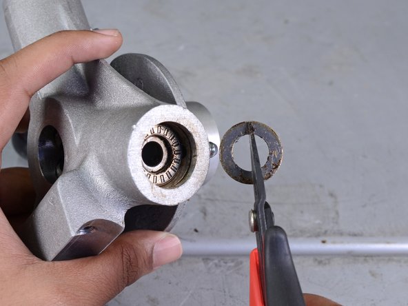

  13. Electric Eel Lower Feeder Assembly Replacement, Remove the Thrust Bearings: crwdns2935265:013crwdnd2935265:01crwdnd2935265:02crwdne2935265:0 Electric Eel Lower Feeder Assembly Replacement, Remove the Thrust Bearings: crwdns2935265:013crwdnd2935265:02crwdnd2935265:02crwdne2935265:0
    • Use a pair of needle-nose pliers to remove the first thrust washer from the assembly.

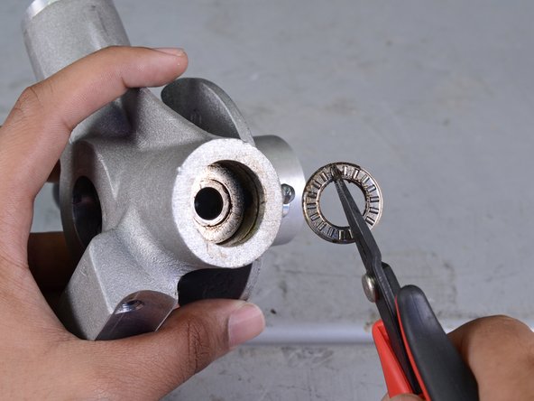

  14. Electric Eel Lower Feeder Assembly Replacement: crwdns2935265:014crwdnd2935265:01crwdnd2935265:02crwdne2935265:0 Electric Eel Lower Feeder Assembly Replacement: crwdns2935265:014crwdnd2935265:02crwdnd2935265:02crwdne2935265:0
    • Remove the thrust bearing from the assembly.

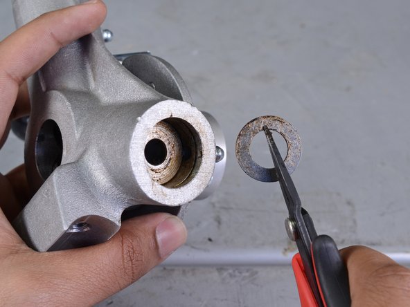

  15. Electric Eel Lower Feeder Assembly Replacement: crwdns2935265:015crwdnd2935265:01crwdnd2935265:02crwdne2935265:0 Electric Eel Lower Feeder Assembly Replacement: crwdns2935265:015crwdnd2935265:02crwdnd2935265:02crwdne2935265:0
    • Remove the second thrust washer from the assembly.

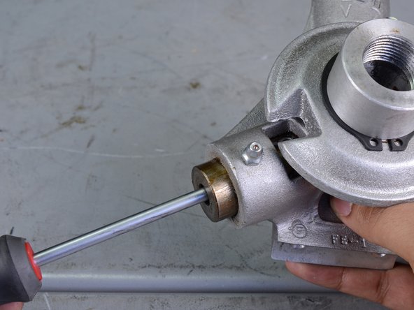

  16. Electric Eel Lower Feeder Assembly Replacement, Remove the Control Finger: crwdns2935265:016crwdnd2935265:01crwdnd2935265:01crwdne2935265:0
    • Use a flathead screwdriver to remove the lower control finger from the assembly.

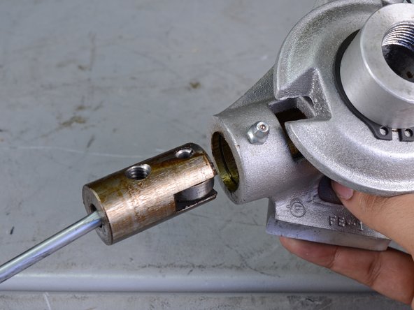

  17. Electric Eel Lower Feeder Assembly Replacement, Remove the Bearing Carrier Assembly: crwdns2935265:017crwdnd2935265:01crwdnd2935265:03crwdne2935265:0 Electric Eel Lower Feeder Assembly Replacement, Remove the Bearing Carrier Assembly: crwdns2935265:017crwdnd2935265:02crwdnd2935265:03crwdne2935265:0 Electric Eel Lower Feeder Assembly Replacement, Remove the Bearing Carrier Assembly: crwdns2935265:017crwdnd2935265:03crwdnd2935265:03crwdne2935265:0
    • Use a flathead screwdriver or other long tool as leverage to remove the lower bearing carrier from the assembly.
