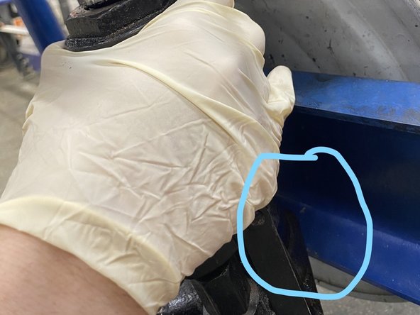

  2. Electric Eel Drain Cleaner RK34IC100 Belt Adjustment, Arranging Bottle Jack: crwdns2935265:03crwdnd2935265:01crwdnd2935265:03crwdne2935265:0 Electric Eel Drain Cleaner RK34IC100 Belt Adjustment, Arranging Bottle Jack: crwdns2935265:03crwdnd2935265:02crwdnd2935265:03crwdne2935265:0 Electric Eel Drain Cleaner RK34IC100 Belt Adjustment, Arranging Bottle Jack: crwdns2935265:03crwdnd2935265:03crwdnd2935265:03crwdne2935265:0
    • Start by placing the bottle jack ontop of the metal with the corner being on lip of the structur.
    • After its set on the lip line the middle/top of the bottle jack with the bolt of the snake motor mount

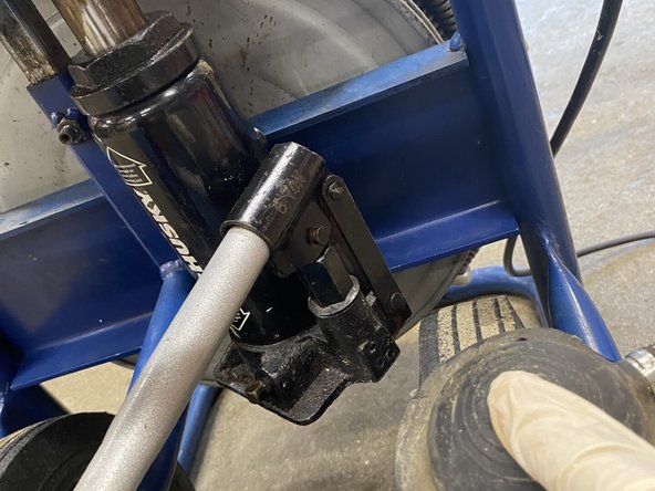

  3. Electric Eel Drain Cleaner RK34IC100 Belt Adjustment, Time to lift: crwdns2935265:04crwdnd2935265:01crwdnd2935265:01crwdne2935265:0
    • Adjust the rode of the bottle jack up till the rods head and the bolt have a nice firm and connection
    • Do Not: Over crank the rod with too much torque.

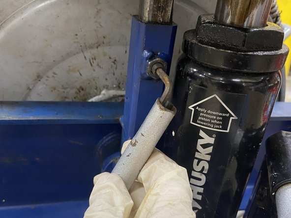

  4. Electric Eel Drain Cleaner RK34IC100 Belt Adjustment, Unscrewing the Screw Hex Point: crwdns2935265:05crwdnd2935265:01crwdnd2935265:02crwdne2935265:0 Electric Eel Drain Cleaner RK34IC100 Belt Adjustment, Unscrewing the Screw Hex Point: crwdns2935265:05crwdnd2935265:02crwdnd2935265:02crwdne2935265:0
    • Using the 5/32 Head on a alen wrench, unscrew till the head of the screw is loose.
    • Tip: Use the bar of the bottle jack as a breaker bar for more leverage.

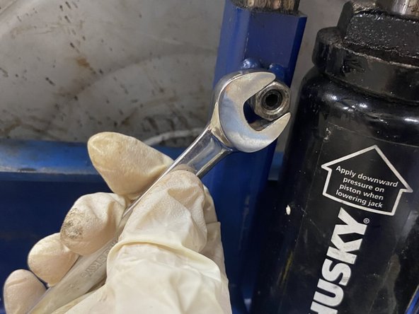

  5. Electric Eel Drain Cleaner RK34IC100 Belt Adjustment, Taking Off The Hex Nut: crwdns2935265:06crwdnd2935265:01crwdnd2935265:02crwdne2935265:0 Electric Eel Drain Cleaner RK34IC100 Belt Adjustment, Taking Off The Hex Nut: crwdns2935265:06crwdnd2935265:02crwdnd2935265:02crwdne2935265:0
    • Using a 1/2" wrench, take off the Hex nut on the Screw hex point.

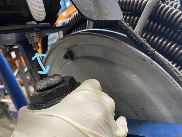

  6. Electric Eel Drain Cleaner RK34IC100 Belt Adjustment, Raising the Motor Assembly: crwdns2935265:07crwdnd2935265:01crwdnd2935265:03crwdne2935265:0 Electric Eel Drain Cleaner RK34IC100 Belt Adjustment, Raising the Motor Assembly: crwdns2935265:07crwdnd2935265:02crwdnd2935265:03crwdne2935265:0 Electric Eel Drain Cleaner RK34IC100 Belt Adjustment, Raising the Motor Assembly: crwdns2935265:07crwdnd2935265:03crwdnd2935265:03crwdne2935265:0
    • Crank the bottle jack up and feel for tention.
    • When your at the desired tention. Plug the snake into an outlet and flip the switch too ON.
    • WARNING: Be aware of the cage and wire from the snake. Failure to do so could result in injury, Please be safe when unit is on!
    • Squeez the petal too test if unit is at the desired hight and tention
    • Unit should have just enough tention not be able too stop the cage from spinning.
    • Note: Place your foot or hand against the cage with a fair amount of force. If you are able too stop the cage from spinning, the unit will need more adjustment on the belt.
    • When finished Retighten the hex screw and bolt on the shaft shown on step 5 and 6.
