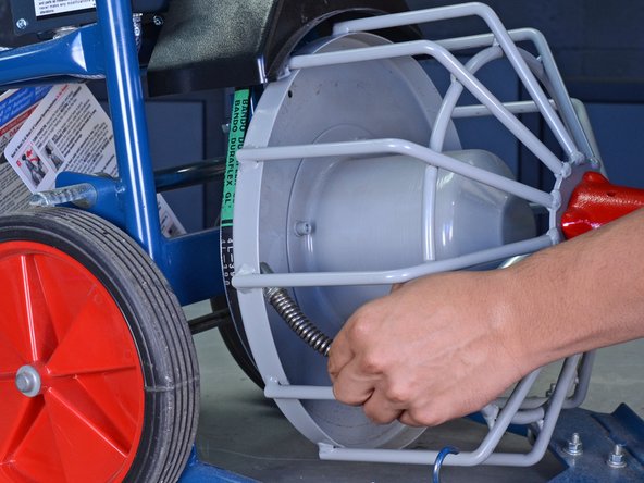

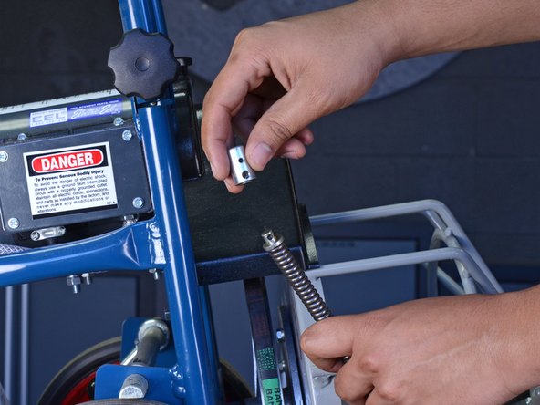

  1. Electric Eel Drain Cleaner Cable Replacement, Remove the Guide Spring: crwdns2935265:01crwdnd2935265:01crwdnd2935265:03crwdne2935265:0 Electric Eel Drain Cleaner Cable Replacement, Remove the Guide Spring: crwdns2935265:01crwdnd2935265:02crwdnd2935265:03crwdne2935265:0 Electric Eel Drain Cleaner Cable Replacement, Remove the Guide Spring: crwdns2935265:01crwdnd2935265:03crwdnd2935265:03crwdne2935265:0
    • Unplug your drain cleaner before starting this guide. Because this device may have been used in a septic setting, it should be cleaned and disinfected as much as possible before disassembly.
    • Wear gloves to protect your hands from injury when handling the cable.
    • Ensure the cable is completely retracted into the auto-feeder.
    • Twist the guide spring counter-clockwise to unscrew it from the auto-feeder.
    • Remove the guide spring.

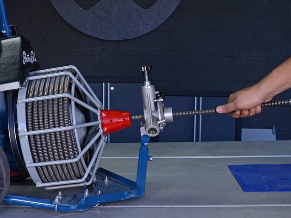

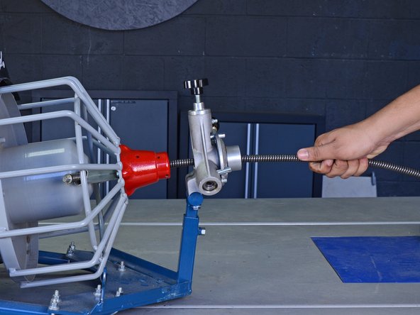

  4. Electric Eel Drain Cleaner Cable Replacement, Disengage the Top Bearing: crwdns2935265:04crwdnd2935265:01crwdnd2935265:02crwdne2935265:0 Electric Eel Drain Cleaner Cable Replacement, Disengage the Top Bearing: crwdns2935265:04crwdnd2935265:02crwdnd2935265:02crwdne2935265:0
    • Push the top control finger up as far as possible.
    • This disengages the top feeder assembly and allows the cable to freely move through the feeder. The finger may fall back down on its own and restrict cable movement. If this occurs, simply push the finger back up.
  5. Electric Eel Drain Cleaner Cable Replacement, Uncoil the Cable: crwdns2935265:05crwdnd2935265:01crwdnd2935265:02crwdne2935265:0 Electric Eel Drain Cleaner Cable Replacement, Uncoil the Cable: crwdns2935265:05crwdnd2935265:02crwdnd2935265:02crwdne2935265:0
    • Grab the end of the cable and pull to begin removing the cable from the drum.
    • If the the cable won't pass through the feeder, ensure that the top bearing is completely disengaged as described in step 4 of this guide.

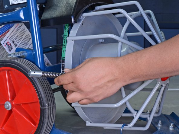

  6. Electric Eel Drain Cleaner Cable Replacement: crwdns2935265:06crwdnd2935265:01crwdnd2935265:02crwdne2935265:0 Electric Eel Drain Cleaner Cable Replacement: crwdns2935265:06crwdnd2935265:02crwdnd2935265:02crwdne2935265:0
    • Continue pulling out the cable until it reaches the end. The very end of the cable and the cable anchor will still be attached to the back side of the drum.
