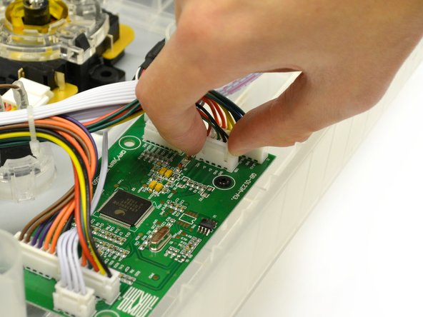

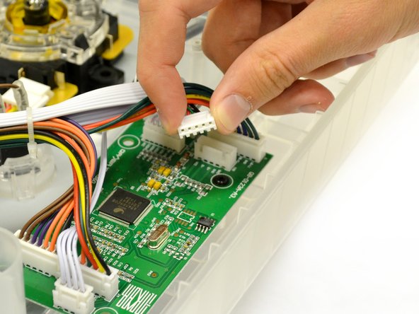

    5. Eightarc Fusion USB Cable Replacement: crwdns2935265:05crwdnd2935265:01crwdnd2935265:03crwdne2935265:0 Eightarc Fusion USB Cable Replacement: crwdns2935265:05crwdnd2935265:02crwdnd2935265:03crwdne2935265:0 Eightarc Fusion USB Cable Replacement: crwdns2935265:05crwdnd2935265:03crwdnd2935265:03crwdne2935265:0
      • The USB cord is connected to the logic board by a plastic plug with five wires.
      • Gently pull up and wiggle the white plastic end attached to the wires out of the mother board.
      • The white casing on top pulls off from its counterpart on the logic board. Do not take off the bottom part of the white fixture from the logic board.
      • Remove USB cable from device.
