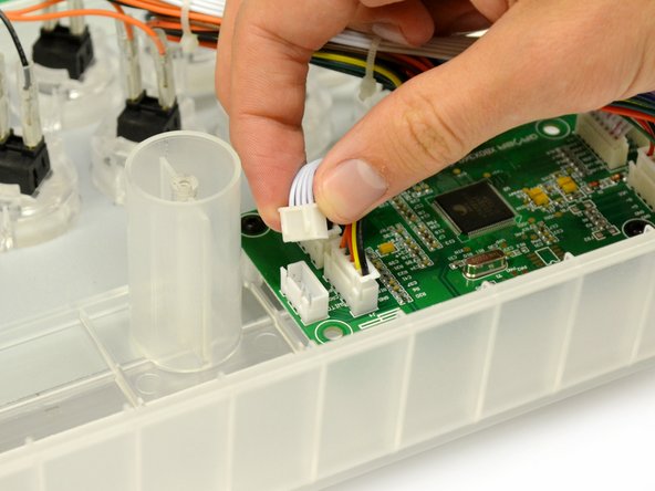

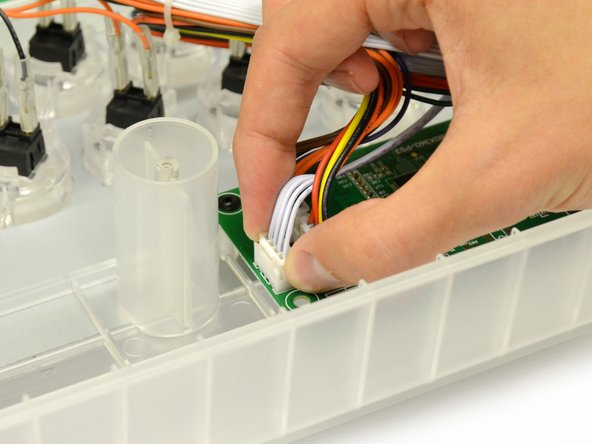

  3. Eightarc Fusion Logic Board Replacement: crwdns2935265:03crwdnd2935265:01crwdnd2935265:03crwdne2935265:0 Eightarc Fusion Logic Board Replacement: crwdns2935265:03crwdnd2935265:02crwdnd2935265:03crwdne2935265:0 Eightarc Fusion Logic Board Replacement: crwdns2935265:03crwdnd2935265:03crwdnd2935265:03crwdne2935265:0
    • Make sure not to flex the logic board when removing ribbon cables.
    • Individually remove the seven cable connectors plugged into the logic board by grasping each white plug and gently pulling upwards.
