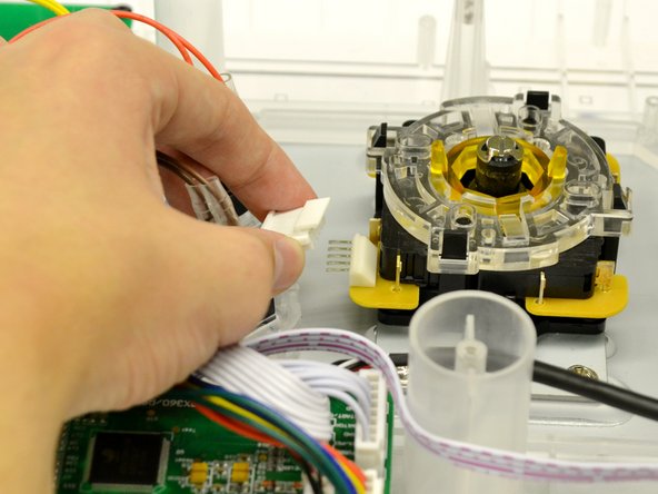

      • Use the large plastic opening tool to softly pry the lip on the white 5 pin connector to relieve pressure while pulling the 5 pin connector.
      • Remove the white connector from the microswitch assembly.

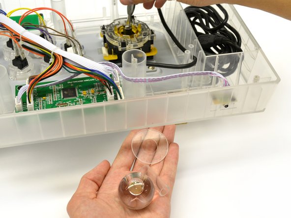

      • Insert a #4 Flat Head screwdriver into the shaft of the joystick and grasp the ball topper with your other hand.
      • Turn the flat head screwdriver counter clockwise for a quarter turn while tightly holding the ball topper.
      • The ball topper should now be loose enough to unscrew by hand.
      • Set aside the shaft cover, dust cover, and ball topper.

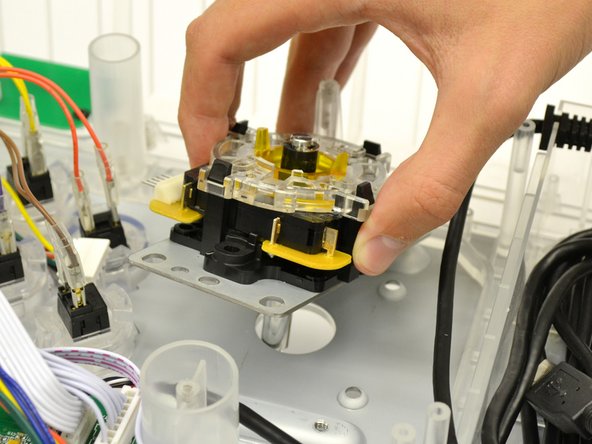

      • Remove the four 8.35 mm screws from the mounting plate of the joystick using a Phillips Head #2 screwdriver.
      • Remove the joystick assembly from the controller.

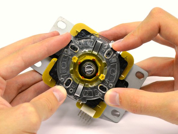

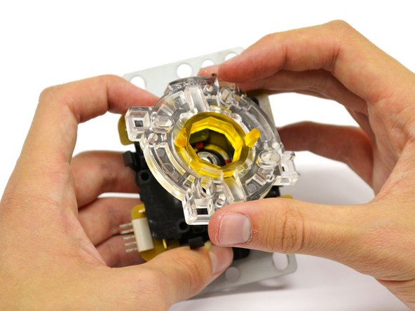

    6. Eightarc Fusion Joystick Replacement: crwdns2935265:06crwdnd2935265:01crwdnd2935265:03crwdne2935265:0 Eightarc Fusion Joystick Replacement: crwdns2935265:06crwdnd2935265:02crwdnd2935265:03crwdne2935265:0 Eightarc Fusion Joystick Replacement: crwdns2935265:06crwdnd2935265:03crwdnd2935265:03crwdne2935265:0
      • Place joystick assembly on a hard, flat surface.
      • Gently press on the four black tabs on each side of the assembly.
      • With the tabs depressed, lift the clear restrictor plate from the assembly.
    7. Eightarc Fusion Joystick Replacement: crwdns2935265:07crwdnd2935265:01crwdnd2935265:01crwdne2935265:0
      • Remove the switch housing from the assembly by lifting straight up.
      • The joystick assembly is now ready to be replaced or cleaned.
