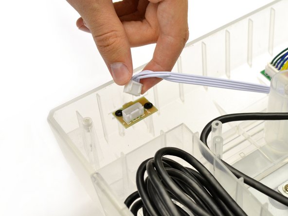

    • Grasp the white plug connecting the wires to the headphone jack, and pull gently upwards.
  4. Eightarc Fusion Headphone Jack Replacement: crwdns2935265:04crwdnd2935265:01crwdnd2935265:01crwdne2935265:0

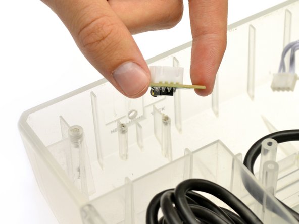

    • Using a Phillips head #1 screwdriver, remove the two washer head screws from the headphone jack.
  5. Eightarc Fusion Headphone Jack Replacement: crwdns2935265:05crwdnd2935265:01crwdnd2935265:02crwdne2935265:0 Eightarc Fusion Headphone Jack Replacement: crwdns2935265:05crwdnd2935265:02crwdnd2935265:02crwdne2935265:0
    • Gently wiggle the headphone jack left and right, pulling it towards you until it slides out of the hole in the enclosure.
