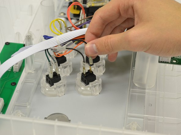

    3. Eightarc Fusion Button Replacement: crwdns2935265:03crwdnd2935265:01crwdnd2935265:01crwdne2935265:0
      • Remove the clear rubber casing around the wire connector by lifting the casing up and moving it up along the wire.
      • Repeat for second clear rubber casing.
    4. Eightarc Fusion Button Replacement: crwdns2935265:04crwdnd2935265:01crwdnd2935265:02crwdne2935265:0 Eightarc Fusion Button Replacement: crwdns2935265:04crwdnd2935265:02crwdnd2935265:02crwdne2935265:0
      • Gently grasp and lift up on the metal section of the wire to remove the wire from the button connector.
      • A slight wiggling motion might help remove the wire from the connector.
      • Make sure to keep track of which wires go to what button slot location.

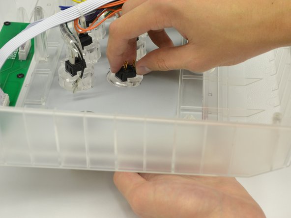

    5. Eightarc Fusion Button Replacement: crwdns2935265:05crwdnd2935265:01crwdnd2935265:02crwdne2935265:0 Eightarc Fusion Button Replacement: crwdns2935265:05crwdnd2935265:02crwdnd2935265:02crwdne2935265:0
      • Gently depress the two plastic tabs on both of the sides of the button casing.
      • The plastic tabs on the buttons are extremely fragile, handle with care.
      • Slightly push the button down, out of the controller until it slides out.
      • During re-assembly, make sure the button tabs align with the slots in the casing when inserting the button back in.
