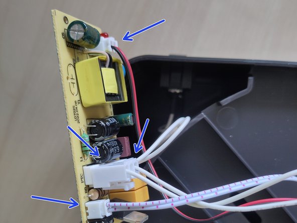

  4. Eibos Easdry heating system replacement, Disconnect the motherboard: crwdns2935265:04crwdnd2935265:01crwdnd2935265:02crwdne2935265:0 Eibos Easdry heating system replacement, Disconnect the motherboard: crwdns2935265:04crwdnd2935265:02crwdnd2935265:02crwdne2935265:0
    • Pull the motherboard out of the bottom left corner of the casing. It is not kept in place by anything.
    • Disconnect all connectors on the motherboard. In total, there are four connectors.
    • Put the old motherboard away.

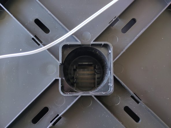

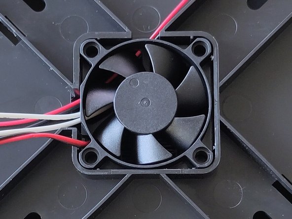

  5. Eibos Easdry heating system replacement, Remove the fan: crwdns2935265:05crwdnd2935265:01crwdnd2935265:01crwdne2935265:0
    • Put a metal spudger between the fan and the casing, and slowly wedge the fan upwards.
    • Do this for all four sides of the fan.
    • Once the fan is lifted sufficiently, grab it with your fingers and pull it out.
    • Put the old fan away.

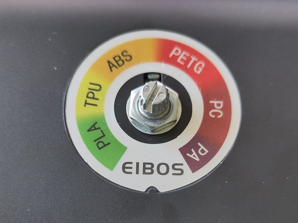

    • Pull off the black cap that's on top of the potentiometer. It has quite a snug fit, so some force is needed to pull it off.
    • No tools should be necessary here. Only your fingers should be sufficient to pull the cap off.

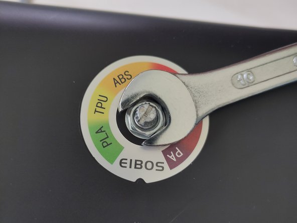

    • The potentiometer is kept in place by a screw nut. Remove this nut with a 10mm wrench.
    • Once the nut is off, pull the potentiometer out of the case.
    • Put the old potentiometer away, but keep the black cap.

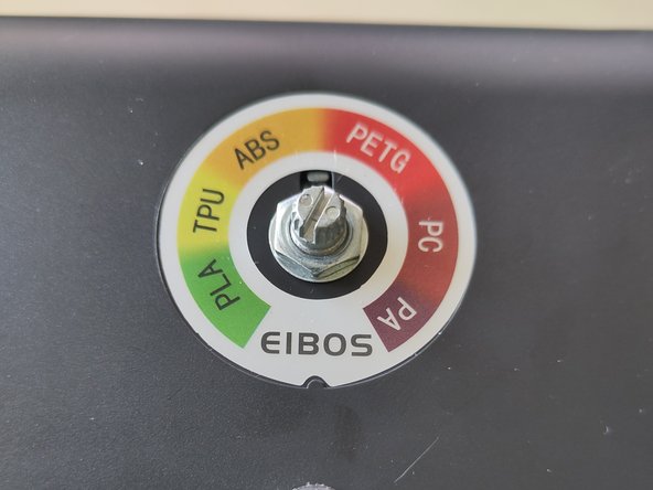

  9. Eibos Easdry heating system replacement, Insert the new potentiometer: crwdns2935265:09crwdnd2935265:01crwdnd2935265:03crwdne2935265:0 Eibos Easdry heating system replacement, Insert the new potentiometer: crwdns2935265:09crwdnd2935265:02crwdnd2935265:03crwdne2935265:0 Eibos Easdry heating system replacement, Insert the new potentiometer: crwdns2935265:09crwdnd2935265:03crwdnd2935265:03crwdne2935265:0
    • Insert the new potentiometer in the same slot as the old one came out of.
    • Note that the potentiometer has a small clip that neatly falls inside the upper part of the slot. Make sure the potentiometer is oriented so that its clip falls into this slot as well.
    • Put both the washer and the nut screw back over the potentiometer, and tighten them with the wrench.

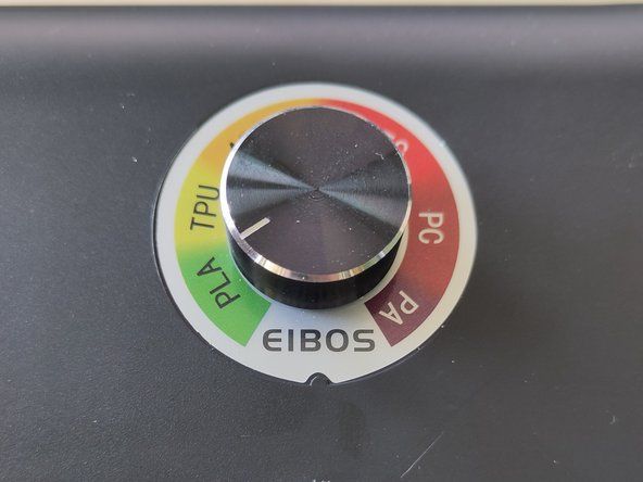

    • Grab the knob of the potentiometer with two fingers, and turn it counterclockwise until it stops.
    • Place the black cap back on top of the potentiometer, with the white indicator at the start of the green PLA section.
    • Once mounted, turn the black knob clockwise all the way, and verify that it is at the end of the dark-red PA section.

  11. Eibos Easdry heating system replacement, Insert the new fan: crwdns2935265:011crwdnd2935265:01crwdnd2935265:02crwdne2935265:0 Eibos Easdry heating system replacement, Insert the new fan: crwdns2935265:011crwdnd2935265:02crwdnd2935265:02crwdne2935265:0
    • Guide all wires along their respective little trenches, to ensure no wires get pinched when the backplate is reassembled.
    • Insert the fan in its slot, while keeping the wires that go behind the fan down.
    • Pay attention to the direction of the fan. If mounted incorrectly, the fan will be blowing air out of the box instead of into the box. The blades of the fan should be curved upwards from the center outward.
    • Guide the remaining wire of the fan along its little trench, with the rest of the wires.
