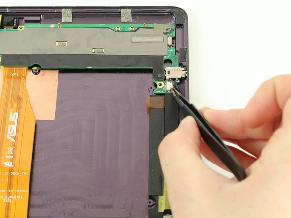

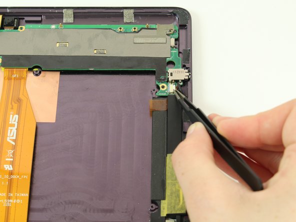

  7. Eee Pad Transformer Prime TF201 Speaker Replacement, Speaker: crwdns2935265:07crwdnd2935265:01crwdnd2935265:03crwdne2935265:0 Eee Pad Transformer Prime TF201 Speaker Replacement, Speaker: crwdns2935265:07crwdnd2935265:02crwdnd2935265:03crwdne2935265:0 Eee Pad Transformer Prime TF201 Speaker Replacement, Speaker: crwdns2935265:07crwdnd2935265:03crwdnd2935265:03crwdne2935265:0
    • Remove the wires connecting the speakers to the motherboard by pushing the small tab until the connection is broken.
    • This may take some finesse to get out, so be careful.
  8. Eee Pad Transformer Prime TF201 Speaker Replacement: crwdns2935265:08crwdnd2935265:01crwdnd2935265:02crwdne2935265:0 Eee Pad Transformer Prime TF201 Speaker Replacement: crwdns2935265:08crwdnd2935265:02crwdnd2935265:02crwdne2935265:0
    • Use the plastic opening tool to remove the speaker from the back case.
    • There may be some slight resistance due to the glue used to hold the speakers in place.
