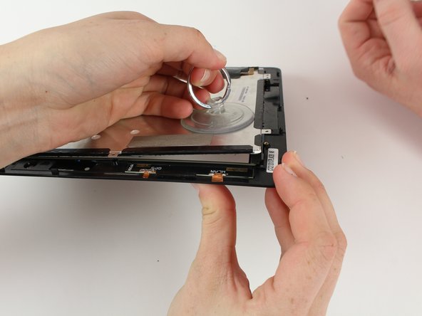

      • Power down your device.
      • Place the small suction cup on a corner of the screen and lightly pull up to expose a seam between the screen and case.
    2. Eee Pad Transformer Prime TF201 Screen Replacement: crwdns2935265:02crwdnd2935265:01crwdnd2935265:03crwdne2935265:0 Eee Pad Transformer Prime TF201 Screen Replacement: crwdns2935265:02crwdnd2935265:02crwdnd2935265:03crwdne2935265:0 Eee Pad Transformer Prime TF201 Screen Replacement: crwdns2935265:02crwdnd2935265:03crwdnd2935265:03crwdne2935265:0
      • Insert the plastic opening tool into the seam near the corner of the device.
      • Slowly slide the tool around the perimeter of the device, gradually prying up the screen.
      • It is normal to hear snaps as the spring clips holding the screen in place are released.
      • It is also normal to hear adhesive separating, as a small amount is used to help secure the screen.
    3. Eee Pad Transformer Prime TF201 Screen Replacement: crwdns2935265:03crwdnd2935265:01crwdnd2935265:03crwdne2935265:0 Eee Pad Transformer Prime TF201 Screen Replacement: crwdns2935265:03crwdnd2935265:02crwdnd2935265:03crwdne2935265:0 Eee Pad Transformer Prime TF201 Screen Replacement: crwdns2935265:03crwdnd2935265:03crwdnd2935265:03crwdne2935265:0
      • When the screen is free of all spring clips and adhesive, slowly open the device like a clam shell with the hinge being the left hand side of the device.
      • Do not completely separate the screen from the case by more than a few inches, as they are still connected by three orange ribbon cables.
      • Safely place the device back on the table by laying the screen face down.
      • There will be some slight overlapping of the back of the case over the screen.

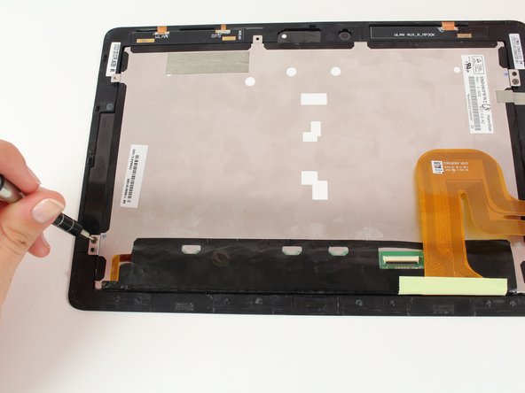

      • Remove the six FH-00 2.2mm screws using the Phillips #00 screwdriver.

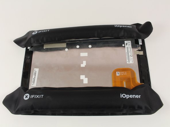

      • Start heating up the iOpeners now.
    2. Eee Pad Transformer Prime TF201 Screen Replacement: crwdns2935265:08crwdnd2935265:01crwdnd2935265:02crwdne2935265:0 Eee Pad Transformer Prime TF201 Screen Replacement: crwdns2935265:08crwdnd2935265:02crwdnd2935265:02crwdne2935265:0
      • Place the iOpeners on the edges of the tablet and let sit for 2-5 minutes
      • Remove the iOpeners and repeat on the other side of the tablet
    3. Eee Pad Transformer Prime TF201 Screen Replacement: crwdns2935265:09crwdnd2935265:01crwdnd2935265:02crwdne2935265:0 Eee Pad Transformer Prime TF201 Screen Replacement: crwdns2935265:09crwdnd2935265:02crwdnd2935265:02crwdne2935265:0
      • Slowly pry open the tablet using the plastic opening tool.
      • Place small suction cup on the screen and pull apart slowly to separate screen
      • Be careful not to jerk the screen apart, as this may cause unnecessary damage to the screen or the LCD.
To reassemble your device, apply glue to the screen and press it to the LCD, then follow these instructions in reverse order.
