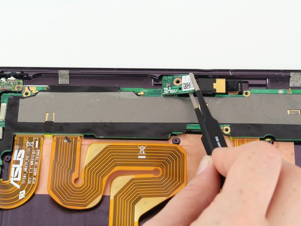

The LED Chip is responsible for the rear camera flash and flashlight functions. This is a guide to replacing the chip with a new one, if the current one in your device is malfunctioning.
NOTE: You may omit step six of this guide, removing the battery.

    1. Eee Pad Transformer Prime TF201 LED Chip Replacement, LED Chip: crwdns2935265:07crwdnd2935265:01crwdnd2935265:02crwdne2935265:0 Eee Pad Transformer Prime TF201 LED Chip Replacement, LED Chip: crwdns2935265:07crwdnd2935265:02crwdnd2935265:02crwdne2935265:0
      • With a Phillips #00 screwdriver, remove the one 3.8 mm screw in the LED chip. The LED chip is a small green chip (about 1 square centimeter) located at the top center of the device.
      • Gently remove the chip with a pair of precision tweezers by grabbing the chip from one side, being careful not to pinch on a black piece of hardware on the chip.
