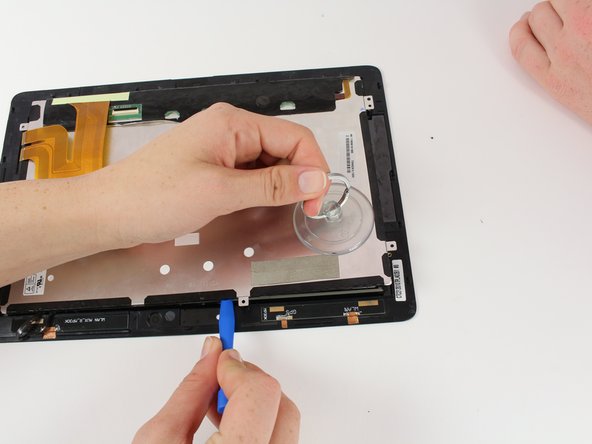

  8. Eee Pad Transformer Prime TF201 LCD Replacement: crwdns2935265:08crwdnd2935265:01crwdnd2935265:02crwdne2935265:0 Eee Pad Transformer Prime TF201 LCD Replacement: crwdns2935265:08crwdnd2935265:02crwdnd2935265:02crwdne2935265:0
    • Place the iOpeners on the edge of the screen and wait 2-5 minutes.
    • Remove the iOpeners and repeat on the other side of the screen.
  9. Eee Pad Transformer Prime TF201 LCD Replacement: crwdns2935265:09crwdnd2935265:01crwdnd2935265:03crwdne2935265:0 Eee Pad Transformer Prime TF201 LCD Replacement: crwdns2935265:09crwdnd2935265:02crwdnd2935265:03crwdne2935265:0 Eee Pad Transformer Prime TF201 LCD Replacement: crwdns2935265:09crwdnd2935265:03crwdnd2935265:03crwdne2935265:0

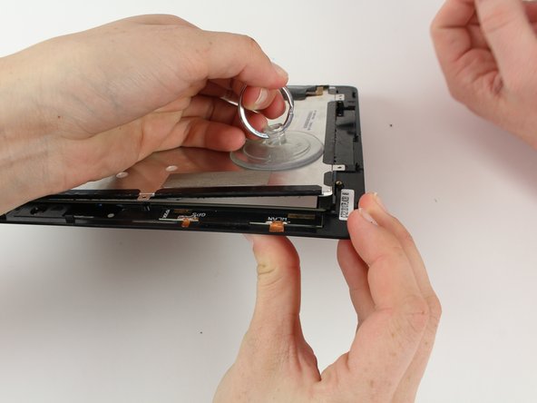

    • Slowly pry the screen open using the plastic opening tool.
    • Place the small suction cup on the screen and slowly pull the screen from the LCD.
    • Do not pull hard on the screen. If it is still too hard to pull apart, reapply the heated gel packs to loosen the glue.
To reassemble your device, apply glue to the LCD and to the screen, press together, and follow these instructions in reverse order.
