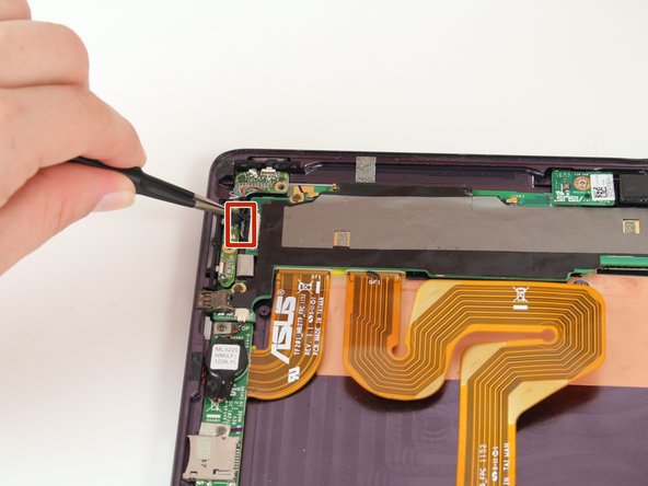

  8. Eee Pad Transformer Prime TF201 Charging Port Replacement, Charging Port: crwdns2935265:08crwdnd2935265:01crwdnd2935265:03crwdne2935265:0 Eee Pad Transformer Prime TF201 Charging Port Replacement, Charging Port: crwdns2935265:08crwdnd2935265:02crwdnd2935265:03crwdne2935265:0 Eee Pad Transformer Prime TF201 Charging Port Replacement, Charging Port: crwdns2935265:08crwdnd2935265:03crwdnd2935265:03crwdne2935265:0
    • With precision tweezers, pull back the strip of black tape covering the connection between the button key switch and the motherboard.
    • Disconnect the wires by using precision tweezers to gently pushing the black plug out of the white receptacle.
    • Avoid pulling the black plug out with the tweezers. It is easy for the tweezers to slip and sever the wires to the plug.

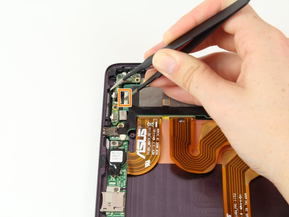

  13. Eee Pad Transformer Prime TF201 Charging Port Replacement: crwdns2935265:013crwdnd2935265:01crwdnd2935265:03crwdne2935265:0 Eee Pad Transformer Prime TF201 Charging Port Replacement: crwdns2935265:013crwdnd2935265:02crwdnd2935265:03crwdne2935265:0 Eee Pad Transformer Prime TF201 Charging Port Replacement: crwdns2935265:013crwdnd2935265:03crwdnd2935265:03crwdne2935265:0
    • With precision tweezers, peel back the yellow tape in the center of the motherboard to expose the ribbon cable to the charging port.
    • Leave the right hand side of the yellow tape attached, as you will need to recover the connection during reassembly.
    • Lift the tan tab on the back of the ribbon cable port upward 90 degrees with a narrow plastic opening tool.
    • Pull the ribbon cable out of the port, freeing it from the motherboard.

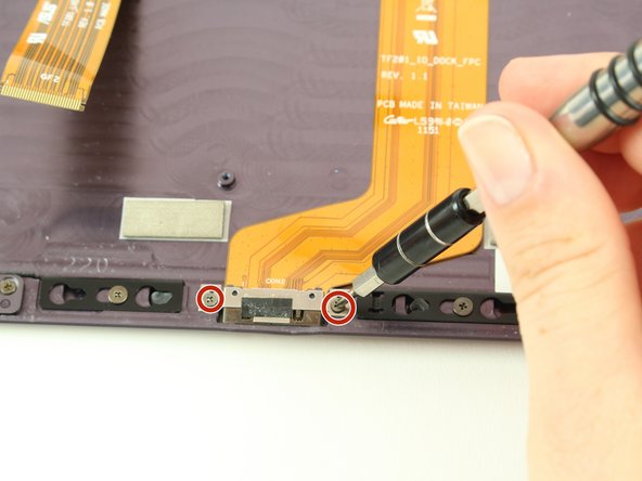

  14. Eee Pad Transformer Prime TF201 Charging Port Replacement: crwdns2935265:014crwdnd2935265:01crwdnd2935265:03crwdne2935265:0 Eee Pad Transformer Prime TF201 Charging Port Replacement: crwdns2935265:014crwdnd2935265:02crwdnd2935265:03crwdne2935265:0 Eee Pad Transformer Prime TF201 Charging Port Replacement: crwdns2935265:014crwdnd2935265:03crwdnd2935265:03crwdne2935265:0
    • With a Philips #00 screwdriver, remove the two 2.5mm screws on the charging receptacle.
    • Remove the charging receptacle and ribbon cable.
    • The ribbon cable and receptacle is considered one piece, and replacement parts are sold as one unit.
