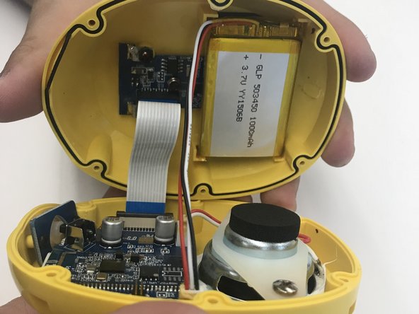

    • Use the plastic opening tool to open the inside of the duck.
    • Be very careful when splitting the two halves apart. There are wires connecting to both sides. Remember to open slowly.

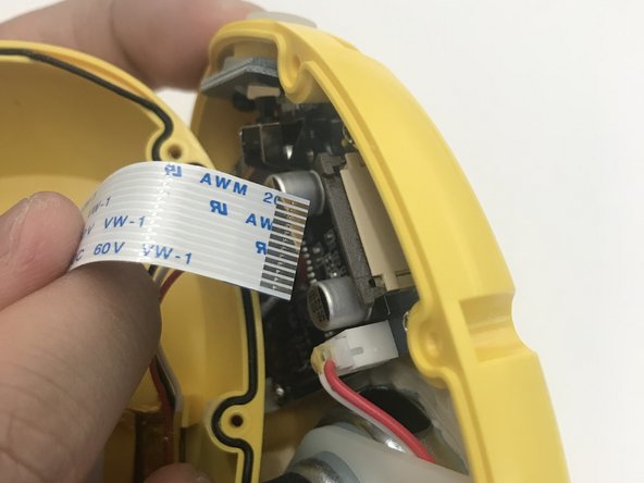

  5. Edwin the Duck Rubber Heart Power Button Replacement: crwdns2935265:05crwdnd2935265:01crwdnd2935265:02crwdne2935265:0 Edwin the Duck Rubber Heart Power Button Replacement: crwdns2935265:05crwdnd2935265:02crwdnd2935265:02crwdne2935265:0
    • Using the plastic opening tool pull up the black tab up until it stops.
    • Be careful not to pull up the black tab too far up, otherwise the cable won't be secure anymore.
    • Pull up the white cable tab up slowly

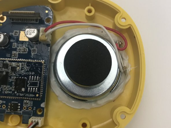

  6. Edwin the Duck Rubber Heart Power Button Replacement: crwdns2935265:06crwdnd2935265:01crwdnd2935265:02crwdne2935265:0 Edwin the Duck Rubber Heart Power Button Replacement: crwdns2935265:06crwdnd2935265:02crwdnd2935265:02crwdne2935265:0
    • Use the J1 bit to unscrew all four 9 mm screws connected to the motherboard.
    • Use the J1 bit to unscrew both 9 mm screws attached to the white plastic plate
  7. Edwin the Duck Rubber Heart Power Button Replacement: crwdns2935265:07crwdnd2935265:01crwdnd2935265:01crwdne2935265:0
    • Lift up the motherboard and speaker and place it away and to the side like you see in the picture

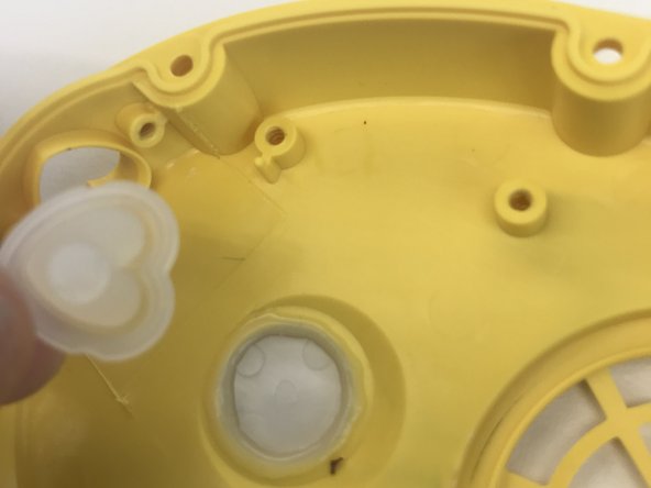

  8. Edwin the Duck Rubber Heart Power Button Replacement: crwdns2935265:08crwdnd2935265:01crwdnd2935265:02crwdne2935265:0 Edwin the Duck Rubber Heart Power Button Replacement: crwdns2935265:08crwdnd2935265:02crwdnd2935265:02crwdne2935265:0
    • Unscrew the two black 9 mm screws by using the J1 bit.
    • Remove the damaged rubber heart button and replace with a new rubber heart button.
