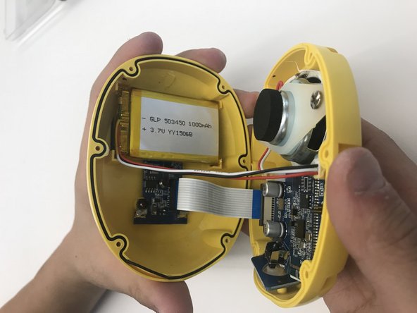

  4. Edwin the Duck Rubber Gasket Seal Replacement: crwdns2935265:04crwdnd2935265:01crwdnd2935265:02crwdne2935265:0 Edwin the Duck Rubber Gasket Seal Replacement: crwdns2935265:04crwdnd2935265:02crwdnd2935265:02crwdne2935265:0
    • Use the plastic opening tool to open the inside of the duck.
    • Be very careful when splitting the two halves apart. There are wires connecting to both sides. So open it very slowly.
  5. Edwin the Duck Rubber Gasket Seal Replacement: crwdns2935265:05crwdnd2935265:01crwdnd2935265:02crwdne2935265:0 Edwin the Duck Rubber Gasket Seal Replacement: crwdns2935265:05crwdnd2935265:02crwdnd2935265:02crwdne2935265:0

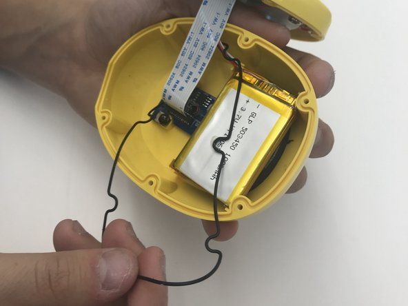

    • Remove the rubber gasket
  6. Edwin the Duck Rubber Gasket Seal Replacement: crwdns2935265:06crwdnd2935265:01crwdnd2935265:01crwdne2935265:0
    • Insert your new rubber gasket in and use the plastic opening tool to push the rubber gasket into it's slot
