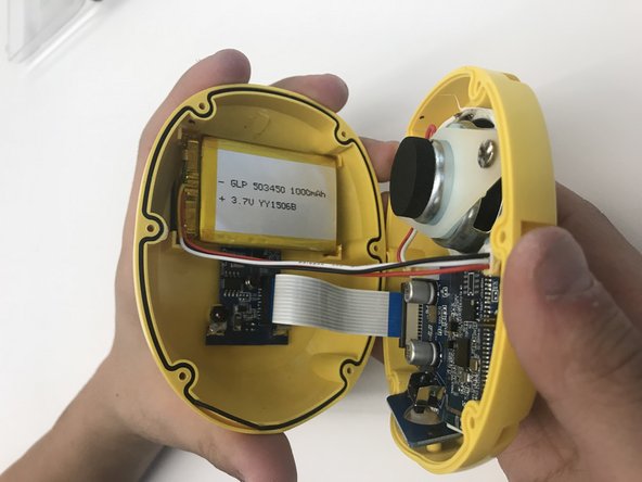

    • Use the plastic opening tool to open the inside of the duck.
    • Be very careful when splitting the two halves apart. There are wires connecting to both sides. Remember to open slowly.

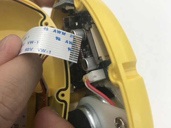

  5. Edwin the Duck Motherboard Replacement: crwdns2935265:05crwdnd2935265:01crwdnd2935265:02crwdne2935265:0 Edwin the Duck Motherboard Replacement: crwdns2935265:05crwdnd2935265:02crwdnd2935265:02crwdne2935265:0
    • Using the plastic opening tool pull up the black tab up until it stops.
    • Be careful not to pull up the black tab too far up, otherwise the cable won't be secure anymore.
    • Pull up the white cable tab, up slowly
