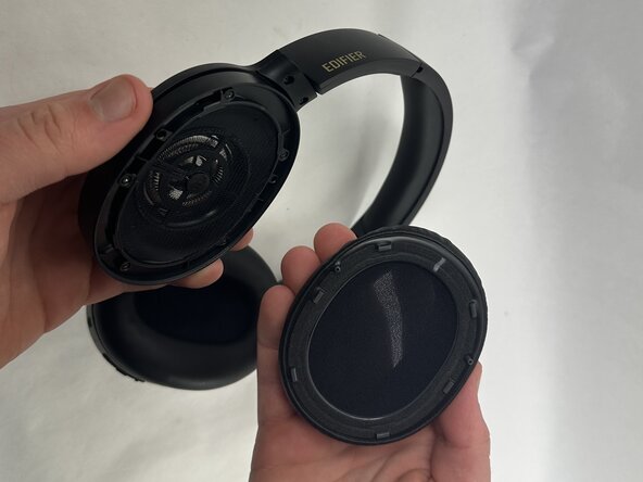

    • Start with the headphones face up and the earpads visible.
  2. Edifier W820NB Plus Ear Pads Replacement: crwdns2935265:02crwdnd2935265:01crwdnd2935265:02crwdne2935265:0 Edifier W820NB Plus Ear Pads Replacement: crwdns2935265:02crwdnd2935265:02crwdnd2935265:02crwdne2935265:0

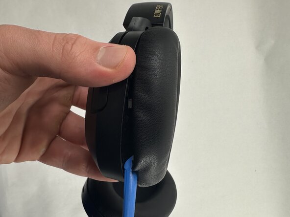

    • Hold the driver housing in one hand and insert an opening tool into the seam between the earpad and driver housing.
  3. Edifier W820NB Plus Ear Pads Replacement: crwdns2935265:03crwdnd2935265:01crwdnd2935265:02crwdne2935265:0 Edifier W820NB Plus Ear Pads Replacement: crwdns2935265:03crwdnd2935265:02crwdnd2935265:02crwdne2935265:0
    • With your inserted opening tool, pry around the perimeter of the ear pad until it fully releases.
    • Repeat this procedure for the other side if necessary.
  4. Edifier W820NB Plus Ear Pads Replacement: crwdns2935265:04crwdnd2935265:01crwdnd2935265:01crwdne2935265:0
    • Repeat for the other side if necessary.
