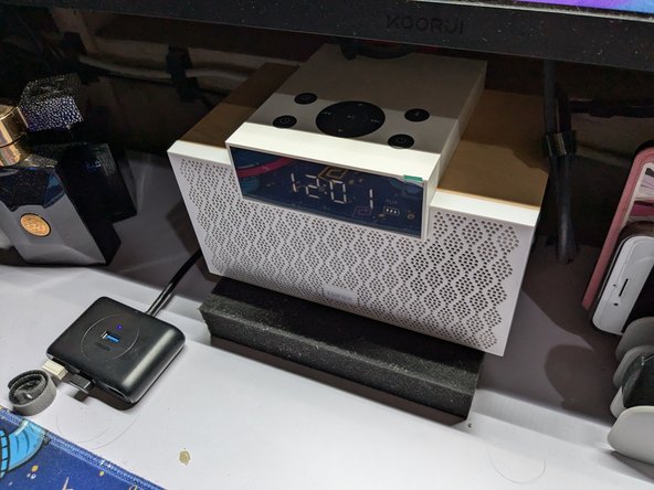

Edifier MP260 Battery Removal
    • Before starting the disassembly, make sure the speaker is powered off and disconnected from any charging source to prevent any potential electrical shock.
    • I've also did this on a completely deplected battery just to be extra sure.

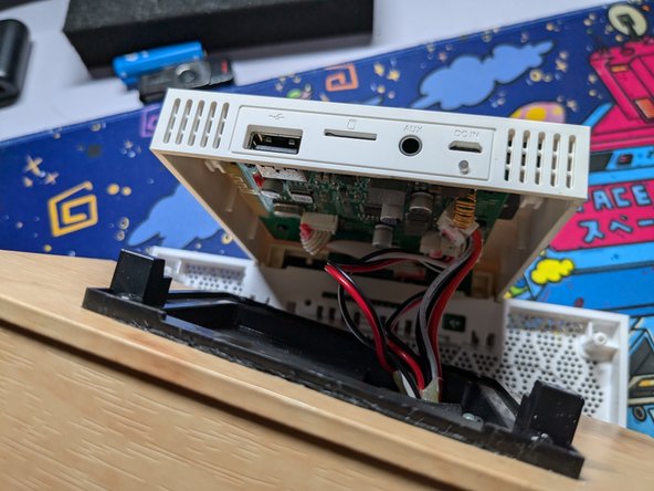

  1. Edifier MP260 Battery Removal, Pry Open the Speaker: crwdns2935265:02crwdnd2935265:01crwdnd2935265:03crwdne2935265:0 Edifier MP260 Battery Removal, Pry Open the Speaker: crwdns2935265:02crwdnd2935265:02crwdnd2935265:03crwdne2935265:0 Edifier MP260 Battery Removal, Pry Open the Speaker: crwdns2935265:02crwdnd2935265:03crwdnd2935265:03crwdne2935265:0
    • At the bottom of the speaker, carefully insert a plastic opening tool into the seam between the front panel and the main body. Gently pry the front panel open, working your way from the bottom to the top.
    • Be cautious, as the top part of the speaker contains the battery cage, which houses delicate wires. Take care not to damage them while prying the front cover. Additionally, be mindful to avoid accidentally poking the speaker itself.

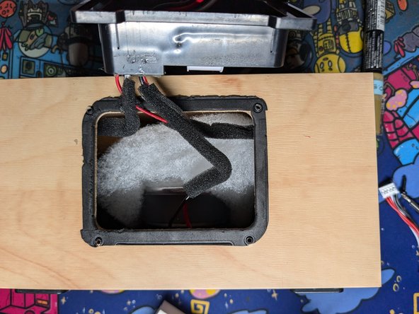

  2. Edifier MP260 Battery Removal, Remove the Screws Holding the Battery: crwdns2935265:03crwdnd2935265:01crwdnd2935265:03crwdne2935265:0 Edifier MP260 Battery Removal, Remove the Screws Holding the Battery: crwdns2935265:03crwdnd2935265:02crwdnd2935265:03crwdne2935265:0 Edifier MP260 Battery Removal, Remove the Screws Holding the Battery: crwdns2935265:03crwdnd2935265:03crwdnd2935265:03crwdne2935265:0
    • There are four screws securing the battery cage, which includes the battery, its wires, the left and right channel wires, and the main audio wire. Use a Phillips screwdriver (PH2 or larger) to remove them, and keep the screws safe for reassembly

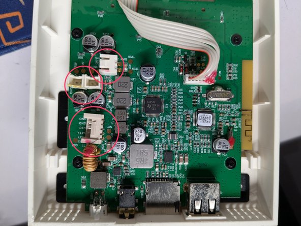

  3. Edifier MP260 Battery Removal, Disconnect the Battery and Speaker Wires: crwdns2935265:04crwdnd2935265:01crwdnd2935265:02crwdne2935265:0 Edifier MP260 Battery Removal, Disconnect the Battery and Speaker Wires: crwdns2935265:04crwdnd2935265:02crwdnd2935265:02crwdne2935265:0
    • Now, carefully disconnect the battery cable and the speaker wires from the motherboard. For each connector, gently lift the latch to disconnect it. You can use your fingers for this, but tweezers may help if you need more precision.
    • Refer to the second image, which has three marked circles: the bottom indicates the battery connector, while the middle and top circles correspond to the speaker wires.
    • Be gentle to avoid touching any delicate components, including capacitors and other electrical parts nearby, as they may hold residual power and pose a risk of electric shock.

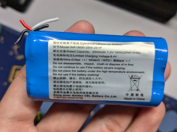

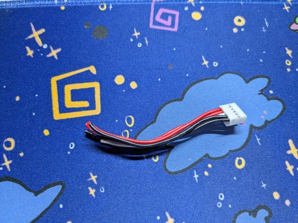

  4. Edifier MP260 Battery Removal, Remove the Old Battery: crwdns2935265:05crwdnd2935265:01crwdnd2935265:03crwdne2935265:0 Edifier MP260 Battery Removal, Remove the Old Battery: crwdns2935265:05crwdnd2935265:02crwdnd2935265:03crwdne2935265:0 Edifier MP260 Battery Removal, Remove the Old Battery: crwdns2935265:05crwdnd2935265:03crwdnd2935265:03crwdne2935265:0
    • The wires pass through a hole in the battery cage, which is also glued to hold them in place. The easiest way to remove the battery wires from the hole is to just cut them. Cut them one by one to avoid shorting the battery.
    • To remove the battery from the cage, unscrew the two screws holding it in place. Since the wires are glued, use a hairdryer to soften the adhesive and gently pull the cable out.

Thank you for this guide, the battery is dead and I have to change it.
It's disassembled (thanks to you) and now I have to find the right battery with the same amount of cables (4 apparently)

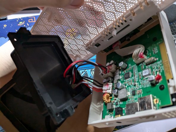

Hello, thanks for the guide. I followed it but had a problem with reassembly, here, would you happen to know how you reassembled it? Whenever I push the top part down, the front panel goes forward so I haven't been able to reassemble it like before
Gio - crwdns2934203:0crwdne2934203:0
Hello Gio,
If you check well, on top of the device, you have 2 "brackets" letf and right sides (here) to attach the top part and in front, and 7 wholes (here) to attach the front part.
To reassemble the 2 pieces, your have to :
- present to white piece a bit upfront the wholes in order to slide its top part into the 2 brackets on top of the device.
- by doing so, you will attach the top parts together and in the same time, enter the "pins" into the 7 front wholes.
- You will have to apply a bit of strengh but it should work
A bit difficult to explain but I hope it's clear.
Bo
