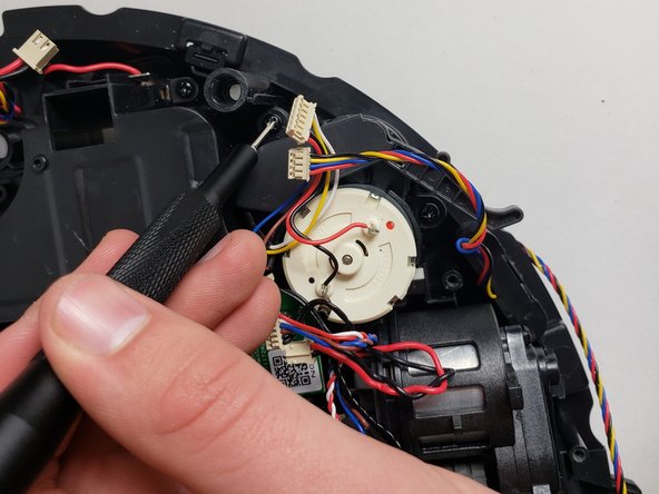

  16. Ecovacs Deebot 900 Wheel Replacement, Wheel: crwdns2935265:016crwdnd2935265:01crwdnd2935265:01crwdne2935265:0
    • Using a screwdriver or tweezers, Gently lift the spring upward, ensuring not to apply excessive force that could damage surrounding components. Once the spring is loosened, grip it securely and pull it off from one side, allowing the tension to release naturally. Take care to note the spring’s orientation and placement for reassembly later.
  17. Ecovacs Deebot 900 Wheel Replacement: crwdns2935265:017crwdnd2935265:01crwdnd2935265:02crwdne2935265:0 Ecovacs Deebot 900 Wheel Replacement: crwdns2935265:017crwdnd2935265:02crwdnd2935265:02crwdne2935265:0
    • Using a Phillips #00 screwdriver, remove the four screws securing the wheel assembly in place. Begin by loosening each screw slightly to evenly distribute pressure, then fully unscrew them one at a time. Be sure to set the screws aside in a safe location for reassembly later. Gently lift the wheel assembly out of its housing.
  18. Ecovacs Deebot 900 Wheel Replacement: crwdns2935265:018crwdnd2935265:01crwdnd2935265:01crwdne2935265:0
    • Gently pry off the wheel cover using your fingers or a plastic tool, applying light pressure to release it. Set the cover aside for reassembly.
  19. Ecovacs Deebot 900 Wheel Replacement: crwdns2935265:019crwdnd2935265:01crwdnd2935265:03crwdne2935265:0 Ecovacs Deebot 900 Wheel Replacement: crwdns2935265:019crwdnd2935265:02crwdnd2935265:03crwdne2935265:0 Ecovacs Deebot 900 Wheel Replacement: crwdns2935265:019crwdnd2935265:03crwdnd2935265:03crwdne2935265:0
    • Using the Phillips #00 screwdriver, remove the three screws holding the side brush motor in place and lift the brush motor up.
  20. Ecovacs Deebot 900 Wheel Replacement: crwdns2935265:020crwdnd2935265:01crwdnd2935265:02crwdne2935265:0 Ecovacs Deebot 900 Wheel Replacement: crwdns2935265:020crwdnd2935265:02crwdnd2935265:02crwdne2935265:0
    • Lift the wheel assembly carefully, ensuring the attached sensor (black cable) comes out with it. Handle the sensor gently to avoid damage
