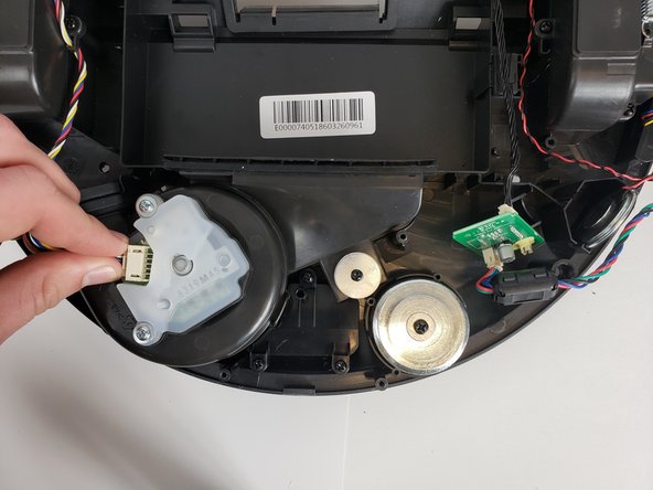

  12. Ecovacs Deebot 900 Vacuum Motor Replacement, Vacuum Motor: crwdns2935265:012crwdnd2935265:01crwdnd2935265:01crwdne2935265:0
    • Using the Phillips #00 screwdriver, remove the three screws around the laser unit.
  13. Ecovacs Deebot 900 Vacuum Motor Replacement: crwdns2935265:013crwdnd2935265:01crwdnd2935265:02crwdne2935265:0 Ecovacs Deebot 900 Vacuum Motor Replacement: crwdns2935265:013crwdnd2935265:02crwdnd2935265:02crwdne2935265:0
    • Carefully lift the laser unit off of the motor assembly​.

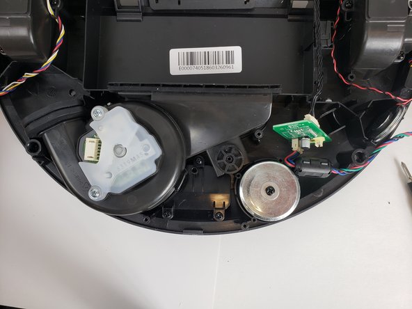

  14. Ecovacs Deebot 900 Vacuum Motor Replacement: crwdns2935265:014crwdnd2935265:01crwdnd2935265:01crwdne2935265:0
    • Remove the single screw holding the motor assembly in place using the Phillips #00 screwdriver.
  15. Ecovacs Deebot 900 Vacuum Motor Replacement: crwdns2935265:015crwdnd2935265:01crwdnd2935265:02crwdne2935265:0 Ecovacs Deebot 900 Vacuum Motor Replacement: crwdns2935265:015crwdnd2935265:02crwdnd2935265:02crwdne2935265:0
    • Disconnect the ribbon cable holding the assembly in place.
    • Be careful not to damage the cable.
  16. Ecovacs Deebot 900 Vacuum Motor Replacement: crwdns2935265:016crwdnd2935265:01crwdnd2935265:01crwdne2935265:0
    • Lift and remove the motor assembly out of the Deebot.​
