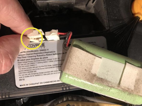

    • Here is the DEEBOT DN622.11 also know as a N79S.
    • Turn it over to have the underside exposed
    • Locate the two Phillips head screws that hold the battery cover in place
  2. Ecovacs DEEBOT DN622.11 Battery Replacement: crwdns2935265:02crwdnd2935265:01crwdnd2935265:03crwdne2935265:0 Ecovacs DEEBOT DN622.11 Battery Replacement: crwdns2935265:02crwdnd2935265:02crwdnd2935265:03crwdne2935265:0 Ecovacs DEEBOT DN622.11 Battery Replacement: crwdns2935265:02crwdnd2935265:03crwdnd2935265:03crwdne2935265:0
    • Unscrews the two Phillips head screws
    • Remove the battery cover
    • Note position of the battery in the battery compartment
  3. Ecovacs DEEBOT DN622.11 Battery Replacement: crwdns2935265:03crwdnd2935265:01crwdnd2935265:02crwdne2935265:0 Ecovacs DEEBOT DN622.11 Battery Replacement: crwdns2935265:03crwdnd2935265:02crwdnd2935265:02crwdne2935265:0
    • Lift the battery out of the compartment
    • Disconnect the battery connector by squeezing the tab on the female end of the connector. The battery can now be replaced.
To reassemble your Deebot, follow these instructions in reverse order.
