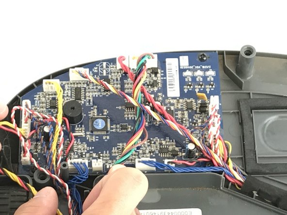

  5. Ecovacs DEEBOT D35 Motherboard Replacement: crwdns2935265:05crwdnd2935265:01crwdnd2935265:02crwdne2935265:0 Ecovacs DEEBOT D35 Motherboard Replacement: crwdns2935265:05crwdnd2935265:02crwdnd2935265:02crwdne2935265:0
    • There are 5 cables that need to be carefully disconnected before completely disconnecting the back cover:
    • The 5 cables two blue cables on the front left and right side (located next to the sensor). Represented by the red arrows.
    • Multicolor ribbon in the front center. Represented by the blue arrow.
    • Two (black and red) two prong adapter connected to the motherboard. Represented by the green arrow.

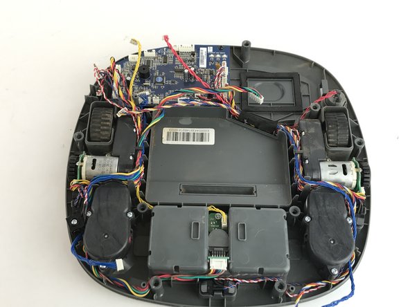

  6. Ecovacs DEEBOT D35 Motherboard Replacement: crwdns2935265:06crwdnd2935265:01crwdnd2935265:03crwdne2935265:0 Ecovacs DEEBOT D35 Motherboard Replacement: crwdns2935265:06crwdnd2935265:02crwdnd2935265:03crwdne2935265:0 Ecovacs DEEBOT D35 Motherboard Replacement: crwdns2935265:06crwdnd2935265:03crwdnd2935265:03crwdne2935265:0
    • Locate the 3 screws on the motherboard:
    • 2 x 14mm screws
    • 1 x 10mm screws

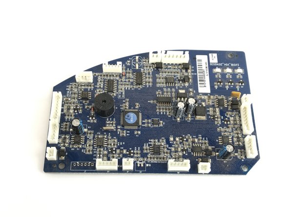

  8. Ecovacs DEEBOT D35 Motherboard Replacement: crwdns2935265:08crwdnd2935265:01crwdnd2935265:02crwdne2935265:0 Ecovacs DEEBOT D35 Motherboard Replacement: crwdns2935265:08crwdnd2935265:02crwdnd2935265:02crwdne2935265:0
    • Locate and disconnect 12 cables bundles connected on the motherboard
  9. Ecovacs DEEBOT D35 Motherboard Replacement: crwdns2935265:09crwdnd2935265:01crwdnd2935265:01crwdne2935265:0
    • Carefully disconnect the motherboard from the Deebot body.
