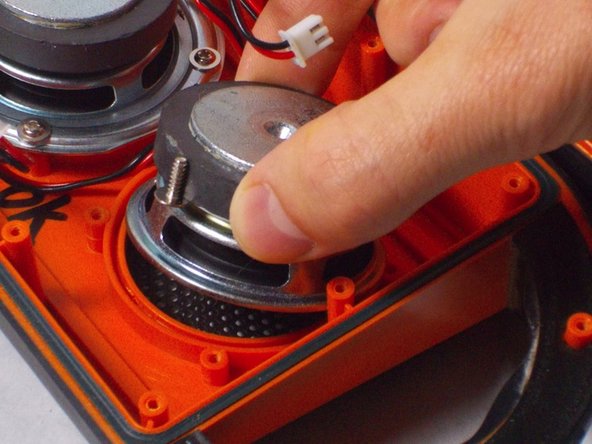

  5. Eco X Gear Voice Coil Replacement, Voice Coil: crwdns2935265:05crwdnd2935265:01crwdnd2935265:01crwdne2935265:0
    • Disconnect the wiring to improve accessibility to the cones.
  6. Eco X Gear Voice Coil Replacement: crwdns2935265:06crwdnd2935265:01crwdnd2935265:02crwdne2935265:0 Eco X Gear Voice Coil Replacement: crwdns2935265:06crwdnd2935265:02crwdnd2935265:02crwdne2935265:0
    • Remove the four screws that hold down the speaker and pry up the speaker from the frame.
  7. Eco X Gear Voice Coil Replacement: crwdns2935265:07crwdnd2935265:01crwdnd2935265:01crwdne2935265:0
    • Once the voice coil is removed, solder it back onto the bracket or replace the voice coil entirely.
