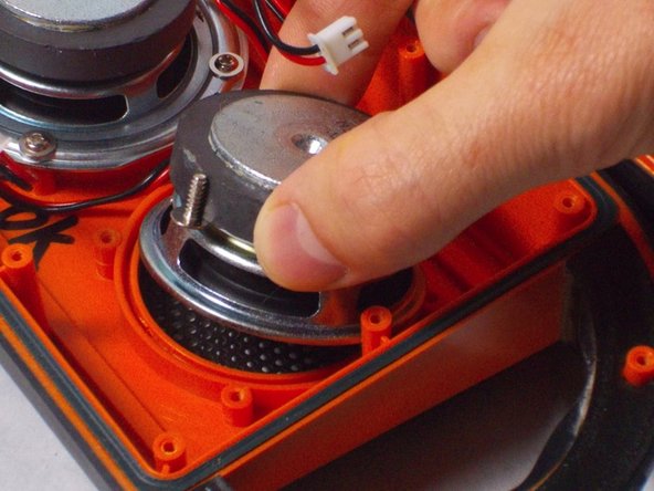

  6. Eco X Gear Cone Replacement: crwdns2935265:06crwdnd2935265:01crwdnd2935265:02crwdne2935265:0 Eco X Gear Cone Replacement: crwdns2935265:06crwdnd2935265:02crwdnd2935265:02crwdne2935265:0
    • Remove the four screws which hold down the speaker. Then, pry up the speaker from the frame.
  7. Eco X Gear Cone Replacement: crwdns2935265:07crwdnd2935265:01crwdnd2935265:01crwdne2935265:0
    • To replace the cone, remove the existing one by peeling it off of the speaker with needle nose pliers.
