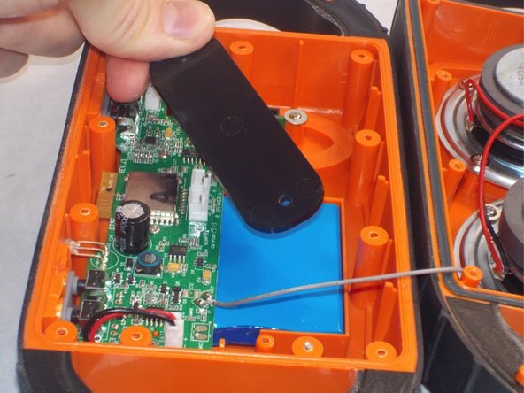

  5. Eco X Gear Battery Replacement, Battery: crwdns2935265:05crwdnd2935265:01crwdnd2935265:01crwdne2935265:0
    • Disconnect the wiring to improve accessibility to the battery.
  6. Eco X Gear Battery Replacement: crwdns2935265:06crwdnd2935265:01crwdnd2935265:02crwdne2935265:0 Eco X Gear Battery Replacement: crwdns2935265:06crwdnd2935265:02crwdnd2935265:02crwdne2935265:0
    • Remove the two screws that hold that bracket, securing the battery in place.
  7. Eco X Gear Battery Replacement: crwdns2935265:07crwdnd2935265:01crwdnd2935265:01crwdne2935265:0
    • Disconnect the wires that hold the batteries down to the motherboard.
  8. Eco X Gear Battery Replacement: crwdns2935265:08crwdnd2935265:01crwdnd2935265:01crwdne2935265:0
    • Pry the battery from the frame using your hands or an opening pick.
  9. Eco X Gear Battery Replacement: crwdns2935265:09crwdnd2935265:01crwdnd2935265:01crwdne2935265:0
    • When removing and installing the battery, be cautious to not damage any of the surrounding electronics.
