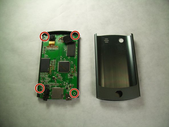

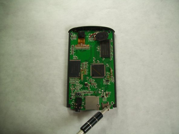

  3. Eclipse MTE28VGM  Motherboard Replacement: crwdns2935265:03crwdnd2935265:01crwdnd2935265:03crwdne2935265:0 Eclipse MTE28VGM  Motherboard Replacement: crwdns2935265:03crwdnd2935265:02crwdnd2935265:03crwdne2935265:0 Eclipse MTE28VGM  Motherboard Replacement: crwdns2935265:03crwdnd2935265:03crwdnd2935265:03crwdne2935265:0
    • Using the screwdriver, remove the four 4.8 mm Phillips head J00 screws at each corner of the motherboard.
    • Remove the motherboard from the front plastic cover and screen. Replace the old motherboard with the new motherboard.
