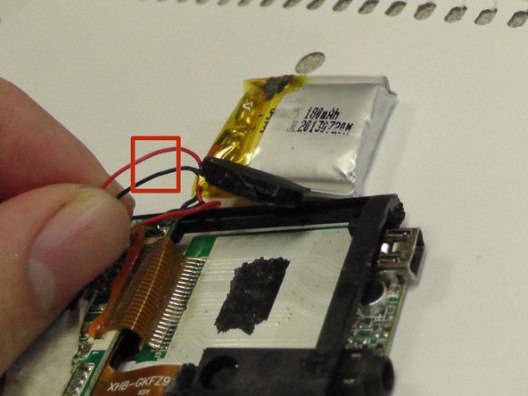

  3. Eclipse 180G2 MP3 Video Player speaker Replacement, Internal Speaker: crwdns2935265:03crwdnd2935265:01crwdnd2935265:02crwdne2935265:0 Eclipse 180G2 MP3 Video Player speaker Replacement, Internal Speaker: crwdns2935265:03crwdnd2935265:02crwdnd2935265:02crwdne2935265:0
    • Identify the speaker. Pull the speaker away from the device so that wires are exposed.
    • Using a wire cutter, sever the red and black cables that are connecting the speaker to the circuit board.
    • You will need to solder the new speaker wires to connect it to the device.
  • To reassemble your device after completion of replacement, follow these instructions in reverse order.
