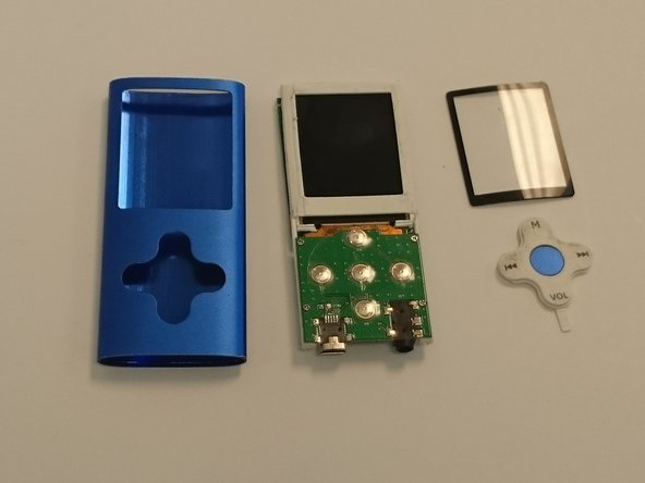

      • Remove the two screws located on the bottom of the device with a phillips head screw driver.
      • The two screws can be removed using the PH00 head from the iFixit repair toolkit.
      • Both screws are 1/8 inch in length.
      • The bottom cap will come off to reveal the inside main component.
    2. Eclipse 180BL Battery Replacement: crwdns2935265:02crwdnd2935265:01crwdnd2935265:02crwdne2935265:0 Eclipse 180BL Battery Replacement: crwdns2935265:02crwdnd2935265:02crwdnd2935265:02crwdne2935265:0
      • Remove the main inner component using Spudger, by pushing on the USB port. This will take some force.
      • Hold on the sides with your fingers, and push to release from the top.
    3. Eclipse 180BL Battery Replacement: crwdns2935265:03crwdnd2935265:01crwdnd2935265:03crwdne2935265:0 Eclipse 180BL Battery Replacement: crwdns2935265:03crwdnd2935265:02crwdnd2935265:03crwdne2935265:0 Eclipse 180BL Battery Replacement: crwdns2935265:03crwdnd2935265:03crwdnd2935265:03crwdne2935265:0
      • The plastic LCD cover and the key pad will now be loose; they were held in place by the tension between the case and the internal main component.

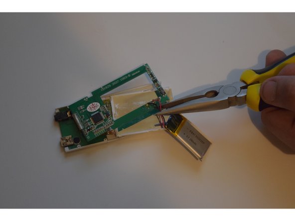

      • Locate the large square pack with a black and red wire coming out of it, this is the battery.
      • Cut the red and black wires to remove the old battery.
    4. Eclipse 180BL Battery Replacement: crwdns2935265:04crwdnd2935265:01crwdnd2935265:01crwdne2935265:0
      • To Replace, connect the two new lines ( red and black) between the new battery and the device.
      • You have successfully replaced the battery!
