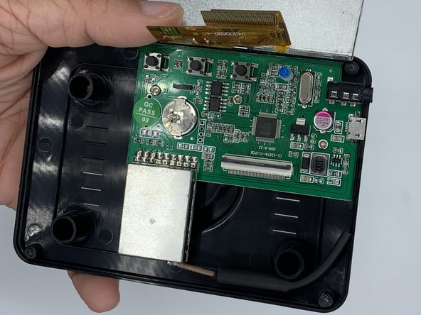

  3. EchoMaster MRC-WLP43 Motherboard Replacement: crwdns2935265:03crwdnd2935265:01crwdnd2935265:01crwdne2935265:0
    • There are three screws on the motherboard. Unscrew each one of the three 1.4 mm Phillips #1 screws.
    • Don't lose your screws!
  4. EchoMaster MRC-WLP43 Motherboard Replacement: crwdns2935265:04crwdnd2935265:01crwdnd2935265:02crwdne2935265:0 EchoMaster MRC-WLP43 Motherboard Replacement: crwdns2935265:04crwdnd2935265:02crwdnd2935265:02crwdne2935265:0
    • Once the screws are out, you can then remove the yellow strip connecting the screen to the motherboard.
    • There is a black tab that you can carefully flip up with your fingernail or a flathead screwdriver. Once it's flipped up you can easily slide the yellow ribbon out.
  5. EchoMaster MRC-WLP43 Motherboard Replacement: crwdns2935265:05crwdnd2935265:01crwdnd2935265:01crwdne2935265:0
    • When everything is unscrewed and removed you can take your motherboard out of the back cover and replace it by retracing these steps.
