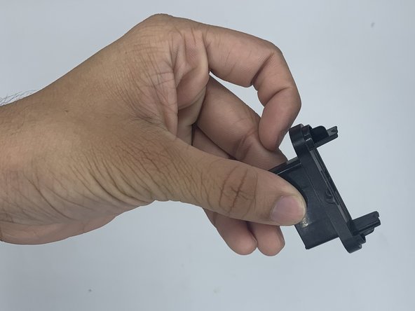

  3. EchoMaster MRC-WLP43 Camera Replacement: crwdns2935265:03crwdnd2935265:01crwdnd2935265:02crwdne2935265:0 EchoMaster MRC-WLP43 Camera Replacement: crwdns2935265:03crwdnd2935265:02crwdnd2935265:02crwdne2935265:0
    • When the screws are out, pop the two tabs off the sides.
    • Then you can pull off the back panel. You will then be left with the camera and wires. To install the new camera simply retrace these steps.
