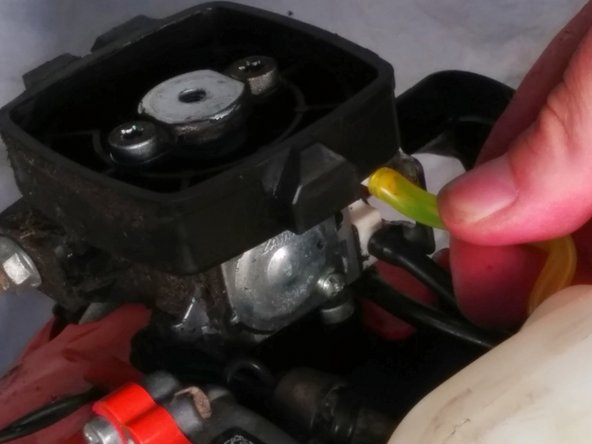

  2. Echo SRM-225 Trimmer Fuel Lines Replacement, Disconnect and remove fuel lines: crwdns2935265:02crwdnd2935265:01crwdnd2935265:03crwdne2935265:0 Echo SRM-225 Trimmer Fuel Lines Replacement, Disconnect and remove fuel lines: crwdns2935265:02crwdnd2935265:02crwdnd2935265:03crwdne2935265:0 Echo SRM-225 Trimmer Fuel Lines Replacement, Disconnect and remove fuel lines: crwdns2935265:02crwdnd2935265:03crwdnd2935265:03crwdne2935265:0
    • Disconnect fuel lines from carburetor by pulling firmly. Lines may be gently pried off of carburetor if stuck.
    • After lines are disconnected, pry grommet from the gas tank. This can be done with a flat head screwdriver as shown or a pair of pliers.

  4. Echo SRM-225 Trimmer Fuel Lines Replacement, Reattaching fuel lines: crwdns2935265:04crwdnd2935265:01crwdnd2935265:03crwdne2935265:0 Echo SRM-225 Trimmer Fuel Lines Replacement, Reattaching fuel lines: crwdns2935265:04crwdnd2935265:02crwdnd2935265:03crwdne2935265:0 Echo SRM-225 Trimmer Fuel Lines Replacement, Reattaching fuel lines: crwdns2935265:04crwdnd2935265:03crwdnd2935265:03crwdne2935265:0
    • Attach the black line firmly to the hose attachment towards the inside.
    • Attach the yellow line firmly to the outer hose attachment.
    • The black hose with the white attachment slides right into the area circled in the picture. As this is just a vent cap, it is not imperative that it be placed in this spot if you are not able to. Just be sure that the vent hose is not kinked.

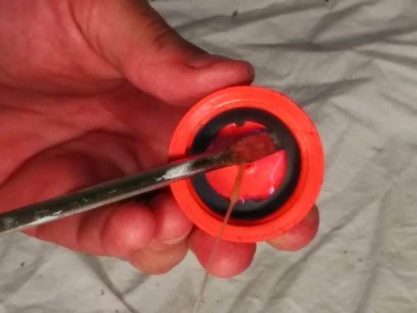

  6. Echo SRM-225 Trimmer Fuel Lines Replacement, Replacing vent cap gasket: crwdns2935265:06crwdnd2935265:01crwdnd2935265:02crwdne2935265:0 Echo SRM-225 Trimmer Fuel Lines Replacement, Replacing vent cap gasket: crwdns2935265:06crwdnd2935265:02crwdnd2935265:02crwdne2935265:0
    • Unscrew and remove gas cap. The plastic piece bends that keeps it attached and will pull out of tank.
    • Pry old gasket out with screw driver or needle nose pliers.
    • Replace with new gasket using fingers to position it.
To reassemble your device, follow these instructions in reverse order. Be sure all re-used gaskets are in good shape and reinstalled in the same manner as they were removed.
