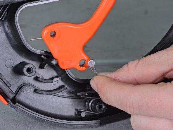

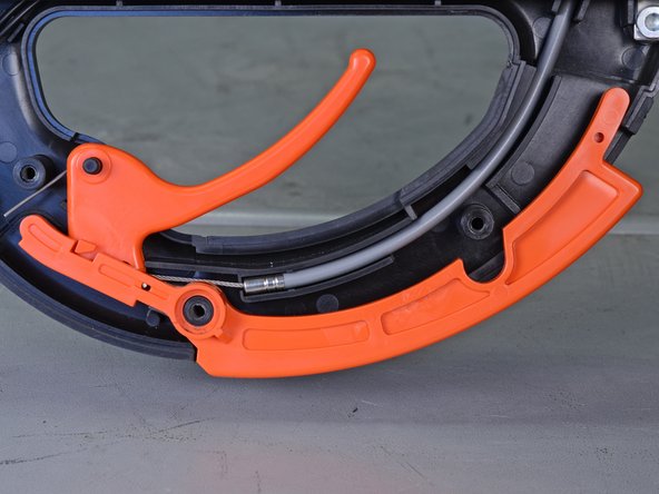

  6. Echo Power Pruner 254 cc PPT2620 2019 Throttle Trigger Replacement: crwdns2935265:06crwdnd2935265:01crwdnd2935265:02crwdne2935265:0 Echo Power Pruner 254 cc PPT2620 2019 Throttle Trigger Replacement: crwdns2935265:06crwdnd2935265:02crwdnd2935265:02crwdne2935265:0
    • Lift the throttle lockout out of the control handle.
    • During reassembly, make sure the throttle lockout and the throttle trigger are oriented correctly, and that the small wire spring is inserted in the hole on the throttle lockout, as shown in the second photo.

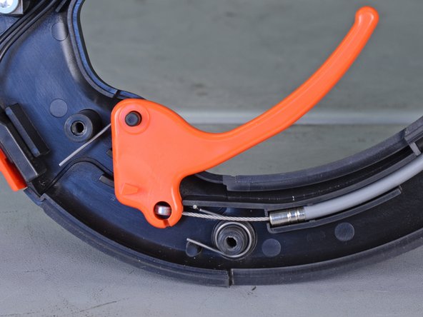

  7. Echo Power Pruner 254 cc PPT2620 2019 Throttle Trigger Replacement: crwdns2935265:07crwdnd2935265:01crwdnd2935265:03crwdne2935265:0 Echo Power Pruner 254 cc PPT2620 2019 Throttle Trigger Replacement: crwdns2935265:07crwdnd2935265:02crwdnd2935265:03crwdne2935265:0 Echo Power Pruner 254 cc PPT2620 2019 Throttle Trigger Replacement: crwdns2935265:07crwdnd2935265:03crwdnd2935265:03crwdne2935265:0
    • Lift the throttle trigger out of the control handle.
    • During reassembly, make sure that the spring inside the trigger is positioned so that it loops around the trigger's hinge post and rests against the screw post to the left of the trigger.

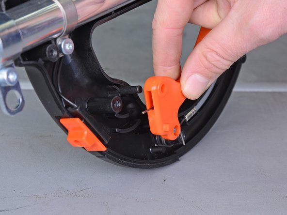

  8. Echo Power Pruner 254 cc PPT2620 2019 Throttle Trigger Replacement: crwdns2935265:08crwdnd2935265:01crwdnd2935265:02crwdne2935265:0 Echo Power Pruner 254 cc PPT2620 2019 Throttle Trigger Replacement: crwdns2935265:08crwdnd2935265:02crwdnd2935265:02crwdne2935265:0
    • Pull the throttle cable sideways through the slot in the throttle trigger to remove it from the trigger.

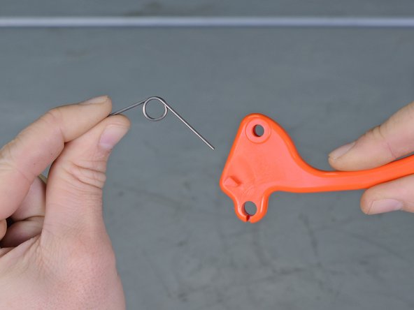

  9. Echo Power Pruner 254 cc PPT2620 2019 Throttle Trigger Replacement, Remove the trigger spring: crwdns2935265:09crwdnd2935265:01crwdnd2935265:02crwdne2935265:0 Echo Power Pruner 254 cc PPT2620 2019 Throttle Trigger Replacement, Remove the trigger spring: crwdns2935265:09crwdnd2935265:02crwdnd2935265:02crwdne2935265:0
    • Remove the spring from the throttle trigger.
    • Make sure to install the spring in your new trigger if it does not come with one.
