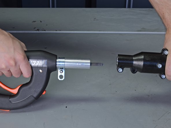

  6. Echo Power Pruner 254 cc PPT2620 2019 Flexible Tube Replacement, Remove the control handle: crwdns2935265:06crwdnd2935265:01crwdnd2935265:01crwdne2935265:0
    • Use a T25 Torx screwdriver to loosen (but don't remove) the screw clamping the strap hook to the handle pipe.
    • You may need an 8 mm socket and socket wrench to hold the nut on the back of the strap hook while you loosen the bolt.
    • Remove the two T25 screws securing the handle to the handle pipe.

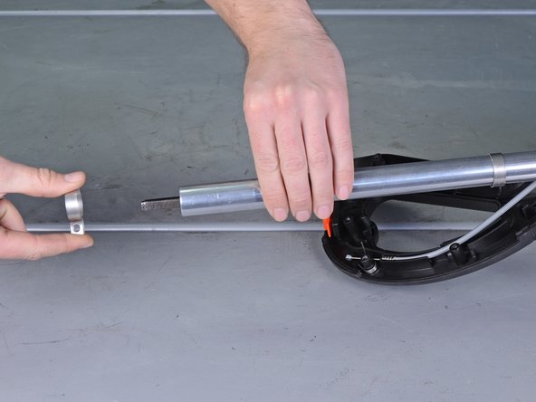

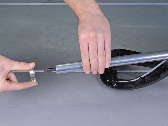

  7. Echo Power Pruner 254 cc PPT2620 2019 Flexible Tube Replacement: crwdns2935265:07crwdnd2935265:01crwdnd2935265:03crwdne2935265:0 Echo Power Pruner 254 cc PPT2620 2019 Flexible Tube Replacement: crwdns2935265:07crwdnd2935265:02crwdnd2935265:03crwdne2935265:0 Echo Power Pruner 254 cc PPT2620 2019 Flexible Tube Replacement: crwdns2935265:07crwdnd2935265:03crwdnd2935265:03crwdne2935265:0
    • Slide the strap hook off the pipe and remove it.
    • Slide both clamps that held the handle off of the pipe and remove them.
  8. Echo Power Pruner 254 cc PPT2620 2019 Flexible Tube Replacement, Remove the flexible tube: crwdns2935265:08crwdnd2935265:01crwdnd2935265:01crwdne2935265:0
    • Slide the flexible tube off of the handle pipe and remove it.
