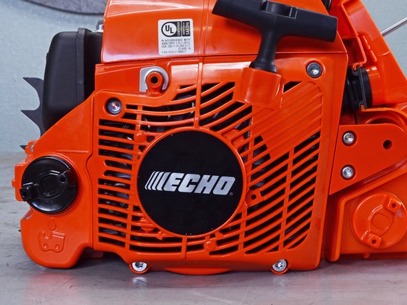

    • Remove the air filter
    • During reassembly, clean the air filter with compressed air or with light brushing before reinstalling it.

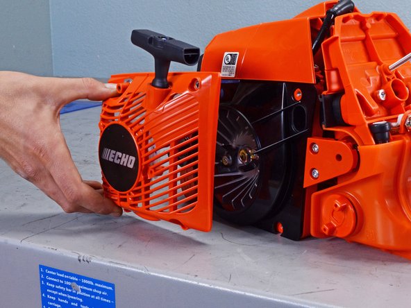

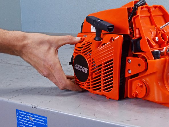

  13. Echo Chain Saw CS590 2019 Starter Assembly Replacement, Unfasten the starter case: crwdns2935265:013crwdnd2935265:01crwdnd2935265:02crwdne2935265:0 Echo Chain Saw CS590 2019 Starter Assembly Replacement, Unfasten the starter case: crwdns2935265:013crwdnd2935265:02crwdnd2935265:02crwdne2935265:0
    • Use a T25 Torx screwdriver to remove the four 24 mm screws securing the starter case.
  14. Echo Chain Saw CS590 2019 Starter Assembly Replacement, Remove the starter cover: crwdns2935265:014crwdnd2935265:01crwdnd2935265:03crwdne2935265:0 Echo Chain Saw CS590 2019 Starter Assembly Replacement, Remove the starter cover: crwdns2935265:014crwdnd2935265:02crwdnd2935265:03crwdne2935265:0 Echo Chain Saw CS590 2019 Starter Assembly Replacement, Remove the starter cover: crwdns2935265:014crwdnd2935265:03crwdnd2935265:03crwdne2935265:0
    • Pull the starter cover straight off its housing to remove it.

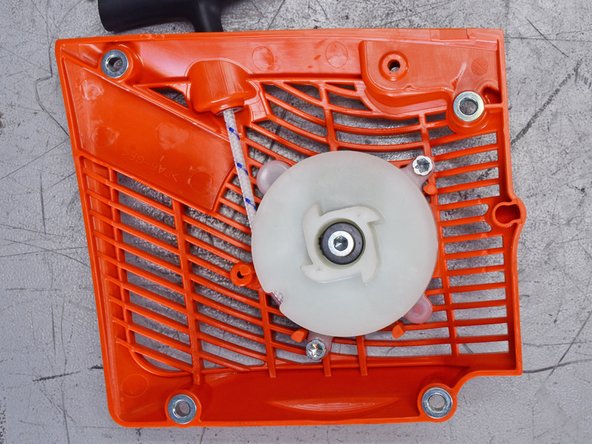

  15. Echo Chain Saw CS590 2019 Starter Assembly Replacement, Unfasten the starter plate: crwdns2935265:015crwdnd2935265:01crwdnd2935265:02crwdne2935265:0 Echo Chain Saw CS590 2019 Starter Assembly Replacement, Unfasten the starter plate: crwdns2935265:015crwdnd2935265:02crwdnd2935265:02crwdne2935265:0
    • Use a T25 Torx screwdriver to remove the three screws securing the starter plate:
    • Two 15 mm-long screws
    • One 14 mm-long screw
  16. Echo Chain Saw CS590 2019 Starter Assembly Replacement, Remove the starter plate: crwdns2935265:016crwdnd2935265:01crwdnd2935265:03crwdne2935265:0 Echo Chain Saw CS590 2019 Starter Assembly Replacement, Remove the starter plate: crwdns2935265:016crwdnd2935265:02crwdnd2935265:03crwdne2935265:0 Echo Chain Saw CS590 2019 Starter Assembly Replacement, Remove the starter plate: crwdns2935265:016crwdnd2935265:03crwdnd2935265:03crwdne2935265:0
    • Be very careful with this step, as there's a lot of tension in the recoil spring. If you remove the starter plate too quickly, you may unravel the coil.
    • Carefully lift the starter plate straight out of its recess and remove it.

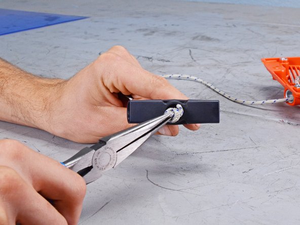

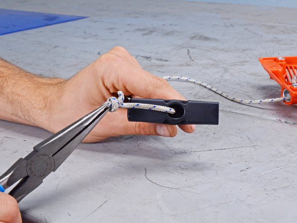

  17. Echo Chain Saw CS590 2019 Starter Assembly Replacement, Remove the starter grip: crwdns2935265:017crwdnd2935265:01crwdnd2935265:03crwdne2935265:0 Echo Chain Saw CS590 2019 Starter Assembly Replacement, Remove the starter grip: crwdns2935265:017crwdnd2935265:02crwdnd2935265:03crwdne2935265:0 Echo Chain Saw CS590 2019 Starter Assembly Replacement, Remove the starter grip: crwdns2935265:017crwdnd2935265:03crwdnd2935265:03crwdne2935265:0
    • Use pliers, or your fingers, to pull the rope knot out of the top of the starter grip.
    • Undo the knot and remove the grip.
