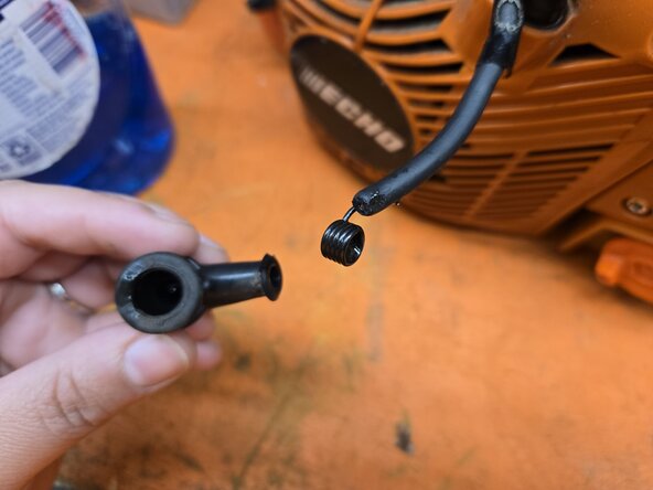

  22. Echo Chain Saw CS590 2019 Spark Plug Terminal Replacement, Disconnecting the cap from the coil: crwdns2935265:022crwdnd2935265:01crwdnd2935265:02crwdne2935265:0 Echo Chain Saw CS590 2019 Spark Plug Terminal Replacement, Disconnecting the cap from the coil: crwdns2935265:022crwdnd2935265:02crwdnd2935265:02crwdne2935265:0
    • When disconnecting the ignition coil from the spark plug cap, it is recommended to add dish soap to the cap. This should allow you to easily pull the ignition coil and terminal out of the cap. This can be done by hand, use pliers if needed.
    • The ignition coil may tear when attempting to remove the terminal. This will cause the terminal to remain in the boot/cap. Use pliers to remove this.
  23. Echo Chain Saw CS590 2019 Spark Plug Terminal Replacement, Remove the terminal: crwdns2935265:023crwdnd2935265:01crwdnd2935265:01crwdne2935265:0
    • Remove terminal from the ignition coil.
  24. Echo Chain Saw CS590 2019 Spark Plug Terminal Replacement, Replace terminal: crwdns2935265:024crwdnd2935265:01crwdnd2935265:01crwdne2935265:0
    • Replace the ignition coil tubing if needed at this step.
    • Gently squeeze the pointed end of the terminal into the end of the ignition coil using a pair of pliers.
  25. Echo Chain Saw CS590 2019 Spark Plug Terminal Replacement, Reinsert the terminal/coil: crwdns2935265:025crwdnd2935265:01crwdnd2935265:01crwdne2935265:0
    • Slide the ignition coil/terminal connection back in to the spark plug cap/boot. Add a drop or two of dish soap to the small opening on the spark plug cap/boot to make this easier.
    • Hold your connection together as best you can while reinserting. I let mine disconnect almost 3 times before this photo.
    • Clean any residual dish soap from the spark plug cap/boot before connecting it to the spark plug.
