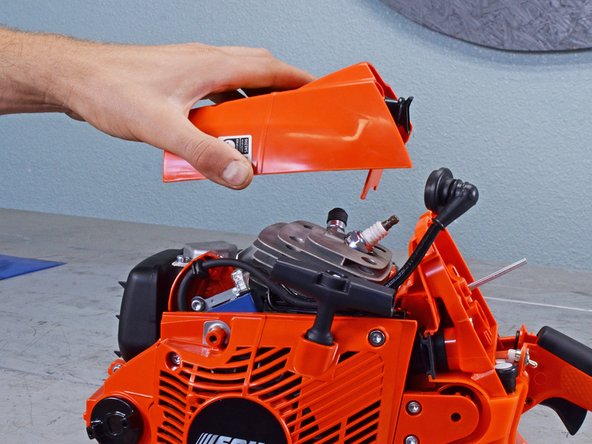

  4. Echo Chain Saw CS590 2019 Oil System Replacement, Disconnect the spark plug: crwdns2935265:04crwdnd2935265:01crwdnd2935265:03crwdne2935265:0 Echo Chain Saw CS590 2019 Oil System Replacement, Disconnect the spark plug: crwdns2935265:04crwdnd2935265:02crwdnd2935265:03crwdne2935265:0 Echo Chain Saw CS590 2019 Oil System Replacement, Disconnect the spark plug: crwdns2935265:04crwdnd2935265:03crwdnd2935265:03crwdne2935265:0
    • Use your fingers to pull up and disconnect the spark plug boot.

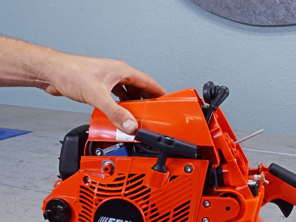

  14. Echo Chain Saw CS590 2019 Oil System Replacement, Remove the engine cover: crwdns2935265:014crwdnd2935265:01crwdnd2935265:03crwdne2935265:0 Echo Chain Saw CS590 2019 Oil System Replacement, Remove the engine cover: crwdns2935265:014crwdnd2935265:02crwdnd2935265:03crwdne2935265:0 Echo Chain Saw CS590 2019 Oil System Replacement, Remove the engine cover: crwdns2935265:014crwdnd2935265:03crwdnd2935265:03crwdne2935265:0
    • Pull the engine cover straight off the device to remove it.

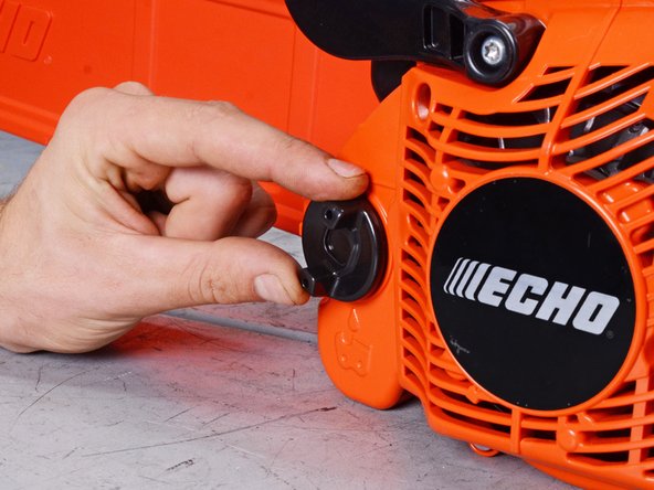

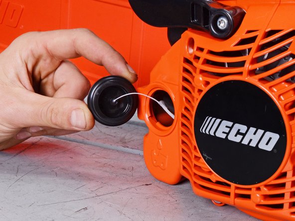

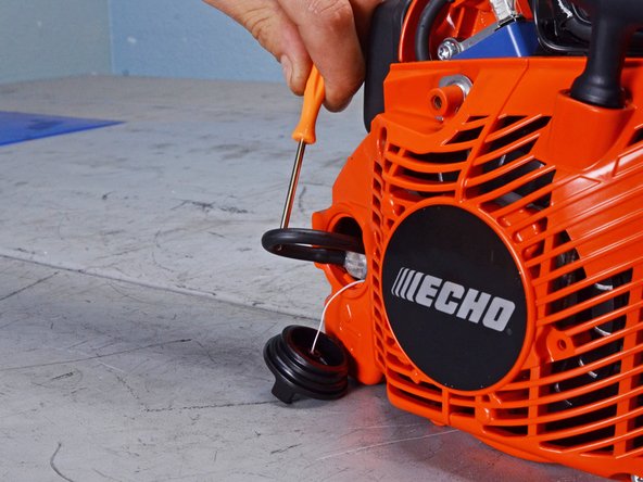

  15. Echo Chain Saw CS590 2019 Oil System Replacement, Remove the oil cap: crwdns2935265:015crwdnd2935265:01crwdnd2935265:03crwdne2935265:0 Echo Chain Saw CS590 2019 Oil System Replacement, Remove the oil cap: crwdns2935265:015crwdnd2935265:02crwdnd2935265:03crwdne2935265:0 Echo Chain Saw CS590 2019 Oil System Replacement, Remove the oil cap: crwdns2935265:015crwdnd2935265:03crwdnd2935265:03crwdne2935265:0
    • Use your fingers to loosen and remove the oil cap.

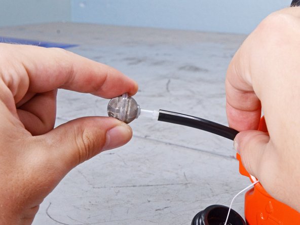

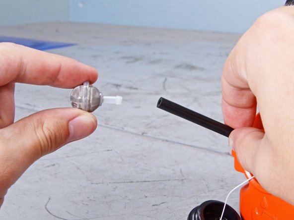

  16. Echo Chain Saw CS590 2019 Oil System Replacement, Remove the oil filter: crwdns2935265:016crwdnd2935265:01crwdnd2935265:03crwdne2935265:0 Echo Chain Saw CS590 2019 Oil System Replacement, Remove the oil filter: crwdns2935265:016crwdnd2935265:02crwdnd2935265:03crwdne2935265:0 Echo Chain Saw CS590 2019 Oil System Replacement, Remove the oil filter: crwdns2935265:016crwdnd2935265:03crwdnd2935265:03crwdne2935265:0
    • Use a flathead screwdriver, or your fingers, to remove the oil filter from its recess in the fuel assembly.
  17. Echo Chain Saw CS590 2019 Oil System Replacement: crwdns2935265:017crwdnd2935265:01crwdnd2935265:03crwdne2935265:0 Echo Chain Saw CS590 2019 Oil System Replacement: crwdns2935265:017crwdnd2935265:02crwdnd2935265:03crwdne2935265:0 Echo Chain Saw CS590 2019 Oil System Replacement: crwdns2935265:017crwdnd2935265:03crwdnd2935265:03crwdne2935265:0
    • Pull on the oil filter to separate it from the fuel pipe.

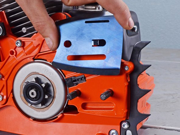

  18. Echo Chain Saw CS590 2019 Oil System Replacement, Remove the inner guide plate: crwdns2935265:018crwdnd2935265:01crwdnd2935265:02crwdne2935265:0 Echo Chain Saw CS590 2019 Oil System Replacement, Remove the inner guide plate: crwdns2935265:018crwdnd2935265:02crwdnd2935265:02crwdne2935265:0
    • Insert the edge of a screwdriver between the inner guide plate and the chassis.
    • Pry up with the screwdriver to initially separate the plate.
    • Slide the plate out of its two bolts to remove it.

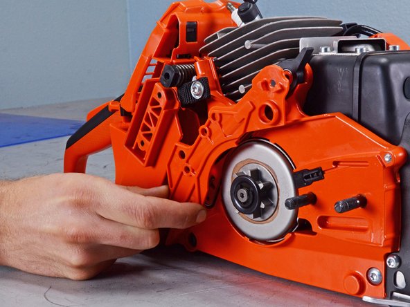

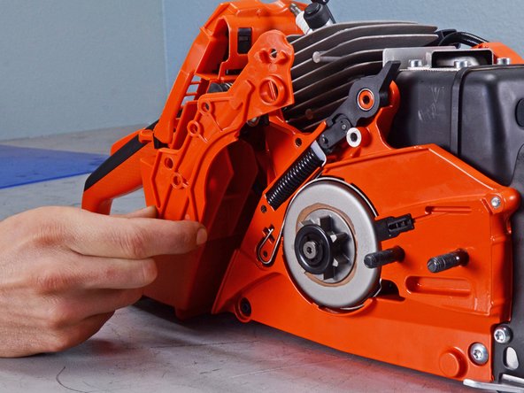

  20. Echo Chain Saw CS590 2019 Oil System Replacement, Remove the brake cover: crwdns2935265:020crwdnd2935265:01crwdnd2935265:03crwdne2935265:0 Echo Chain Saw CS590 2019 Oil System Replacement, Remove the brake cover: crwdns2935265:020crwdnd2935265:02crwdnd2935265:03crwdne2935265:0 Echo Chain Saw CS590 2019 Oil System Replacement, Remove the brake cover: crwdns2935265:020crwdnd2935265:03crwdnd2935265:03crwdne2935265:0
    • Pull the brake cover straight off the clutch drum to remove it.

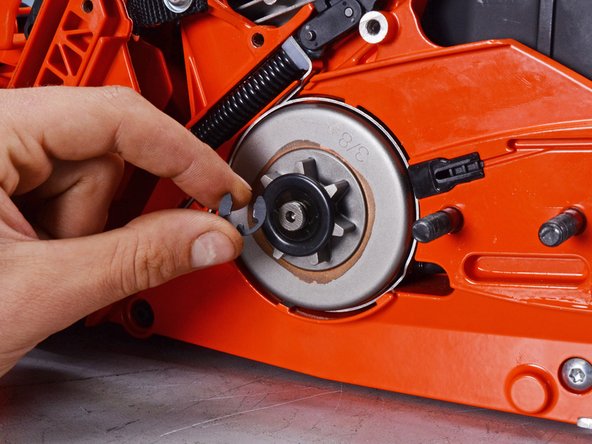

  21. Echo Chain Saw CS590 2019 Oil System Replacement, Remove the E-ring: crwdns2935265:021crwdnd2935265:01crwdnd2935265:03crwdne2935265:0 Echo Chain Saw CS590 2019 Oil System Replacement, Remove the E-ring: crwdns2935265:021crwdnd2935265:02crwdnd2935265:03crwdne2935265:0 Echo Chain Saw CS590 2019 Oil System Replacement, Remove the E-ring: crwdns2935265:021crwdnd2935265:03crwdnd2935265:03crwdne2935265:0
    • Use E-ring pliers, or a flathead screwdriver, to remove the E-ring on the clutch drum.

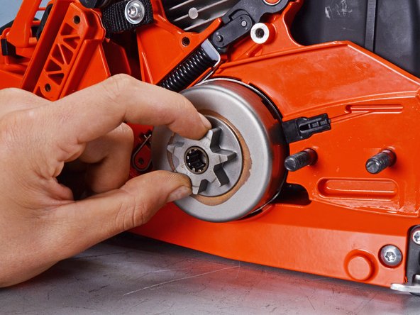

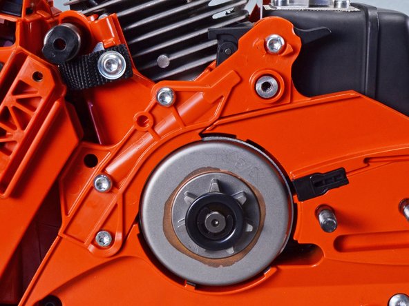

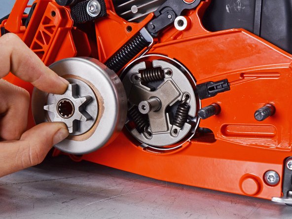

  23. Echo Chain Saw CS590 2019 Oil System Replacement, Remove the clutch drum: crwdns2935265:023crwdnd2935265:01crwdnd2935265:03crwdne2935265:0 Echo Chain Saw CS590 2019 Oil System Replacement, Remove the clutch drum: crwdns2935265:023crwdnd2935265:02crwdnd2935265:03crwdne2935265:0 Echo Chain Saw CS590 2019 Oil System Replacement, Remove the clutch drum: crwdns2935265:023crwdnd2935265:03crwdnd2935265:03crwdne2935265:0
    • Pull the clutch drum straight out of its recess to remove it.
    • The needle bearing should come out with the clutch drum. Make sure bearing is reinserted before reinstalling the clutch drum.

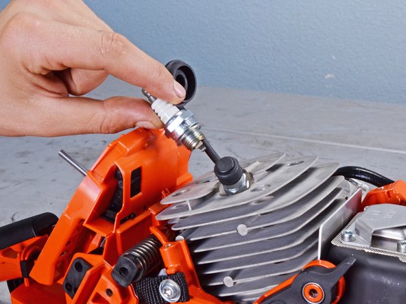

  24. Echo Chain Saw CS590 2019 Oil System Replacement, Remove the spark plug: crwdns2935265:024crwdnd2935265:01crwdnd2935265:02crwdne2935265:0 Echo Chain Saw CS590 2019 Oil System Replacement, Remove the spark plug: crwdns2935265:024crwdnd2935265:02crwdnd2935265:02crwdne2935265:0
    • Use a spark plug socket to loosen and remove the spark plug.

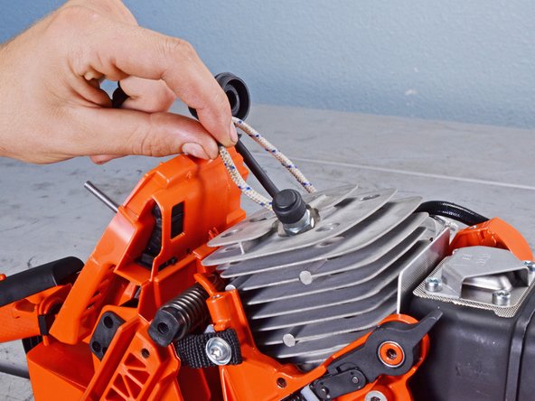

  25. Echo Chain Saw CS590 2019 Oil System Replacement, Insert a rope: crwdns2935265:025crwdnd2935265:01crwdnd2935265:03crwdne2935265:0 Echo Chain Saw CS590 2019 Oil System Replacement, Insert a rope: crwdns2935265:025crwdnd2935265:02crwdnd2935265:03crwdne2935265:0 Echo Chain Saw CS590 2019 Oil System Replacement, Insert a rope: crwdns2935265:025crwdnd2935265:03crwdnd2935265:03crwdne2935265:0
    • Feed a piston stopping cord or rope through the cylinder head into the combustion chamber until the crankshaft can no longer rotate.
    • Do not insert the entire cord into the combustion chamber.

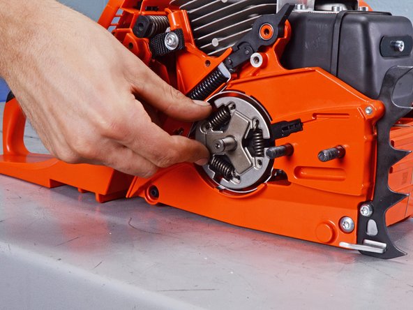

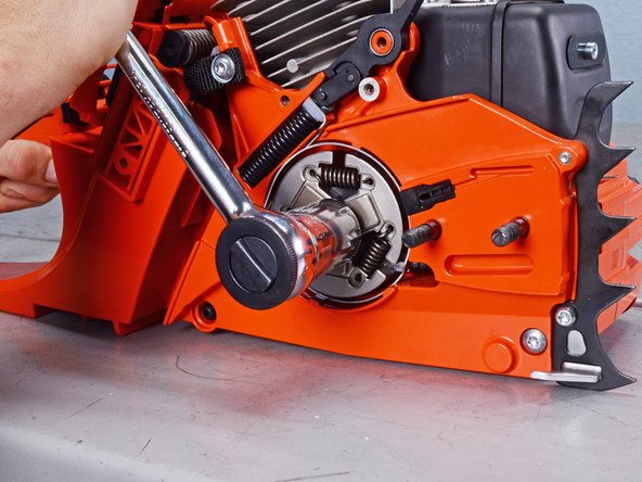

  26. Echo Chain Saw CS590 2019 Oil System Replacement, Remove the clutch assembly: crwdns2935265:026crwdnd2935265:01crwdnd2935265:02crwdne2935265:0 Echo Chain Saw CS590 2019 Oil System Replacement, Remove the clutch assembly: crwdns2935265:026crwdnd2935265:02crwdnd2935265:02crwdne2935265:0
    • Use a clutch removal tool and a wrench to loosen the clutch assembly.
    • Rotate the wrench clockwise instead of counterclockwise .
  27. Echo Chain Saw CS590 2019 Oil System Replacement: crwdns2935265:027crwdnd2935265:01crwdnd2935265:03crwdne2935265:0 Echo Chain Saw CS590 2019 Oil System Replacement: crwdns2935265:027crwdnd2935265:02crwdnd2935265:03crwdne2935265:0 Echo Chain Saw CS590 2019 Oil System Replacement: crwdns2935265:027crwdnd2935265:03crwdnd2935265:03crwdne2935265:0
    • Use your fingers to loosen the clutch assembly and remove it from the crankshaft.

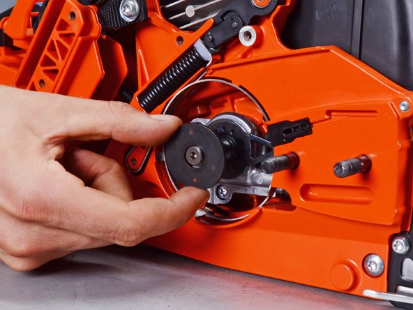

  28. Echo Chain Saw CS590 2019 Oil System Replacement, Remove the clutch plate: crwdns2935265:028crwdnd2935265:01crwdnd2935265:03crwdne2935265:0 Echo Chain Saw CS590 2019 Oil System Replacement, Remove the clutch plate: crwdns2935265:028crwdnd2935265:02crwdnd2935265:03crwdne2935265:0 Echo Chain Saw CS590 2019 Oil System Replacement, Remove the clutch plate: crwdns2935265:028crwdnd2935265:03crwdnd2935265:03crwdne2935265:0
    • Use your fingers to pull the clutch plate straight off of the crankshaft and remove it.

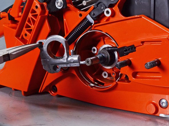

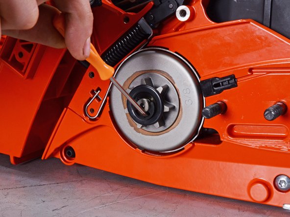

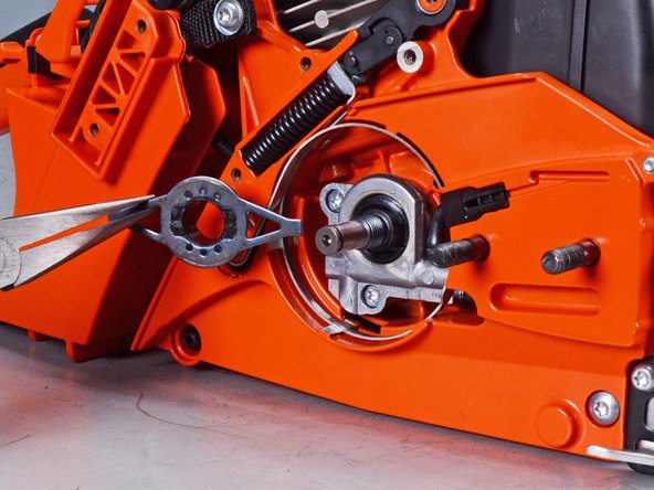

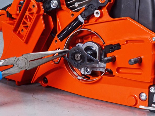

  30. Echo Chain Saw CS590 2019 Oil System Replacement, Remove the worm gear: crwdns2935265:030crwdnd2935265:01crwdnd2935265:03crwdne2935265:0 Echo Chain Saw CS590 2019 Oil System Replacement, Remove the worm gear: crwdns2935265:030crwdnd2935265:02crwdnd2935265:03crwdne2935265:0 Echo Chain Saw CS590 2019 Oil System Replacement, Remove the worm gear: crwdns2935265:030crwdnd2935265:03crwdnd2935265:03crwdne2935265:0
    • Use pliers to pull the worm gear straight out its housing to remove it.

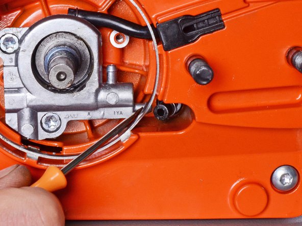

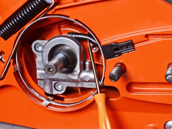

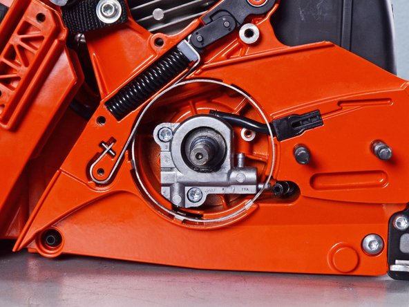

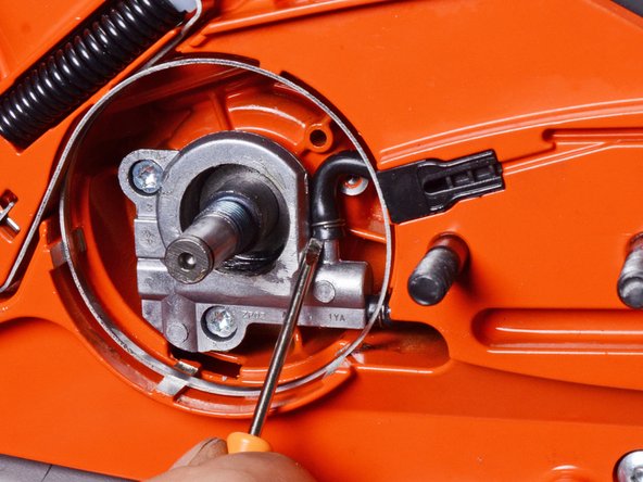

  31. Echo Chain Saw CS590 2019 Oil System Replacement, Disconnect the oiler assembly: crwdns2935265:031crwdnd2935265:01crwdnd2935265:03crwdne2935265:0 Echo Chain Saw CS590 2019 Oil System Replacement, Disconnect the oiler assembly: crwdns2935265:031crwdnd2935265:02crwdnd2935265:03crwdne2935265:0 Echo Chain Saw CS590 2019 Oil System Replacement, Disconnect the oiler assembly: crwdns2935265:031crwdnd2935265:03crwdnd2935265:03crwdne2935265:0
    • Use your fingers, or a flathead screwdriver, to disconnect the top oil pipe from the oiler assembly.
    • Only use a flathead screwdriver if the fuel pipe is too tight. The sharp edge could cause a split in the pipe.

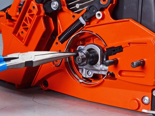

  32. Echo Chain Saw CS590 2019 Oil System Replacement: crwdns2935265:032crwdnd2935265:01crwdnd2935265:02crwdne2935265:0 Echo Chain Saw CS590 2019 Oil System Replacement: crwdns2935265:032crwdnd2935265:02crwdnd2935265:02crwdne2935265:0
    • Use your fingers, or a flathead screwdriver, to disconnect the right oil pipe from the oiler assembly.
  33. Echo Chain Saw CS590 2019 Oil System Replacement, Unfasten the oiler assembly: crwdns2935265:033crwdnd2935265:01crwdnd2935265:02crwdne2935265:0 Echo Chain Saw CS590 2019 Oil System Replacement, Unfasten the oiler assembly: crwdns2935265:033crwdnd2935265:02crwdnd2935265:02crwdne2935265:0
    • Use a T25 Torx screwdriver to remove the two 15 mm screws securing the oiler assembly.

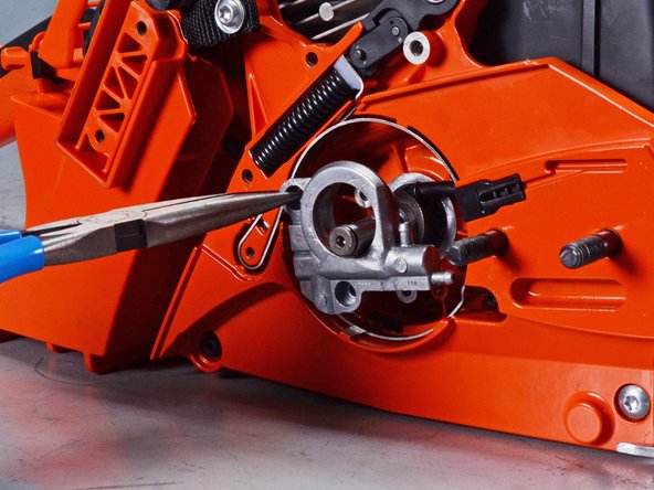

  34. Echo Chain Saw CS590 2019 Oil System Replacement, Remove the oiler assembly: crwdns2935265:034crwdnd2935265:01crwdnd2935265:03crwdne2935265:0 Echo Chain Saw CS590 2019 Oil System Replacement, Remove the oiler assembly: crwdns2935265:034crwdnd2935265:02crwdnd2935265:03crwdne2935265:0 Echo Chain Saw CS590 2019 Oil System Replacement, Remove the oiler assembly: crwdns2935265:034crwdnd2935265:03crwdnd2935265:03crwdne2935265:0
    • Use pliers, or your fingers, to pull the oiler assembly straight out its housing to remove it.

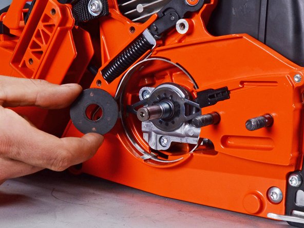

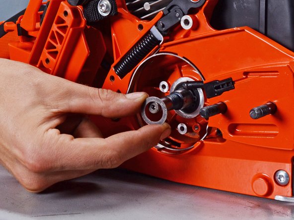

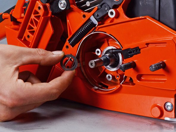

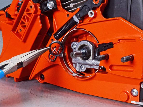

  35. Echo Chain Saw CS590 2019 Oil System Replacement, Remove the washer: crwdns2935265:035crwdnd2935265:01crwdnd2935265:03crwdne2935265:0 Echo Chain Saw CS590 2019 Oil System Replacement, Remove the washer: crwdns2935265:035crwdnd2935265:02crwdnd2935265:03crwdne2935265:0 Echo Chain Saw CS590 2019 Oil System Replacement, Remove the washer: crwdns2935265:035crwdnd2935265:03crwdnd2935265:03crwdne2935265:0
    • Use pliers, or your fingers, to pull the washer off of the crankshaft and remove it.

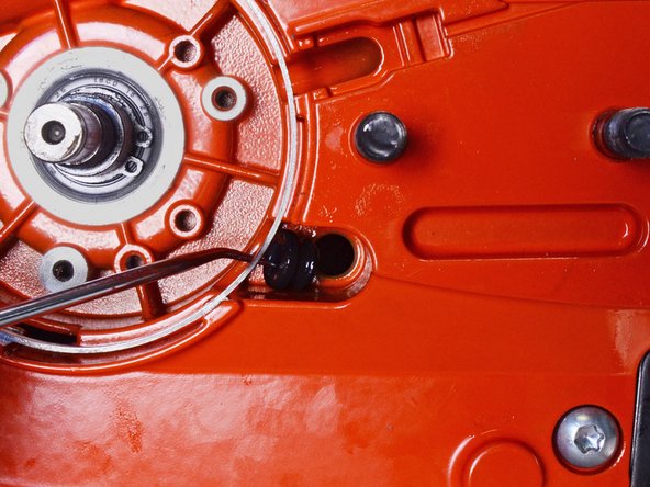

  36. Echo Chain Saw CS590 2019 Oil System Replacement, Remove the oil outlet port: crwdns2935265:036crwdnd2935265:01crwdnd2935265:03crwdne2935265:0 Echo Chain Saw CS590 2019 Oil System Replacement, Remove the oil outlet port: crwdns2935265:036crwdnd2935265:02crwdnd2935265:03crwdne2935265:0 Echo Chain Saw CS590 2019 Oil System Replacement, Remove the oil outlet port: crwdns2935265:036crwdnd2935265:03crwdnd2935265:03crwdne2935265:0
    • Use a flathead screwdriver to pry the oil outlet port out its recess in the chassis.
    • Remove the oil outlet port.

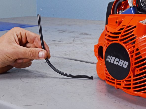

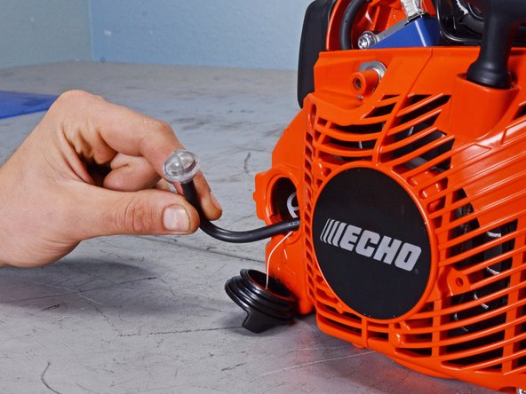

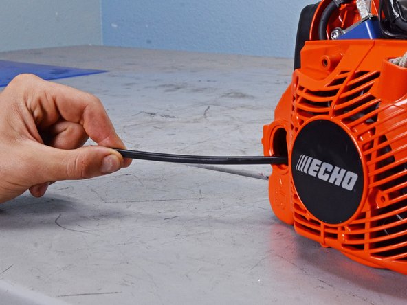

  37. Echo Chain Saw CS590 2019 Oil System Replacement, Remove the oil pipe: crwdns2935265:037crwdnd2935265:01crwdnd2935265:03crwdne2935265:0 Echo Chain Saw CS590 2019 Oil System Replacement, Remove the oil pipe: crwdns2935265:037crwdnd2935265:02crwdnd2935265:03crwdne2935265:0 Echo Chain Saw CS590 2019 Oil System Replacement, Remove the oil pipe: crwdns2935265:037crwdnd2935265:03crwdnd2935265:03crwdne2935265:0
    • Thread the oil pipe through the oil cap recess to remove it.

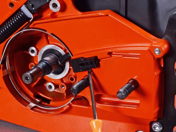

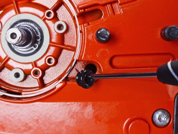

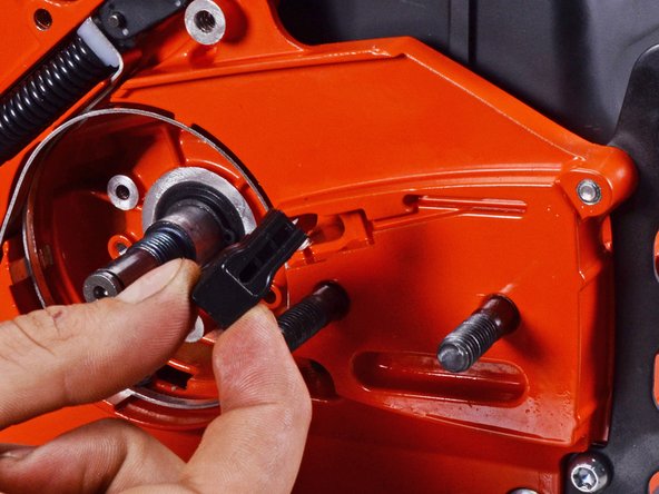

  38. Echo Chain Saw CS590 2019 Oil System Replacement, Remove the grommet: crwdns2935265:038crwdnd2935265:01crwdnd2935265:03crwdne2935265:0 Echo Chain Saw CS590 2019 Oil System Replacement, Remove the grommet: crwdns2935265:038crwdnd2935265:02crwdnd2935265:03crwdne2935265:0 Echo Chain Saw CS590 2019 Oil System Replacement, Remove the grommet: crwdns2935265:038crwdnd2935265:03crwdnd2935265:03crwdne2935265:0
    • Use a pick tool to remove the grommet next to the clutch assembly's recess.

***Step 36*** Remove the retaining ring . Is there a reason to remove, unless you're doing a complete teardown?
VAL - crwdns2934203:0crwdne2934203:0
Hi there.
You're right! That was a left over from a different procedure, and I'll remove the step. Thank you!
