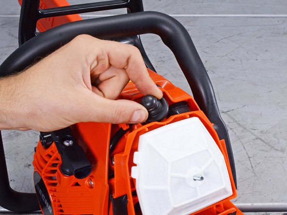

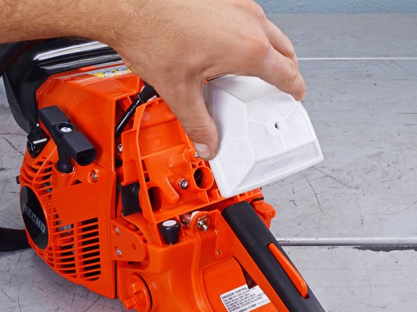

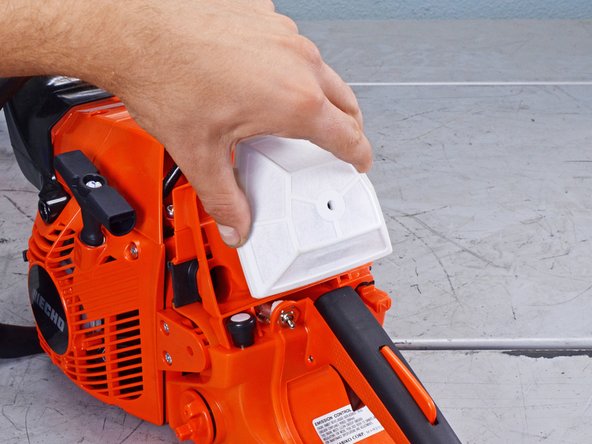

  2. Echo Chain Saw CS590 2019 Ignition Assembly Replacement, Loosen the air filter cover: crwdns2935265:02crwdnd2935265:01crwdnd2935265:02crwdne2935265:0 Echo Chain Saw CS590 2019 Ignition Assembly Replacement, Loosen the air filter cover: crwdns2935265:02crwdnd2935265:02crwdnd2935265:02crwdne2935265:0
    • Use your fingers to loosen the air filter cover knob.
  3. Echo Chain Saw CS590 2019 Ignition Assembly Replacement: crwdns2935265:03crwdnd2935265:01crwdnd2935265:03crwdne2935265:0 Echo Chain Saw CS590 2019 Ignition Assembly Replacement: crwdns2935265:03crwdnd2935265:02crwdnd2935265:03crwdne2935265:0 Echo Chain Saw CS590 2019 Ignition Assembly Replacement: crwdns2935265:03crwdnd2935265:03crwdnd2935265:03crwdne2935265:0
    • Remove the air filter cover.

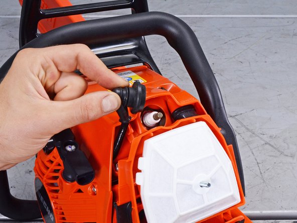

  4. Echo Chain Saw CS590 2019 Ignition Assembly Replacement, Disconnect the spark plug: crwdns2935265:04crwdnd2935265:01crwdnd2935265:03crwdne2935265:0 Echo Chain Saw CS590 2019 Ignition Assembly Replacement, Disconnect the spark plug: crwdns2935265:04crwdnd2935265:02crwdnd2935265:03crwdne2935265:0 Echo Chain Saw CS590 2019 Ignition Assembly Replacement, Disconnect the spark plug: crwdns2935265:04crwdnd2935265:03crwdnd2935265:03crwdne2935265:0
    • Use your fingers to pull up and disconnect the spark plug boot.
  5. Echo Chain Saw CS590 2019 Ignition Assembly Replacement, Remove the air filter: crwdns2935265:05crwdnd2935265:01crwdnd2935265:03crwdne2935265:0 Echo Chain Saw CS590 2019 Ignition Assembly Replacement, Remove the air filter: crwdns2935265:05crwdnd2935265:02crwdnd2935265:03crwdne2935265:0 Echo Chain Saw CS590 2019 Ignition Assembly Replacement, Remove the air filter: crwdns2935265:05crwdnd2935265:03crwdnd2935265:03crwdne2935265:0
    • To minimize debris entering the intake, pull the choke shut before continuing.
    • During reassembly, clean the air filter with compressed air or with light brushing before reinstalling it.

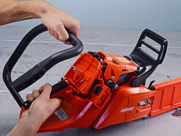

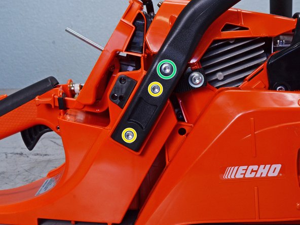

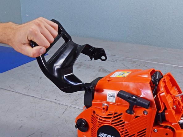

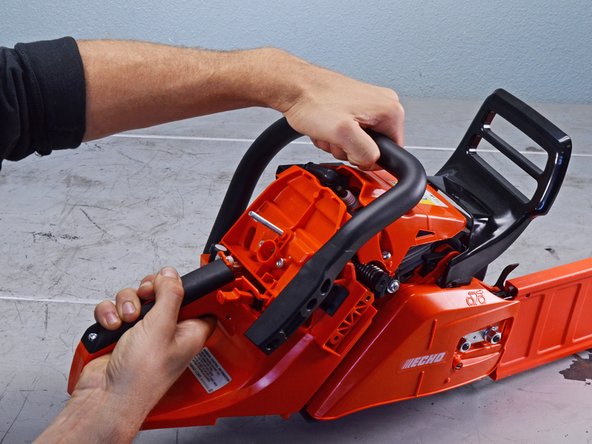

  6. Echo Chain Saw CS590 2019 Ignition Assembly Replacement, Unfasten the front handle: crwdns2935265:06crwdnd2935265:01crwdnd2935265:02crwdne2935265:0 Echo Chain Saw CS590 2019 Ignition Assembly Replacement, Unfasten the front handle: crwdns2935265:06crwdnd2935265:02crwdnd2935265:02crwdne2935265:0
    • Use a T25 Torx screwdriver to remove the five screws securing the front handle to the bottom and right side of the device:
    • Four 24 mm-long screws
    • One 25 mm-long screw
  7. Echo Chain Saw CS590 2019 Ignition Assembly Replacement, Remove the front handle: crwdns2935265:07crwdnd2935265:01crwdnd2935265:03crwdne2935265:0 Echo Chain Saw CS590 2019 Ignition Assembly Replacement, Remove the front handle: crwdns2935265:07crwdnd2935265:02crwdnd2935265:03crwdne2935265:0 Echo Chain Saw CS590 2019 Ignition Assembly Replacement, Remove the front handle: crwdns2935265:07crwdnd2935265:03crwdnd2935265:03crwdne2935265:0
    • Pull the handle toward the rear of the device to remove it.

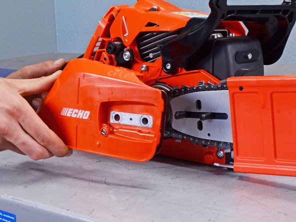

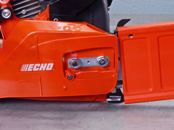

  8. Echo Chain Saw CS590 2019 Ignition Assembly Replacement, Remove the sprocket guard: crwdns2935265:08crwdnd2935265:01crwdnd2935265:02crwdne2935265:0 Echo Chain Saw CS590 2019 Ignition Assembly Replacement, Remove the sprocket guard: crwdns2935265:08crwdnd2935265:02crwdnd2935265:02crwdne2935265:0
    • Use a 13 mm wrench to remove the two nuts securing the sprocket guard.
  9. Echo Chain Saw CS590 2019 Ignition Assembly Replacement: crwdns2935265:09crwdnd2935265:01crwdnd2935265:03crwdne2935265:0 Echo Chain Saw CS590 2019 Ignition Assembly Replacement: crwdns2935265:09crwdnd2935265:02crwdnd2935265:03crwdne2935265:0 Echo Chain Saw CS590 2019 Ignition Assembly Replacement: crwdns2935265:09crwdnd2935265:03crwdnd2935265:03crwdne2935265:0
    • Remove the sprocket guard.

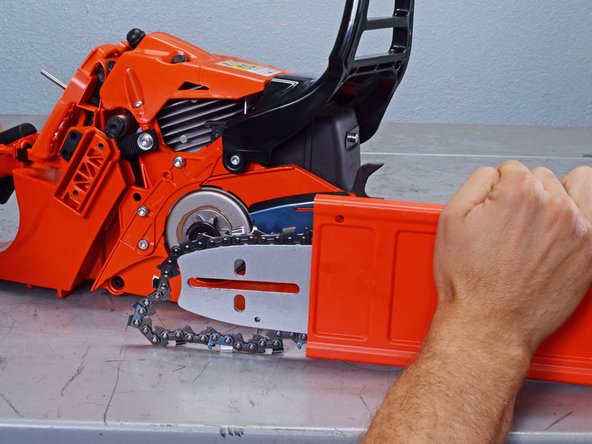

  10. Echo Chain Saw CS590 2019 Ignition Assembly Replacement, Remove the guide bar: crwdns2935265:010crwdnd2935265:01crwdnd2935265:03crwdne2935265:0 Echo Chain Saw CS590 2019 Ignition Assembly Replacement, Remove the guide bar: crwdns2935265:010crwdnd2935265:02crwdnd2935265:03crwdne2935265:0 Echo Chain Saw CS590 2019 Ignition Assembly Replacement, Remove the guide bar: crwdns2935265:010crwdnd2935265:03crwdnd2935265:03crwdne2935265:0
    • Push the guide bar towards the back of the device to create slack in the saw chain.
    • Pull the guide bar away from the device to separate the saw chain from the clutch drum.
    • Remove the guide bar.

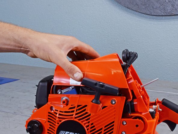

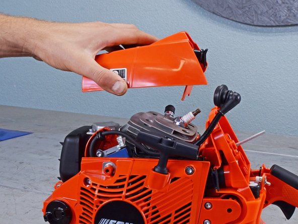

  13. Echo Chain Saw CS590 2019 Ignition Assembly Replacement, Unfasten the engine cover: crwdns2935265:013crwdnd2935265:01crwdnd2935265:02crwdne2935265:0 Echo Chain Saw CS590 2019 Ignition Assembly Replacement, Unfasten the engine cover: crwdns2935265:013crwdnd2935265:02crwdnd2935265:02crwdne2935265:0
    • Use a T25 Torx screwdriver to remove the three 20 mm screws securing the engine cover.
  14. Echo Chain Saw CS590 2019 Ignition Assembly Replacement, Remove the engine cover: crwdns2935265:014crwdnd2935265:01crwdnd2935265:03crwdne2935265:0 Echo Chain Saw CS590 2019 Ignition Assembly Replacement, Remove the engine cover: crwdns2935265:014crwdnd2935265:02crwdnd2935265:03crwdne2935265:0 Echo Chain Saw CS590 2019 Ignition Assembly Replacement, Remove the engine cover: crwdns2935265:014crwdnd2935265:03crwdnd2935265:03crwdne2935265:0
    • Pull the engine cover straight off the device to remove it.

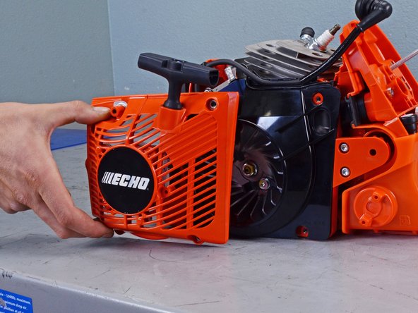

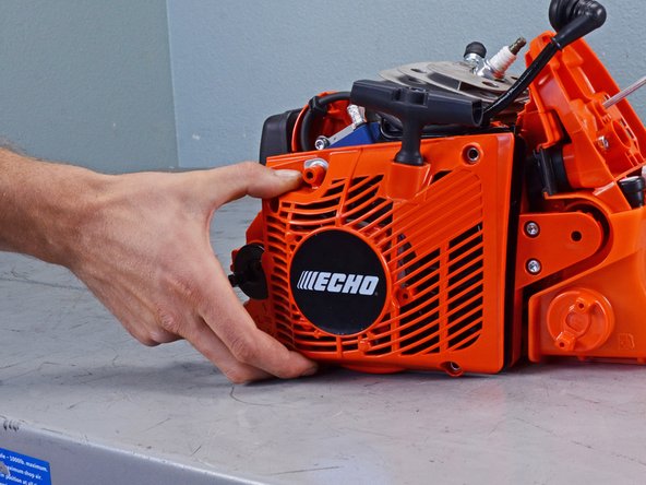

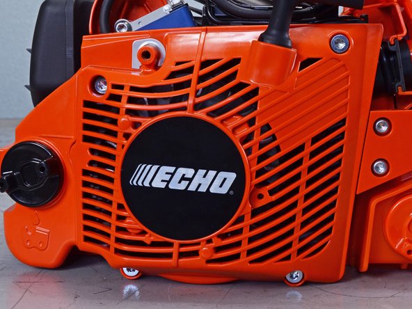

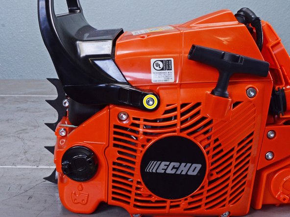

  15. Echo Chain Saw CS590 2019 Ignition Assembly Replacement, Unfasten the starter case: crwdns2935265:015crwdnd2935265:01crwdnd2935265:02crwdne2935265:0 Echo Chain Saw CS590 2019 Ignition Assembly Replacement, Unfasten the starter case: crwdns2935265:015crwdnd2935265:02crwdnd2935265:02crwdne2935265:0
    • Use a T25 Torx screwdriver to remove the four 24 mm screws securing the starter case.
  16. Echo Chain Saw CS590 2019 Ignition Assembly Replacement: crwdns2935265:016crwdnd2935265:01crwdnd2935265:03crwdne2935265:0 Echo Chain Saw CS590 2019 Ignition Assembly Replacement: crwdns2935265:016crwdnd2935265:02crwdnd2935265:03crwdne2935265:0 Echo Chain Saw CS590 2019 Ignition Assembly Replacement: crwdns2935265:016crwdnd2935265:03crwdnd2935265:03crwdne2935265:0
    • Remove the starter case.

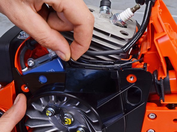

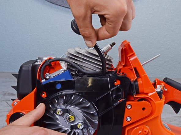

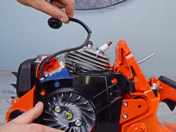

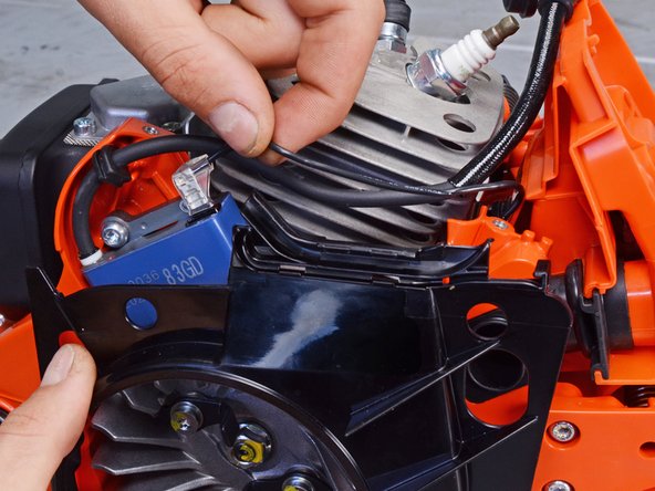

  17. Echo Chain Saw CS590 2019 Ignition Assembly Replacement, Reposition the spark plug cable: crwdns2935265:017crwdnd2935265:01crwdnd2935265:03crwdne2935265:0 Echo Chain Saw CS590 2019 Ignition Assembly Replacement, Reposition the spark plug cable: crwdns2935265:017crwdnd2935265:02crwdnd2935265:03crwdne2935265:0 Echo Chain Saw CS590 2019 Ignition Assembly Replacement, Reposition the spark plug cable: crwdns2935265:017crwdnd2935265:03crwdnd2935265:03crwdne2935265:0
    • Use your fingers to reroute the spark plug cable from its slot in the fan cover.
  18. Echo Chain Saw CS590 2019 Ignition Assembly Replacement, Reposition the ignition coil cable: crwdns2935265:018crwdnd2935265:01crwdnd2935265:03crwdne2935265:0 Echo Chain Saw CS590 2019 Ignition Assembly Replacement, Reposition the ignition coil cable: crwdns2935265:018crwdnd2935265:02crwdnd2935265:03crwdne2935265:0 Echo Chain Saw CS590 2019 Ignition Assembly Replacement, Reposition the ignition coil cable: crwdns2935265:018crwdnd2935265:03crwdnd2935265:03crwdne2935265:0
    • Use your fingers to reroute the ignition coil cable from its slot in the fan cover.

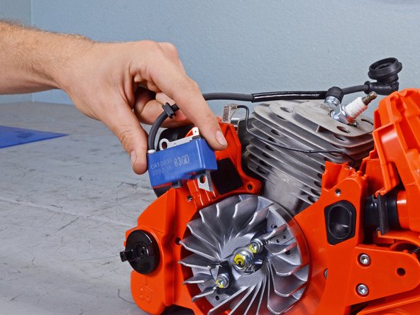

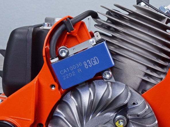

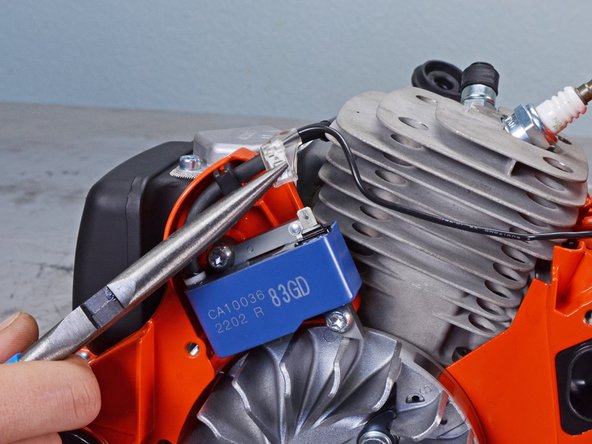

  19. Echo Chain Saw CS590 2019 Ignition Assembly Replacement, Disconnect the ignition coil: crwdns2935265:019crwdnd2935265:01crwdnd2935265:02crwdne2935265:0 Echo Chain Saw CS590 2019 Ignition Assembly Replacement, Disconnect the ignition coil: crwdns2935265:019crwdnd2935265:02crwdnd2935265:02crwdne2935265:0
    • Use pliers, or your fingers, to disconnect the ignition coil cable's spade connector.
    • Grip the connector by the base of the clear head and not the wire itself.
  20. Echo Chain Saw CS590 2019 Ignition Assembly Replacement, Unfasten the ignition coil: crwdns2935265:020crwdnd2935265:01crwdnd2935265:02crwdne2935265:0 Echo Chain Saw CS590 2019 Ignition Assembly Replacement, Unfasten the ignition coil: crwdns2935265:020crwdnd2935265:02crwdnd2935265:02crwdne2935265:0
    • Use a T25 Torx screwdriver to remove the two 20 mm screws securing the ignition coil.
    • During reassembly, insert the ignition air gap gauge to ensure a 0.35 mm space between the coil and the magnet.
  21. Echo Chain Saw CS590 2019 Ignition Assembly Replacement, Remove the ignition coil: crwdns2935265:021crwdnd2935265:01crwdnd2935265:02crwdne2935265:0 Echo Chain Saw CS590 2019 Ignition Assembly Replacement, Remove the ignition coil: crwdns2935265:021crwdnd2935265:02crwdnd2935265:02crwdne2935265:0
    • Remove the ignition coil.

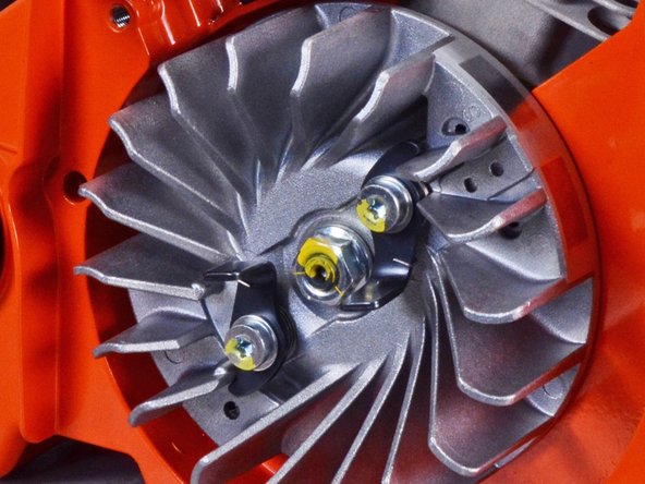

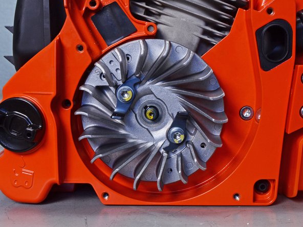

  22. Echo Chain Saw CS590 2019 Ignition Assembly Replacement, Remove the flange nut: crwdns2935265:022crwdnd2935265:01crwdnd2935265:02crwdne2935265:0 Echo Chain Saw CS590 2019 Ignition Assembly Replacement, Remove the flange nut: crwdns2935265:022crwdnd2935265:02crwdnd2935265:02crwdne2935265:0
    • Wedge a flathead screwdriver between the chassis and the flywheel's spokes to prevent the flywheel from spinning.
    • Alternatively, you can seize the piston by inserting a rope down the spark plug shaft.
    • Use a 13 mm wrench to loosen and remove the flange nut located in the middle of the flywheel.
  23. Echo Chain Saw CS590 2019 Ignition Assembly Replacement, Unfasten the starter pawls: crwdns2935265:023crwdnd2935265:01crwdnd2935265:02crwdne2935265:0 Echo Chain Saw CS590 2019 Ignition Assembly Replacement, Unfasten the starter pawls: crwdns2935265:023crwdnd2935265:02crwdnd2935265:02crwdne2935265:0
    • Use a T25 Torx screwdriver to remove the two 16 mm screws securing the starter pawls.
    • Remove the starter pawls.

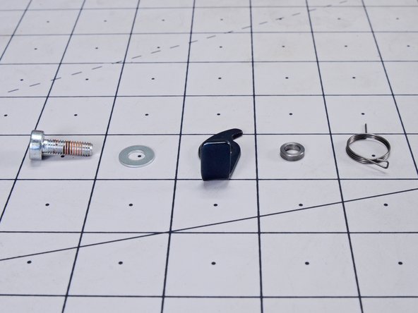

  24. Echo Chain Saw CS590 2019 Ignition Assembly Replacement, Starter pawl assembly information: crwdns2935265:024crwdnd2935265:01crwdnd2935265:02crwdne2935265:0 Echo Chain Saw CS590 2019 Ignition Assembly Replacement, Starter pawl assembly information: crwdns2935265:024crwdnd2935265:02crwdnd2935265:02crwdne2935265:0
    • During reassembly, be sure to reinstall the starter pawl assembly top to bottom in the following order:
    • 16 mm screw
    • Washer
    • Starter Pawl
    • Spacer
    • Torsion Spring

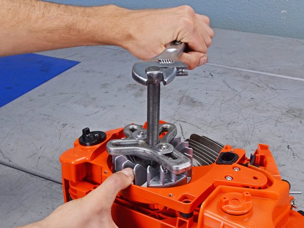

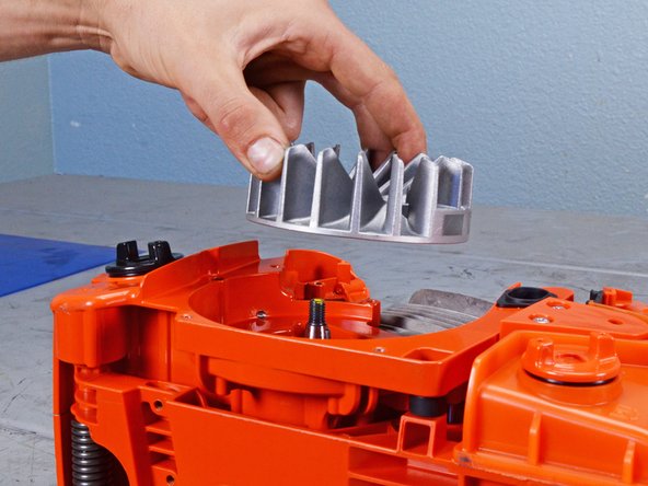

  25. Echo Chain Saw CS590 2019 Ignition Assembly Replacement, Unfasten the flywheel: crwdns2935265:025crwdnd2935265:01crwdnd2935265:02crwdne2935265:0 Echo Chain Saw CS590 2019 Ignition Assembly Replacement, Unfasten the flywheel: crwdns2935265:025crwdnd2935265:02crwdnd2935265:02crwdne2935265:0
    • Use a flywheel puller to disconnect the flywheel from the woodruff key.

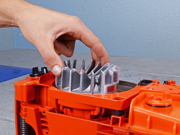

  26. Echo Chain Saw CS590 2019 Ignition Assembly Replacement, Remove the flywheel: crwdns2935265:026crwdnd2935265:01crwdnd2935265:03crwdne2935265:0 Echo Chain Saw CS590 2019 Ignition Assembly Replacement, Remove the flywheel: crwdns2935265:026crwdnd2935265:02crwdnd2935265:03crwdne2935265:0 Echo Chain Saw CS590 2019 Ignition Assembly Replacement, Remove the flywheel: crwdns2935265:026crwdnd2935265:03crwdnd2935265:03crwdne2935265:0
    • Pull the flywheel straight off of the crankshaft and remove it.

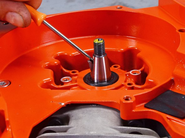

  27. Echo Chain Saw CS590 2019 Ignition Assembly Replacement, Remove the woodruff key: crwdns2935265:027crwdnd2935265:01crwdnd2935265:02crwdne2935265:0 Echo Chain Saw CS590 2019 Ignition Assembly Replacement, Remove the woodruff key: crwdns2935265:027crwdnd2935265:02crwdnd2935265:02crwdne2935265:0
    • Insert a flathead screwdriver into the gap at the top of the woodruff key.
    • Pry with the screwdriver to separate the key from the crankshaft.
  28. Echo Chain Saw CS590 2019 Ignition Assembly Replacement: crwdns2935265:028crwdnd2935265:01crwdnd2935265:01crwdne2935265:0
    • Use pliers, or your fingers, to remove the woodruff key.
    • During reassembly, be sure to reinsert the woodruff key with the flat side facing outward.
