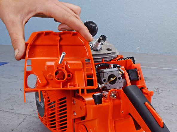

  5. Echo Chain Saw CS590 2019 Carburetor Replacement, Remove the air filter: crwdns2935265:05crwdnd2935265:01crwdnd2935265:03crwdne2935265:0 Echo Chain Saw CS590 2019 Carburetor Replacement, Remove the air filter: crwdns2935265:05crwdnd2935265:02crwdnd2935265:03crwdne2935265:0 Echo Chain Saw CS590 2019 Carburetor Replacement, Remove the air filter: crwdns2935265:05crwdnd2935265:03crwdnd2935265:03crwdne2935265:0
    • To minimize debris entering the intake, pull the choke shut before continuing.
    • Remove the air filter
    • During reassembly, clean the air filter with compressed air or with light brushing before reinstalling it.

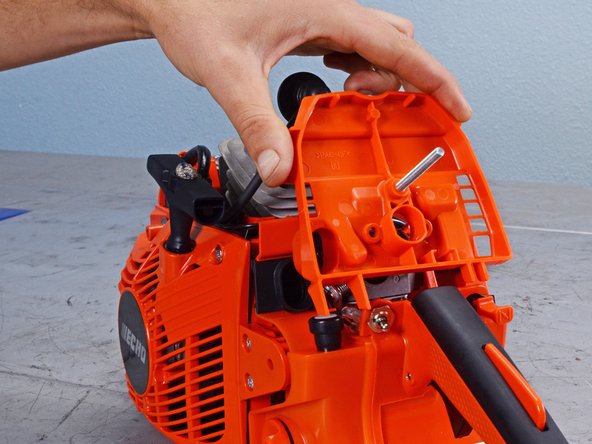

  11. Echo Chain Saw CS590 2019 Carburetor Replacement, Unfasten the front hand guard: crwdns2935265:011crwdnd2935265:01crwdnd2935265:02crwdne2935265:0 Echo Chain Saw CS590 2019 Carburetor Replacement, Unfasten the front hand guard: crwdns2935265:011crwdnd2935265:02crwdnd2935265:02crwdne2935265:0
    • Make sure the front hand guard is in the unlocked position before continuing.
    • Use a T25 Torx screwdriver to remove the two 20 mm screws securing the front hand guard.

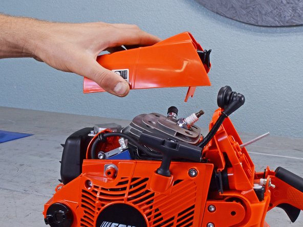

  12. Echo Chain Saw CS590 2019 Carburetor Replacement, Remove the front hand guard: crwdns2935265:012crwdnd2935265:01crwdnd2935265:02crwdne2935265:0 Echo Chain Saw CS590 2019 Carburetor Replacement, Remove the front hand guard: crwdns2935265:012crwdnd2935265:02crwdnd2935265:02crwdne2935265:0
    • Pull the front hand guard toward the rear of the device to remove it.

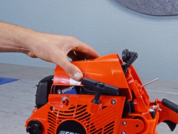

  13. Echo Chain Saw CS590 2019 Carburetor Replacement, Unfasten the engine cover: crwdns2935265:013crwdnd2935265:01crwdnd2935265:02crwdne2935265:0 Echo Chain Saw CS590 2019 Carburetor Replacement, Unfasten the engine cover: crwdns2935265:013crwdnd2935265:02crwdnd2935265:02crwdne2935265:0
    • Use a T25 Torx screwdriver to remove the three 20 mm screws securing the engine cover.
  14. Echo Chain Saw CS590 2019 Carburetor Replacement, Remove the engine cover: crwdns2935265:014crwdnd2935265:01crwdnd2935265:03crwdne2935265:0 Echo Chain Saw CS590 2019 Carburetor Replacement, Remove the engine cover: crwdns2935265:014crwdnd2935265:02crwdnd2935265:03crwdne2935265:0 Echo Chain Saw CS590 2019 Carburetor Replacement, Remove the engine cover: crwdns2935265:014crwdnd2935265:03crwdnd2935265:03crwdne2935265:0
    • Pull the engine cover straight off the device to remove it.

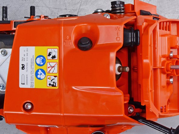

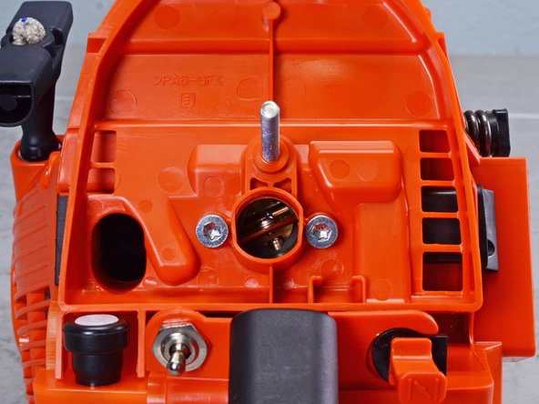

  15. Echo Chain Saw CS590 2019 Carburetor Replacement, Unfasten the carburetor cover: crwdns2935265:015crwdnd2935265:01crwdnd2935265:02crwdne2935265:0 Echo Chain Saw CS590 2019 Carburetor Replacement, Unfasten the carburetor cover: crwdns2935265:015crwdnd2935265:02crwdnd2935265:02crwdne2935265:0
    • Use a T25 Torx screwdriver to remove the two 54 mm screws securing the carburetor cover.
  16. Echo Chain Saw CS590 2019 Carburetor Replacement, Remove the carburetor cover: crwdns2935265:016crwdnd2935265:01crwdnd2935265:03crwdne2935265:0 Echo Chain Saw CS590 2019 Carburetor Replacement, Remove the carburetor cover: crwdns2935265:016crwdnd2935265:02crwdnd2935265:03crwdne2935265:0 Echo Chain Saw CS590 2019 Carburetor Replacement, Remove the carburetor cover: crwdns2935265:016crwdnd2935265:03crwdnd2935265:03crwdne2935265:0
    • Pull the carburetor cover straight off its housing to remove it.

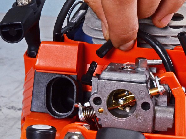

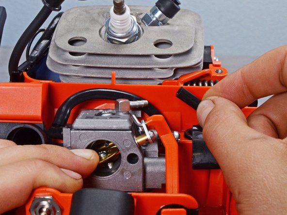

  17. Echo Chain Saw CS590 2019 Carburetor Replacement, Disconnect the carburetor: crwdns2935265:017crwdnd2935265:01crwdnd2935265:03crwdne2935265:0 Echo Chain Saw CS590 2019 Carburetor Replacement, Disconnect the carburetor: crwdns2935265:017crwdnd2935265:02crwdnd2935265:03crwdne2935265:0 Echo Chain Saw CS590 2019 Carburetor Replacement, Disconnect the carburetor: crwdns2935265:017crwdnd2935265:03crwdnd2935265:03crwdne2935265:0
    • Before performing this step, put on safety glasses to avoid any fuel spraying in your eyes.
    • Use your fingers to pull the right fuel pipe out of the carburetor.
    • Repeat the same procedure for the left fuel pipe.

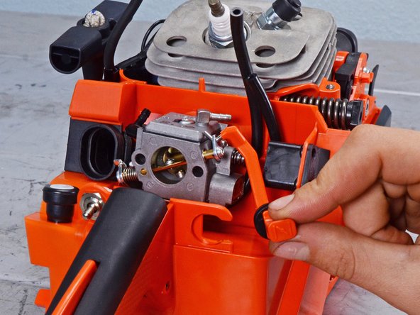

  18. Echo Chain Saw CS590 2019 Carburetor Replacement: crwdns2935265:018crwdnd2935265:01crwdnd2935265:03crwdne2935265:0 Echo Chain Saw CS590 2019 Carburetor Replacement: crwdns2935265:018crwdnd2935265:02crwdnd2935265:03crwdne2935265:0 Echo Chain Saw CS590 2019 Carburetor Replacement: crwdns2935265:018crwdnd2935265:03crwdnd2935265:03crwdne2935265:0
    • Pull the choke lever through its bracket to separate it from the frame.
    • Twist the lever counter-clockwise to disconnect its clip on the carburetor.
    • Remove the choke lever.

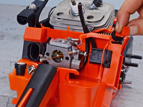

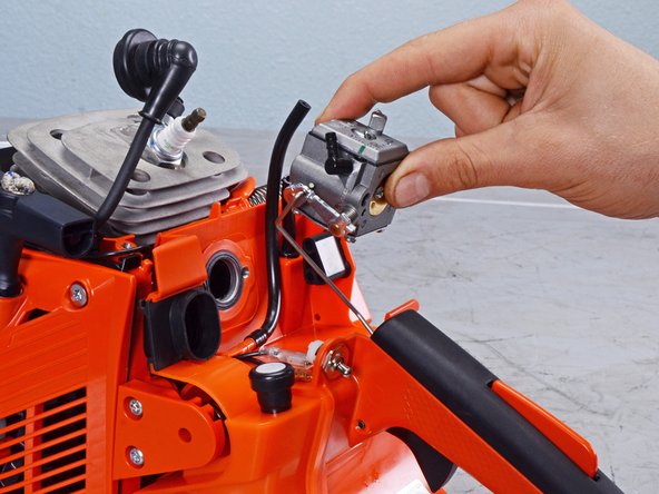

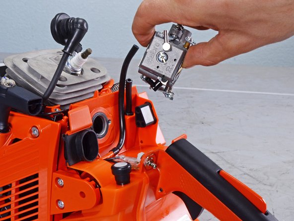

  19. Echo Chain Saw CS590 2019 Carburetor Replacement, Remove the carburetor: crwdns2935265:019crwdnd2935265:01crwdnd2935265:03crwdne2935265:0 Echo Chain Saw CS590 2019 Carburetor Replacement, Remove the carburetor: crwdns2935265:019crwdnd2935265:02crwdnd2935265:03crwdne2935265:0 Echo Chain Saw CS590 2019 Carburetor Replacement, Remove the carburetor: crwdns2935265:019crwdnd2935265:03crwdnd2935265:03crwdne2935265:0
    • Lift the carburetor out of its housing.
    • Twist the carburetor counter-clockwise to disconnect the throttle rod's metal clip.
    • Remove the carburetor.
