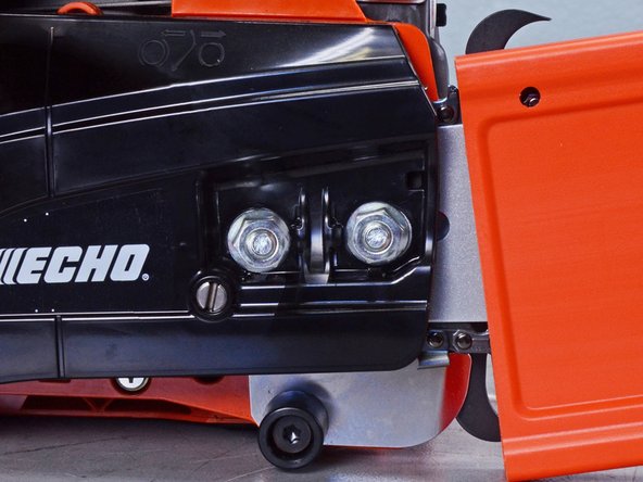

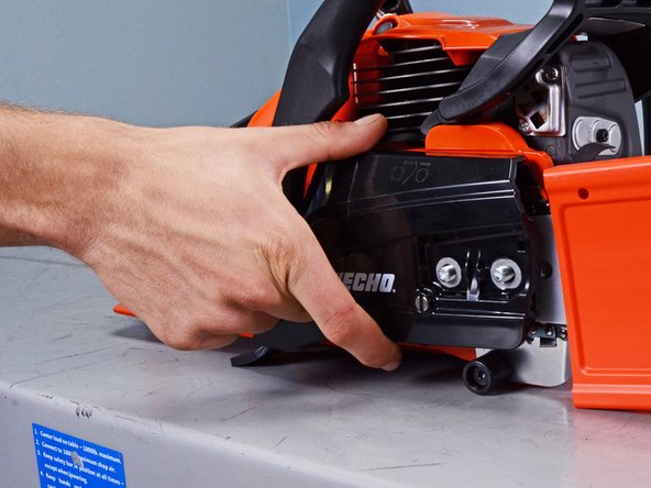

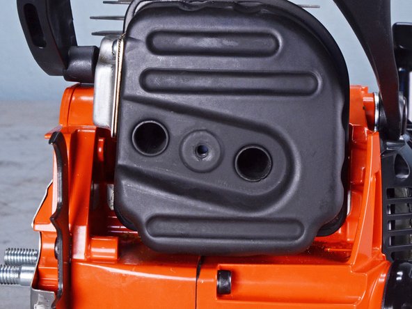

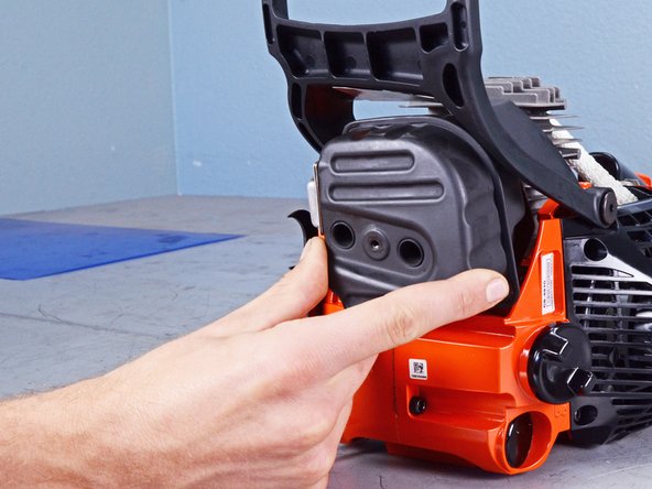

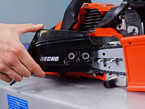

  6. Echo Chain Saw CS4910 2020 Piston Assembly Replacement, Loosen the sprocket guard: crwdns2935265:06crwdnd2935265:01crwdnd2935265:02crwdne2935265:0 Echo Chain Saw CS4910 2020 Piston Assembly Replacement, Loosen the sprocket guard: crwdns2935265:06crwdnd2935265:02crwdnd2935265:02crwdne2935265:0
    • Use a 13 mm wrench to loosen and remove the two nuts securing the sprocket guard.
  7. Echo Chain Saw CS4910 2020 Piston Assembly Replacement, Remove the sprocket guard: crwdns2935265:07crwdnd2935265:01crwdnd2935265:03crwdne2935265:0 Echo Chain Saw CS4910 2020 Piston Assembly Replacement, Remove the sprocket guard: crwdns2935265:07crwdnd2935265:02crwdnd2935265:03crwdne2935265:0 Echo Chain Saw CS4910 2020 Piston Assembly Replacement, Remove the sprocket guard: crwdns2935265:07crwdnd2935265:03crwdnd2935265:03crwdne2935265:0
    • Pull the sprocket guard straight off its two pegs and remove it.

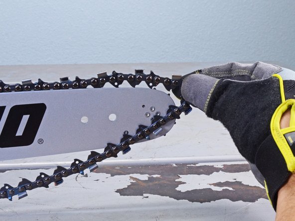

  8. Echo Chain Saw CS4910 2020 Piston Assembly Replacement, Unclip the saw chain: crwdns2935265:08crwdnd2935265:01crwdnd2935265:02crwdne2935265:0 Echo Chain Saw CS4910 2020 Piston Assembly Replacement, Unclip the saw chain: crwdns2935265:08crwdnd2935265:02crwdnd2935265:02crwdne2935265:0
    • Put on gloves before performing the next two steps.
    • Pull the saw chain away from the tip of the guide bar to unclip it.

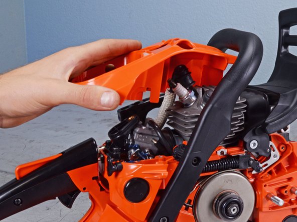

  11. Echo Chain Saw CS4910 2020 Piston Assembly Replacement, Remove the engine cover: crwdns2935265:011crwdnd2935265:01crwdnd2935265:03crwdne2935265:0 Echo Chain Saw CS4910 2020 Piston Assembly Replacement, Remove the engine cover: crwdns2935265:011crwdnd2935265:02crwdnd2935265:03crwdne2935265:0 Echo Chain Saw CS4910 2020 Piston Assembly Replacement, Remove the engine cover: crwdns2935265:011crwdnd2935265:03crwdnd2935265:03crwdne2935265:0
    • Pull the engine cover straight up off the engine.
    • Remove the engine cover.

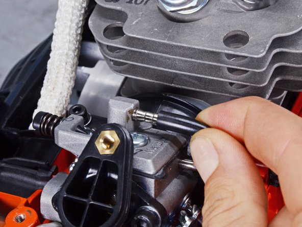

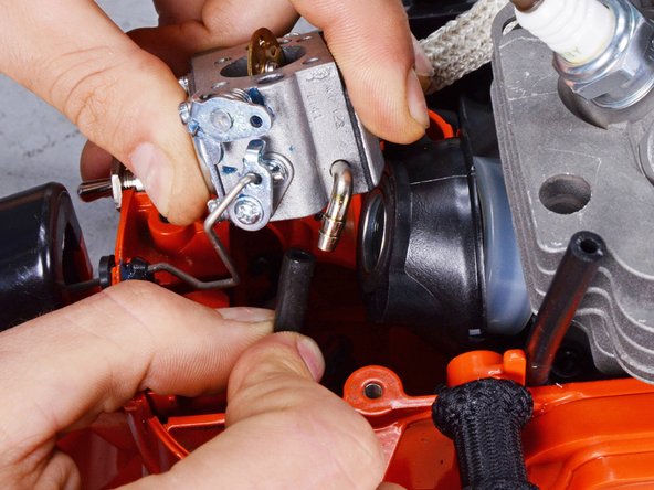

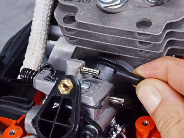

  12. Echo Chain Saw CS4910 2020 Piston Assembly Replacement, Disconnect the carburetor: crwdns2935265:012crwdnd2935265:01crwdnd2935265:03crwdne2935265:0 Echo Chain Saw CS4910 2020 Piston Assembly Replacement, Disconnect the carburetor: crwdns2935265:012crwdnd2935265:02crwdnd2935265:03crwdne2935265:0 Echo Chain Saw CS4910 2020 Piston Assembly Replacement, Disconnect the carburetor: crwdns2935265:012crwdnd2935265:03crwdnd2935265:03crwdne2935265:0
    • Before performing this step, put on safety glasses to avoid any fuel spraying in your eyes.
    • Use your fingers to pull the top-most fuel pipe out of the carburetor.

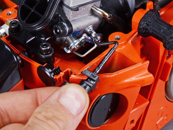

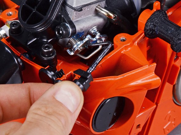

  13. Echo Chain Saw CS4910 2020 Piston Assembly Replacement: crwdns2935265:013crwdnd2935265:01crwdnd2935265:03crwdne2935265:0 Echo Chain Saw CS4910 2020 Piston Assembly Replacement: crwdns2935265:013crwdnd2935265:02crwdnd2935265:03crwdne2935265:0 Echo Chain Saw CS4910 2020 Piston Assembly Replacement: crwdns2935265:013crwdnd2935265:03crwdnd2935265:03crwdne2935265:0
    • Lift the choke rod out of its recess in the chassis.
    • Twist the rod counter-clockwise to disconnect it from the carburetor.
    • Remove the choke rod.

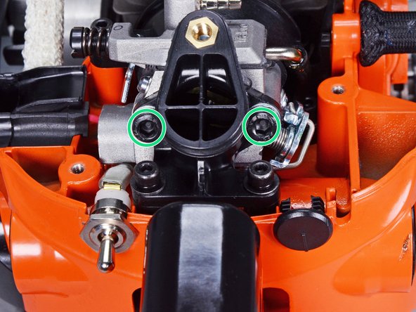

  14. Echo Chain Saw CS4910 2020 Piston Assembly Replacement, Unfasten the carburetor: crwdns2935265:014crwdnd2935265:01crwdnd2935265:02crwdne2935265:0 Echo Chain Saw CS4910 2020 Piston Assembly Replacement, Unfasten the carburetor: crwdns2935265:014crwdnd2935265:02crwdnd2935265:02crwdne2935265:0
    • Remove the four screws securing the carburetor and the air filter adapter:
    • Use a 3 mm hex key to remove the two 20 mm-long screws.
    • Use a 4 mm hex key to remove the two 53 mm-long screws.

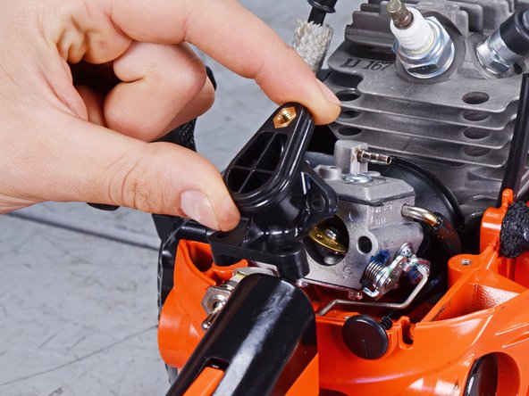

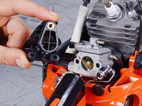

  15. Echo Chain Saw CS4910 2020 Piston Assembly Replacement, Remove the air filter adapter: crwdns2935265:015crwdnd2935265:01crwdnd2935265:03crwdne2935265:0 Echo Chain Saw CS4910 2020 Piston Assembly Replacement, Remove the air filter adapter: crwdns2935265:015crwdnd2935265:02crwdnd2935265:03crwdne2935265:0 Echo Chain Saw CS4910 2020 Piston Assembly Replacement, Remove the air filter adapter: crwdns2935265:015crwdnd2935265:03crwdnd2935265:03crwdne2935265:0
    • Pull the air filter adapter straight off the carburetor and remove it.

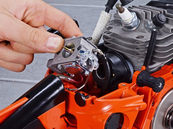

  16. Echo Chain Saw CS4910 2020 Piston Assembly Replacement, Reposition the carburetor: crwdns2935265:016crwdnd2935265:01crwdnd2935265:02crwdne2935265:0 Echo Chain Saw CS4910 2020 Piston Assembly Replacement, Reposition the carburetor: crwdns2935265:016crwdnd2935265:02crwdnd2935265:02crwdne2935265:0
    • With the carburetor's choke valve facing you, tilt the carburetor up and to the left to expose the right-most fuel pipe.
  17. Echo Chain Saw CS4910 2020 Piston Assembly Replacement, Disconnect the right fuel pipe: crwdns2935265:017crwdnd2935265:01crwdnd2935265:02crwdne2935265:0 Echo Chain Saw CS4910 2020 Piston Assembly Replacement, Disconnect the right fuel pipe: crwdns2935265:017crwdnd2935265:02crwdnd2935265:02crwdne2935265:0
    • Use your fingers to disconnect the right-most fuel pipe.
  18. Echo Chain Saw CS4910 2020 Piston Assembly Replacement, Remove the carburetor: crwdns2935265:018crwdnd2935265:01crwdnd2935265:02crwdne2935265:0 Echo Chain Saw CS4910 2020 Piston Assembly Replacement, Remove the carburetor: crwdns2935265:018crwdnd2935265:02crwdnd2935265:02crwdne2935265:0
    • Lift the carburetor straight off the throttle rod and remove it.
    • Realign throttle rod upon reassembly.

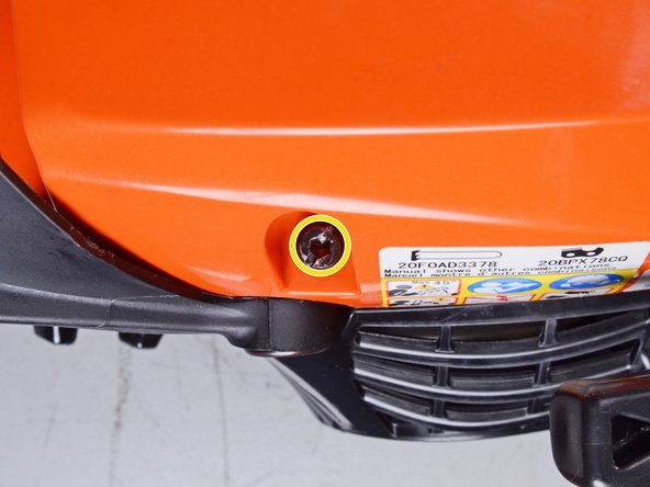

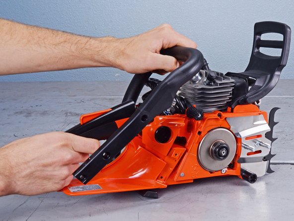

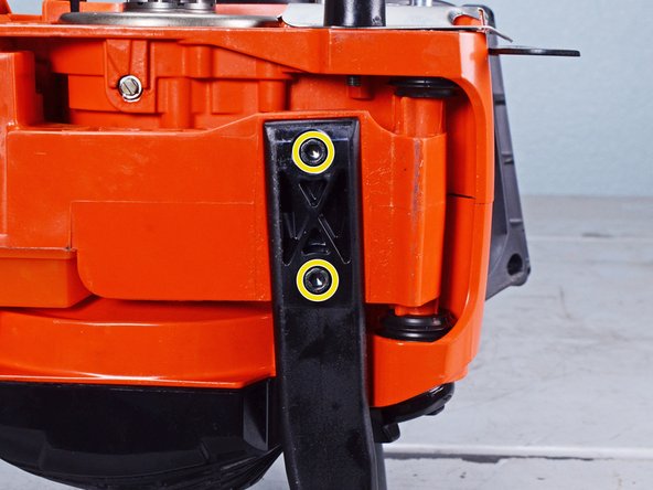

  19. Echo Chain Saw CS4910 2020 Piston Assembly Replacement, Unfasten the handle: crwdns2935265:019crwdnd2935265:01crwdnd2935265:02crwdne2935265:0 Echo Chain Saw CS4910 2020 Piston Assembly Replacement, Unfasten the handle: crwdns2935265:019crwdnd2935265:02crwdnd2935265:02crwdne2935265:0
    • Remove the five screws securing the handle:
    • Use a 4 mm hex key to remove the four 24 mm-long screws (on the side and bottom).
    • Use a 3 mm hex key to remove the 18 mm-long screw.

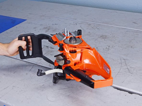

  20. Echo Chain Saw CS4910 2020 Piston Assembly Replacement, Remove the handle: crwdns2935265:020crwdnd2935265:01crwdnd2935265:03crwdne2935265:0 Echo Chain Saw CS4910 2020 Piston Assembly Replacement, Remove the handle: crwdns2935265:020crwdnd2935265:02crwdnd2935265:03crwdne2935265:0 Echo Chain Saw CS4910 2020 Piston Assembly Replacement, Remove the handle: crwdns2935265:020crwdnd2935265:03crwdnd2935265:03crwdne2935265:0
    • Pull the handle towards the rear of the device to remove it.

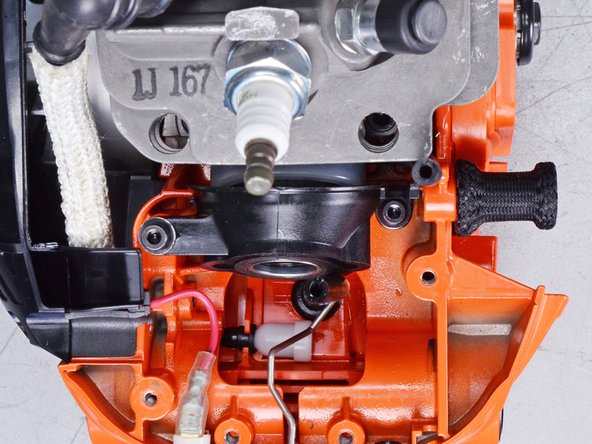

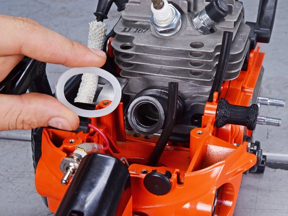

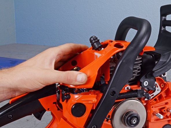

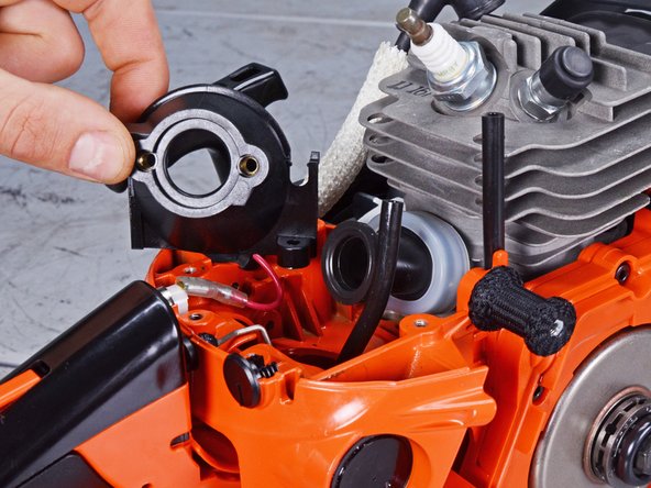

  21. Echo Chain Saw CS4910 2020 Piston Assembly Replacement, Unfasten the intake insulator: crwdns2935265:021crwdnd2935265:01crwdnd2935265:02crwdne2935265:0 Echo Chain Saw CS4910 2020 Piston Assembly Replacement, Unfasten the intake insulator: crwdns2935265:021crwdnd2935265:02crwdnd2935265:02crwdne2935265:0
    • Use a 3 mm hex key to remove the two 20 mm-long screws securing the intake insulator.

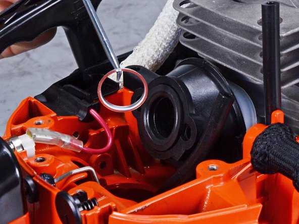

  22. Echo Chain Saw CS4910 2020 Piston Assembly Replacement, Remove the collar: crwdns2935265:022crwdnd2935265:01crwdnd2935265:02crwdne2935265:0 Echo Chain Saw CS4910 2020 Piston Assembly Replacement, Remove the collar: crwdns2935265:022crwdnd2935265:02crwdnd2935265:02crwdne2935265:0
    • Use a pick tool to remove the insulator intake collar.

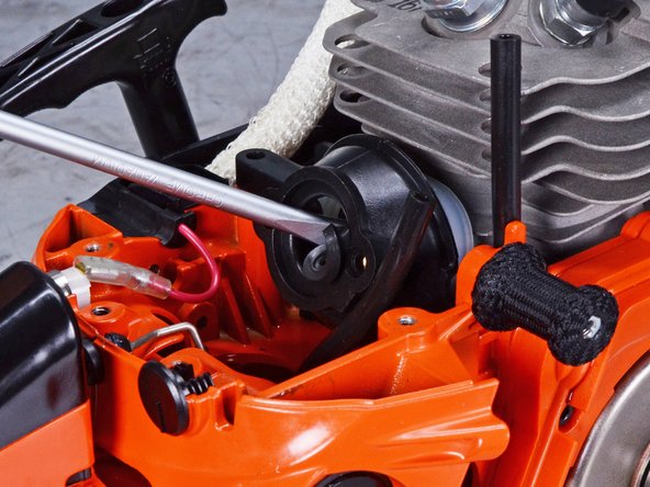

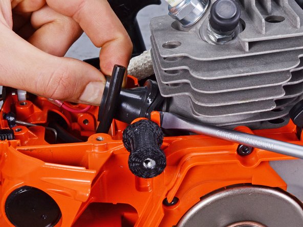

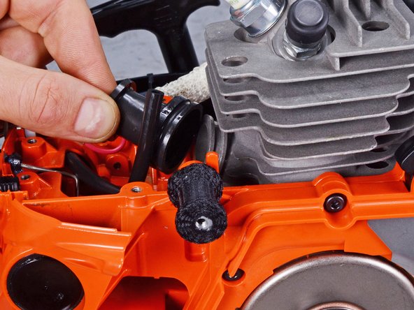

  23. Echo Chain Saw CS4910 2020 Piston Assembly Replacement, Reposition the intake bellows: crwdns2935265:023crwdnd2935265:01crwdnd2935265:02crwdne2935265:0 Echo Chain Saw CS4910 2020 Piston Assembly Replacement, Reposition the intake bellows: crwdns2935265:023crwdnd2935265:02crwdnd2935265:02crwdne2935265:0
    • Use a flathead screwdriver to fold the lip of the intake bellows inside the intake insulator.
  24. Echo Chain Saw CS4910 2020 Piston Assembly Replacement, Remove the intake insulator: crwdns2935265:024crwdnd2935265:01crwdnd2935265:02crwdne2935265:0 Echo Chain Saw CS4910 2020 Piston Assembly Replacement, Remove the intake insulator: crwdns2935265:024crwdnd2935265:02crwdnd2935265:02crwdne2935265:0
    • Lift the intake insulator out of its recess and remove it.

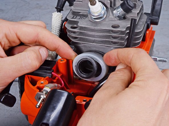

  25. Echo Chain Saw CS4910 2020 Piston Assembly Replacement, Remove the bellows holder: crwdns2935265:025crwdnd2935265:01crwdnd2935265:03crwdne2935265:0 Echo Chain Saw CS4910 2020 Piston Assembly Replacement, Remove the bellows holder: crwdns2935265:025crwdnd2935265:02crwdnd2935265:03crwdne2935265:0 Echo Chain Saw CS4910 2020 Piston Assembly Replacement, Remove the bellows holder: crwdns2935265:025crwdnd2935265:03crwdnd2935265:03crwdne2935265:0
    • Slide the bellows holder off the intake bellows and remove it.
  26. Echo Chain Saw CS4910 2020 Piston Assembly Replacement, Remove the intake bellows: crwdns2935265:026crwdnd2935265:01crwdnd2935265:03crwdne2935265:0 Echo Chain Saw CS4910 2020 Piston Assembly Replacement, Remove the intake bellows: crwdns2935265:026crwdnd2935265:02crwdnd2935265:03crwdne2935265:0 Echo Chain Saw CS4910 2020 Piston Assembly Replacement, Remove the intake bellows: crwdns2935265:026crwdnd2935265:03crwdnd2935265:03crwdne2935265:0
    • Insert a flathead screwdriver between the intake bellows and the cylinder head.
    • Pry with the screwdriver to separate the intake bellows from the cylinder head.
    • Remove the intake bellows.

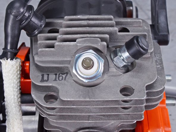

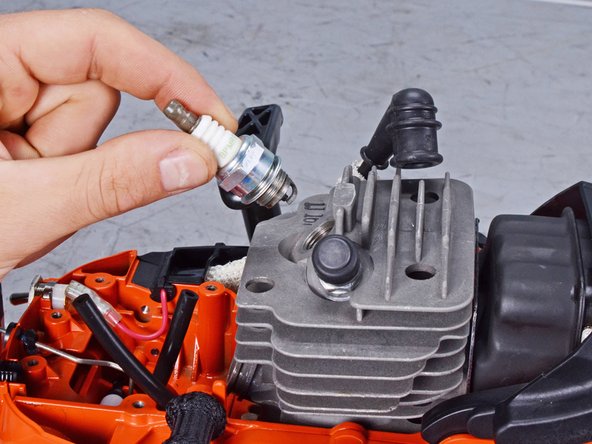

  27. Echo Chain Saw CS4910 2020 Piston Assembly Replacement, Loosen the spark plug: crwdns2935265:027crwdnd2935265:01crwdnd2935265:02crwdne2935265:0 Echo Chain Saw CS4910 2020 Piston Assembly Replacement, Loosen the spark plug: crwdns2935265:027crwdnd2935265:02crwdnd2935265:02crwdne2935265:0
    • Use a spark plug socket wrench to loosen the spark plug.
  28. Echo Chain Saw CS4910 2020 Piston Assembly Replacement, Remove the spark plug: crwdns2935265:028crwdnd2935265:01crwdnd2935265:02crwdne2935265:0 Echo Chain Saw CS4910 2020 Piston Assembly Replacement, Remove the spark plug: crwdns2935265:028crwdnd2935265:02crwdnd2935265:02crwdne2935265:0
    • Pull the spark plug straight out of the cylinder head and remove it.

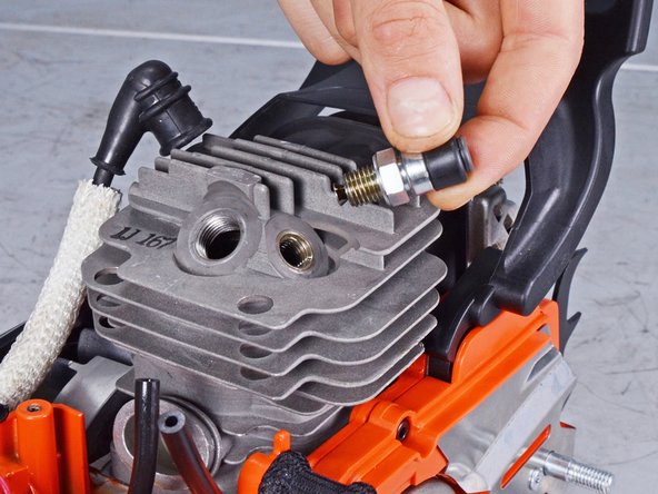

  29. Echo Chain Saw CS4910 2020 Piston Assembly Replacement, Loosen the decompression valve assembly: crwdns2935265:029crwdnd2935265:01crwdnd2935265:02crwdne2935265:0 Echo Chain Saw CS4910 2020 Piston Assembly Replacement, Loosen the decompression valve assembly: crwdns2935265:029crwdnd2935265:02crwdnd2935265:02crwdne2935265:0
    • Use a 9/16 inch wrench to loosen the decompression valve assembly.
  30. Echo Chain Saw CS4910 2020 Piston Assembly Replacement, Remove the decompression valve assembly: crwdns2935265:030crwdnd2935265:01crwdnd2935265:02crwdne2935265:0 Echo Chain Saw CS4910 2020 Piston Assembly Replacement, Remove the decompression valve assembly: crwdns2935265:030crwdnd2935265:02crwdnd2935265:02crwdne2935265:0
    • Pull the decompression valve assembly straight out of the cylinder head and remove it.

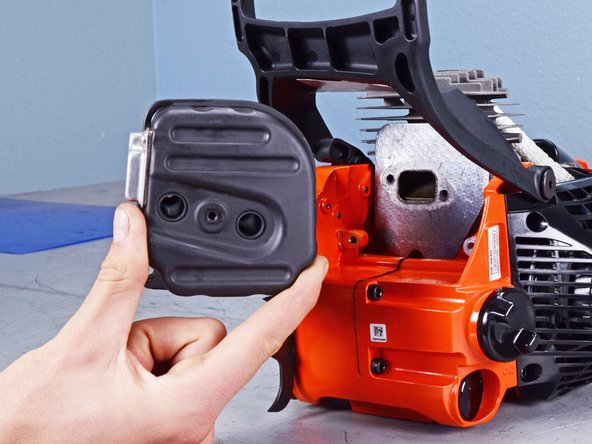

  31. Echo Chain Saw CS4910 2020 Piston Assembly Replacement, Unfasten the muffler: crwdns2935265:031crwdnd2935265:01crwdnd2935265:01crwdne2935265:0
    • Use a 4 mm hex key to remove the two 23 mm-long screws securing the muffler.
    • Use a 3 mm hex key to remove the 10 mm-long screw securing the muffler plate.
  32. Echo Chain Saw CS4910 2020 Piston Assembly Replacement: crwdns2935265:032crwdnd2935265:01crwdnd2935265:01crwdne2935265:0
    • Remove the muffler plate.
  33. Echo Chain Saw CS4910 2020 Piston Assembly Replacement: crwdns2935265:033crwdnd2935265:01crwdnd2935265:02crwdne2935265:0 Echo Chain Saw CS4910 2020 Piston Assembly Replacement: crwdns2935265:033crwdnd2935265:02crwdnd2935265:02crwdne2935265:0
  34. Echo Chain Saw CS4910 2020 Piston Assembly Replacement, Remove the muffler: crwdns2935265:034crwdnd2935265:01crwdnd2935265:03crwdne2935265:0 Echo Chain Saw CS4910 2020 Piston Assembly Replacement, Remove the muffler: crwdns2935265:034crwdnd2935265:02crwdnd2935265:03crwdne2935265:0 Echo Chain Saw CS4910 2020 Piston Assembly Replacement, Remove the muffler: crwdns2935265:034crwdnd2935265:03crwdnd2935265:03crwdne2935265:0
    • Pull the muffler straight out of its recess and remove it.

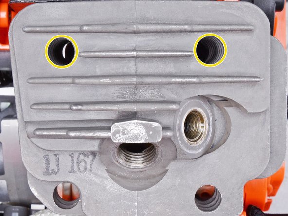

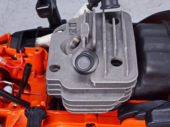

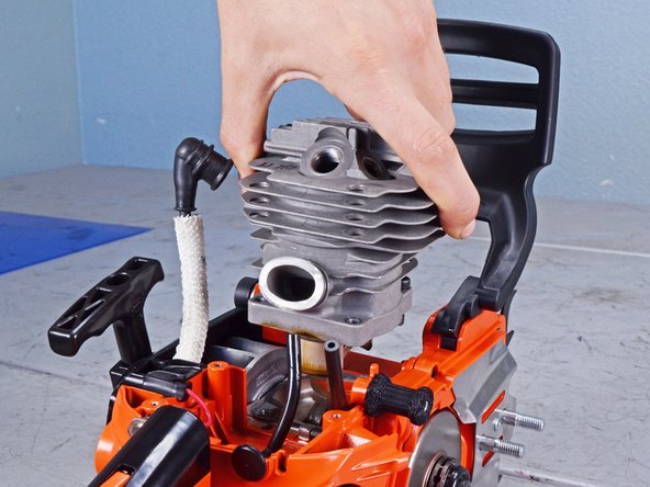

  36. Echo Chain Saw CS4910 2020 Piston Assembly Replacement, Unfasten the cylinder head: crwdns2935265:036crwdnd2935265:01crwdnd2935265:02crwdne2935265:0 Echo Chain Saw CS4910 2020 Piston Assembly Replacement, Unfasten the cylinder head: crwdns2935265:036crwdnd2935265:02crwdnd2935265:02crwdne2935265:0
    • Use a 4 mm hex key to remove the four 25 mm-long screws securing the cylinder head.

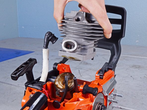

  37. Echo Chain Saw CS4910 2020 Piston Assembly Replacement, Remove the cylinder head: crwdns2935265:037crwdnd2935265:01crwdnd2935265:03crwdne2935265:0 Echo Chain Saw CS4910 2020 Piston Assembly Replacement, Remove the cylinder head: crwdns2935265:037crwdnd2935265:02crwdnd2935265:03crwdne2935265:0 Echo Chain Saw CS4910 2020 Piston Assembly Replacement, Remove the cylinder head: crwdns2935265:037crwdnd2935265:03crwdnd2935265:03crwdne2935265:0
    • Lift the cylinder head away from the chassis to expose the piston.
    • Remove the cylinder head.
    • During reassembly, perform the following:
    • Make sure the two black piston rings are aligned in their grooves so the piston can compress properly in the cylinder head.
    • Apply two-stroke oil to the piston head and the cylinder walls before reinserting the piston.

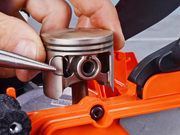

  38. Echo Chain Saw CS4910 2020 Piston Assembly Replacement, Remove the snap rings: crwdns2935265:038crwdnd2935265:01crwdnd2935265:02crwdne2935265:0 Echo Chain Saw CS4910 2020 Piston Assembly Replacement, Remove the snap rings: crwdns2935265:038crwdnd2935265:02crwdnd2935265:02crwdne2935265:0
    • Use snap ring pliers, or a flathead screwdriver, to remove one of the piston snap rings.
    • Repeat this procedure for the snap ring on the opposite side of the piston.

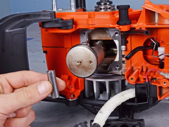

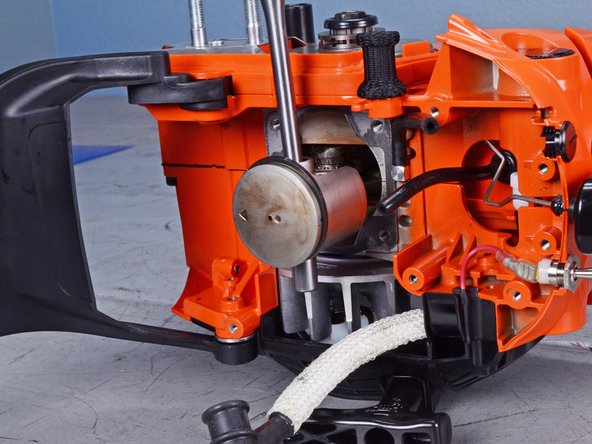

  40. Echo Chain Saw CS4910 2020 Piston Assembly Replacement, Remove the piston pin: crwdns2935265:040crwdnd2935265:01crwdnd2935265:03crwdne2935265:0 Echo Chain Saw CS4910 2020 Piston Assembly Replacement, Remove the piston pin: crwdns2935265:040crwdnd2935265:02crwdnd2935265:03crwdne2935265:0 Echo Chain Saw CS4910 2020 Piston Assembly Replacement, Remove the piston pin: crwdns2935265:040crwdnd2935265:03crwdnd2935265:03crwdne2935265:0
    • Grip the bottom of the piston.
    • Use a hammer and a pin punch to tap the piston pin through its recess.
    • The piston swings freely on the crankshaft. Be sure to stabilize the piston with your hand as you tap on the pin punch.
    • Alternatively, you can use a piston support tool or a block of wood to keep the piston steady.
    • Remove the piston pin.

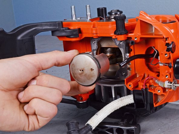

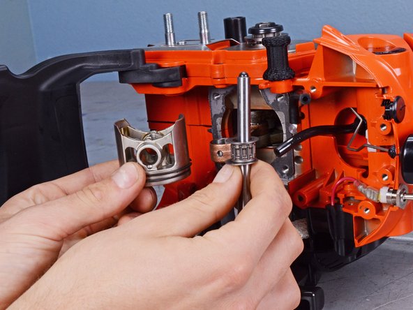

  41. Echo Chain Saw CS4910 2020 Piston Assembly Replacement, Remove the piston assembly: crwdns2935265:041crwdnd2935265:01crwdnd2935265:03crwdne2935265:0 Echo Chain Saw CS4910 2020 Piston Assembly Replacement, Remove the piston assembly: crwdns2935265:041crwdnd2935265:02crwdnd2935265:03crwdne2935265:0 Echo Chain Saw CS4910 2020 Piston Assembly Replacement, Remove the piston assembly: crwdns2935265:041crwdnd2935265:03crwdnd2935265:03crwdne2935265:0
    • Pull the piston off of the piston rod to disconnect it from the crankshaft.
    • Remove the piston, its needle bearing, and the two washers.

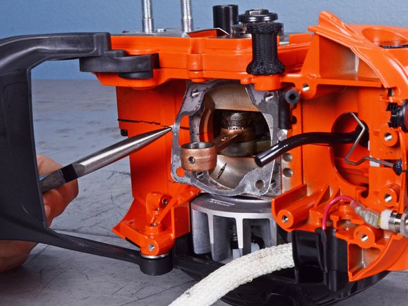

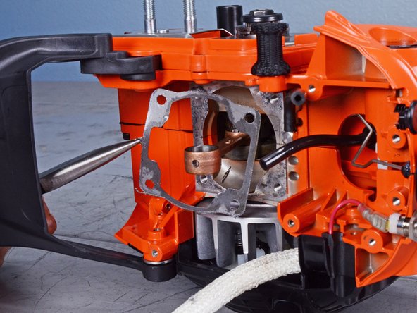

  42. Echo Chain Saw CS4910 2020 Piston Assembly Replacement, Remove the cylinder gasket: crwdns2935265:042crwdnd2935265:01crwdnd2935265:03crwdne2935265:0 Echo Chain Saw CS4910 2020 Piston Assembly Replacement, Remove the cylinder gasket: crwdns2935265:042crwdnd2935265:02crwdnd2935265:03crwdne2935265:0 Echo Chain Saw CS4910 2020 Piston Assembly Replacement, Remove the cylinder gasket: crwdns2935265:042crwdnd2935265:03crwdnd2935265:03crwdne2935265:0
    • Use a pair of pliers to remove the cylinder head gasket from the crankcase.
    • During reassembly, make sure to replace the gasket with a new one.
