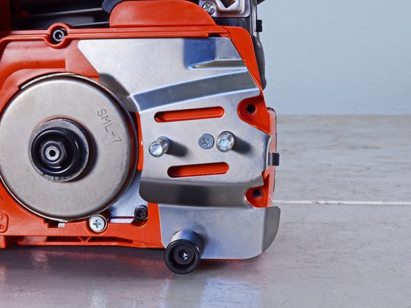

  6. Echo Chain Saw CS4910 2020 Oiler System Replacement, Loosen the sprocket guard: crwdns2935265:06crwdnd2935265:01crwdnd2935265:02crwdne2935265:0 Echo Chain Saw CS4910 2020 Oiler System Replacement, Loosen the sprocket guard: crwdns2935265:06crwdnd2935265:02crwdnd2935265:02crwdne2935265:0
    • Use a 13 mm wrench to loosen and remove the two nuts securing the sprocket guard.
  7. Echo Chain Saw CS4910 2020 Oiler System Replacement, Remove the sprocket guard: crwdns2935265:07crwdnd2935265:01crwdnd2935265:03crwdne2935265:0 Echo Chain Saw CS4910 2020 Oiler System Replacement, Remove the sprocket guard: crwdns2935265:07crwdnd2935265:02crwdnd2935265:03crwdne2935265:0 Echo Chain Saw CS4910 2020 Oiler System Replacement, Remove the sprocket guard: crwdns2935265:07crwdnd2935265:03crwdnd2935265:03crwdne2935265:0
    • Pull the sprocket guard straight off its two pegs and remove it.

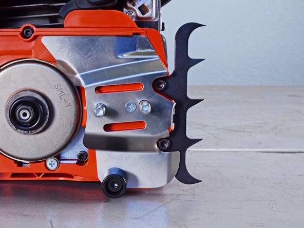

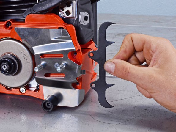

  10. Echo Chain Saw CS4910 2020 Oiler System Replacement, Unfasten the bumper spike: crwdns2935265:010crwdnd2935265:01crwdnd2935265:02crwdne2935265:0 Echo Chain Saw CS4910 2020 Oiler System Replacement, Unfasten the bumper spike: crwdns2935265:010crwdnd2935265:02crwdnd2935265:02crwdne2935265:0
    • Use a T25 Torx driver to remove the two 17 mm-long screws securing the bumper spike.
  11. Echo Chain Saw CS4910 2020 Oiler System Replacement, Remove the bumper spike: crwdns2935265:011crwdnd2935265:01crwdnd2935265:02crwdne2935265:0 Echo Chain Saw CS4910 2020 Oiler System Replacement, Remove the bumper spike: crwdns2935265:011crwdnd2935265:02crwdnd2935265:02crwdne2935265:0
    • Pull the bumper spike away from the chassis and remove it.

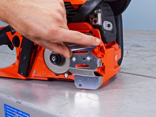

  13. Echo Chain Saw CS4910 2020 Oiler System Replacement, Remove the inner guide plate: crwdns2935265:013crwdnd2935265:01crwdnd2935265:03crwdne2935265:0 Echo Chain Saw CS4910 2020 Oiler System Replacement, Remove the inner guide plate: crwdns2935265:013crwdnd2935265:02crwdnd2935265:03crwdne2935265:0 Echo Chain Saw CS4910 2020 Oiler System Replacement, Remove the inner guide plate: crwdns2935265:013crwdnd2935265:03crwdnd2935265:03crwdne2935265:0
    • Pull the inner guide plate straight off its two pegs and remove it.

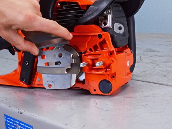

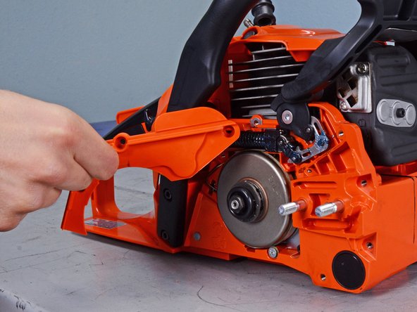

  14. Echo Chain Saw CS4910 2020 Oiler System Replacement, Unfasten the brake cover: crwdns2935265:014crwdnd2935265:01crwdnd2935265:02crwdne2935265:0 Echo Chain Saw CS4910 2020 Oiler System Replacement, Unfasten the brake cover: crwdns2935265:014crwdnd2935265:02crwdnd2935265:02crwdne2935265:0
    • Use a 2.5 mm hex key to remove the three 14 mm-long screws securing the brake cover.
  15. Echo Chain Saw CS4910 2020 Oiler System Replacement, Remove the brake cover: crwdns2935265:015crwdnd2935265:01crwdnd2935265:03crwdne2935265:0 Echo Chain Saw CS4910 2020 Oiler System Replacement, Remove the brake cover: crwdns2935265:015crwdnd2935265:02crwdnd2935265:03crwdne2935265:0 Echo Chain Saw CS4910 2020 Oiler System Replacement, Remove the brake cover: crwdns2935265:015crwdnd2935265:03crwdnd2935265:03crwdne2935265:0
    • Pull the brake cover straight off the chassis and remove it.
    • Make sure the chain brake is in the disengaged position before continuing.

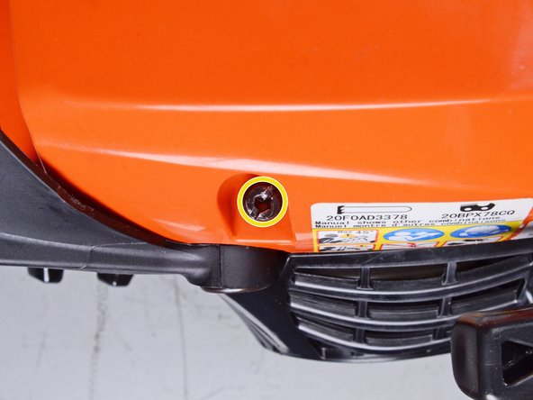

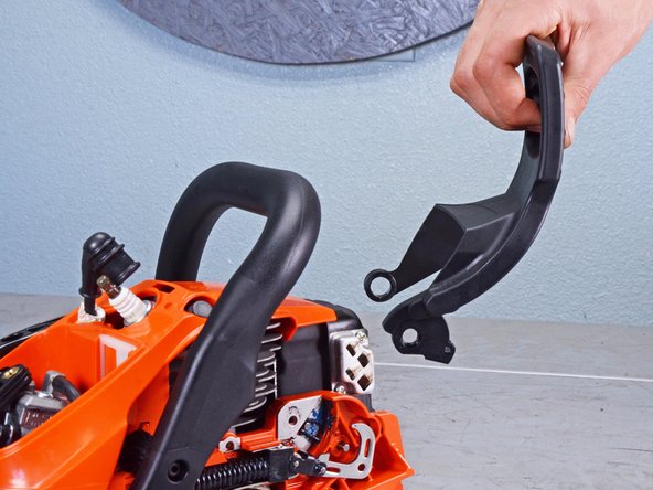

  16. Echo Chain Saw CS4910 2020 Oiler System Replacement, Unfasten the chain brake handle: crwdns2935265:016crwdnd2935265:01crwdnd2935265:02crwdne2935265:0 Echo Chain Saw CS4910 2020 Oiler System Replacement, Unfasten the chain brake handle: crwdns2935265:016crwdnd2935265:02crwdnd2935265:02crwdne2935265:0
    • Use a 4 mm hex key to remove the two screws securing the chain brake handle:
    • One 19 mm-long screw
    • One 23 mm-long screw

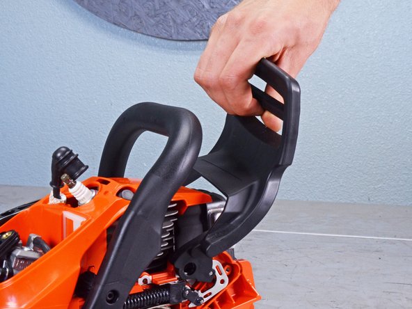

  17. Echo Chain Saw CS4910 2020 Oiler System Replacement: crwdns2935265:017crwdnd2935265:01crwdnd2935265:03crwdne2935265:0 Echo Chain Saw CS4910 2020 Oiler System Replacement: crwdns2935265:017crwdnd2935265:02crwdnd2935265:03crwdne2935265:0 Echo Chain Saw CS4910 2020 Oiler System Replacement: crwdns2935265:017crwdnd2935265:03crwdnd2935265:03crwdne2935265:0
    • Rotate the chain brake handle towards the guide bar recess to unhook the brake lever.
    • Pull the handle away from the chassis to completely remove it.

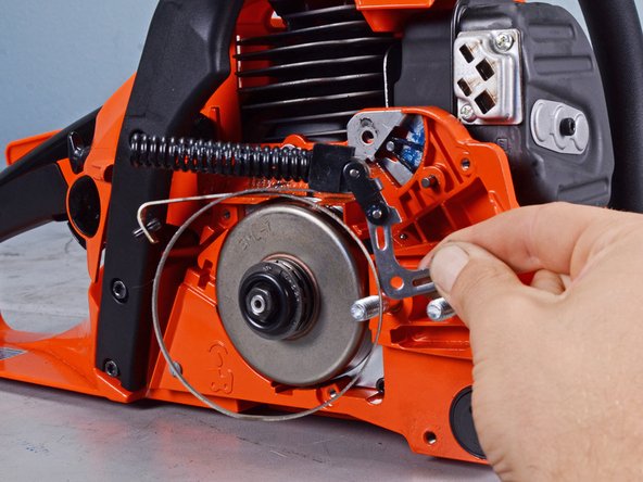

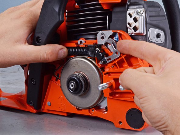

  18. Echo Chain Saw CS4910 2020 Oiler System Replacement, Unfasten the chain brake assembly: crwdns2935265:018crwdnd2935265:01crwdnd2935265:02crwdne2935265:0 Echo Chain Saw CS4910 2020 Oiler System Replacement, Unfasten the chain brake assembly: crwdns2935265:018crwdnd2935265:02crwdnd2935265:02crwdne2935265:0
    • Use a Phillips driver to remove the 8 mm-long screw securing the chain brake assembly.
  19. Echo Chain Saw CS4910 2020 Oiler System Replacement, Remove the chain brake assembly: crwdns2935265:019crwdnd2935265:01crwdnd2935265:03crwdne2935265:0 Echo Chain Saw CS4910 2020 Oiler System Replacement, Remove the chain brake assembly: crwdns2935265:019crwdnd2935265:02crwdnd2935265:03crwdne2935265:0 Echo Chain Saw CS4910 2020 Oiler System Replacement, Remove the chain brake assembly: crwdns2935265:019crwdnd2935265:03crwdnd2935265:03crwdne2935265:0
    • Be careful with this step, as there's tension within the spring. Work slowly to avoid the spring from ejecting.
    • While holding the spring with one hand, slowly push the brake lever out of its recess until the spring is fully extended.
    • Remove the chain brake assembly.
    • During reassembly, insert the spring into its recess first and compress it enough to reinsert the brake lever.

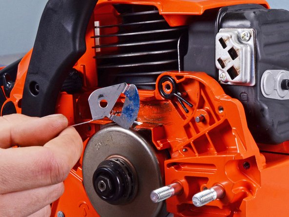

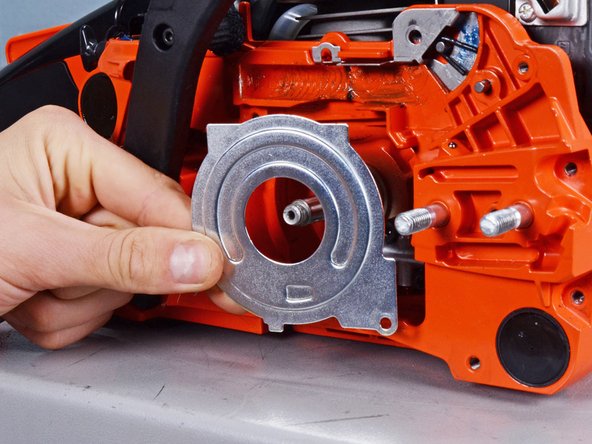

  20. Echo Chain Saw CS4910 2020 Oiler System Replacement, Remove the retaining plate: crwdns2935265:020crwdnd2935265:01crwdnd2935265:03crwdne2935265:0 Echo Chain Saw CS4910 2020 Oiler System Replacement, Remove the retaining plate: crwdns2935265:020crwdnd2935265:02crwdnd2935265:03crwdne2935265:0 Echo Chain Saw CS4910 2020 Oiler System Replacement, Remove the retaining plate: crwdns2935265:020crwdnd2935265:03crwdnd2935265:03crwdne2935265:0
    • Pull the retaining off the chassis and remove it.

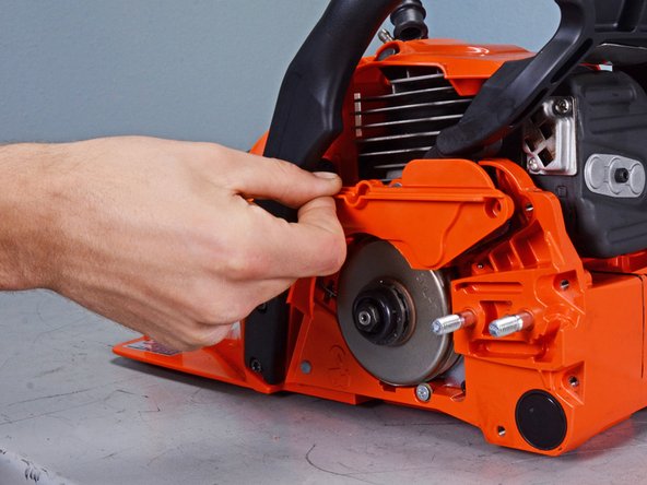

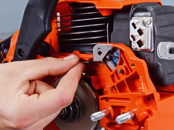

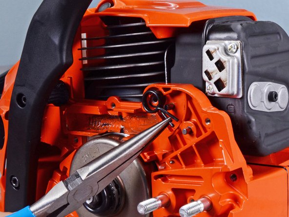

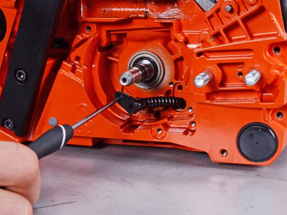

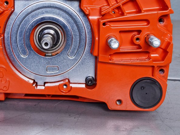

  21. Echo Chain Saw CS4910 2020 Oiler System Replacement, Remove the torsion spring: crwdns2935265:021crwdnd2935265:01crwdnd2935265:03crwdne2935265:0 Echo Chain Saw CS4910 2020 Oiler System Replacement, Remove the torsion spring: crwdns2935265:021crwdnd2935265:02crwdnd2935265:03crwdne2935265:0 Echo Chain Saw CS4910 2020 Oiler System Replacement, Remove the torsion spring: crwdns2935265:021crwdnd2935265:03crwdnd2935265:03crwdne2935265:0
    • Pull the torsion spring off the chassis and remove it.

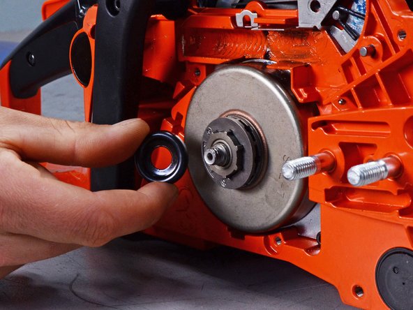

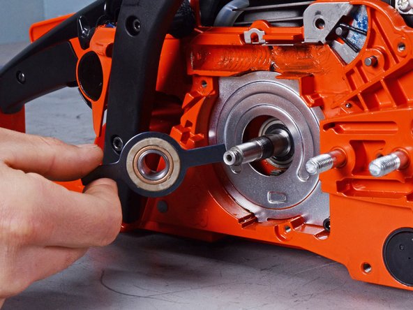

  22. Echo Chain Saw CS4910 2020 Oiler System Replacement, Remove the collar: crwdns2935265:022crwdnd2935265:01crwdnd2935265:03crwdne2935265:0 Echo Chain Saw CS4910 2020 Oiler System Replacement, Remove the collar: crwdns2935265:022crwdnd2935265:02crwdnd2935265:03crwdne2935265:0 Echo Chain Saw CS4910 2020 Oiler System Replacement, Remove the collar: crwdns2935265:022crwdnd2935265:03crwdnd2935265:03crwdne2935265:0
    • Use a flathead screwdriver to pry the collar out of its recess.
    • Remove the collar.

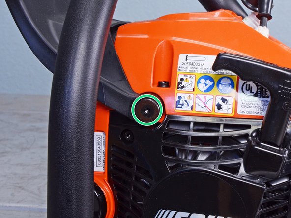

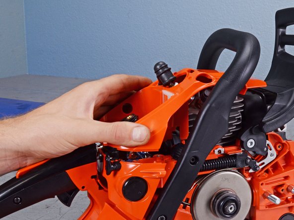

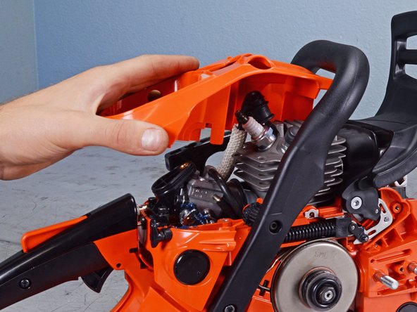

  23. Echo Chain Saw CS4910 2020 Oiler System Replacement, Unfasten the engine cover: crwdns2935265:023crwdnd2935265:01crwdnd2935265:02crwdne2935265:0 Echo Chain Saw CS4910 2020 Oiler System Replacement, Unfasten the engine cover: crwdns2935265:023crwdnd2935265:02crwdnd2935265:02crwdne2935265:0
    • Use a flathead screwdriver, or a 3 mm hex key, to remove the three 18 mm screws securing the engine cover.
  24. Echo Chain Saw CS4910 2020 Oiler System Replacement, Remove the engine cover: crwdns2935265:024crwdnd2935265:01crwdnd2935265:03crwdne2935265:0 Echo Chain Saw CS4910 2020 Oiler System Replacement, Remove the engine cover: crwdns2935265:024crwdnd2935265:02crwdnd2935265:03crwdne2935265:0 Echo Chain Saw CS4910 2020 Oiler System Replacement, Remove the engine cover: crwdns2935265:024crwdnd2935265:03crwdnd2935265:03crwdne2935265:0
    • Pull the engine cover straight up off the engine.
    • Remove the engine cover.

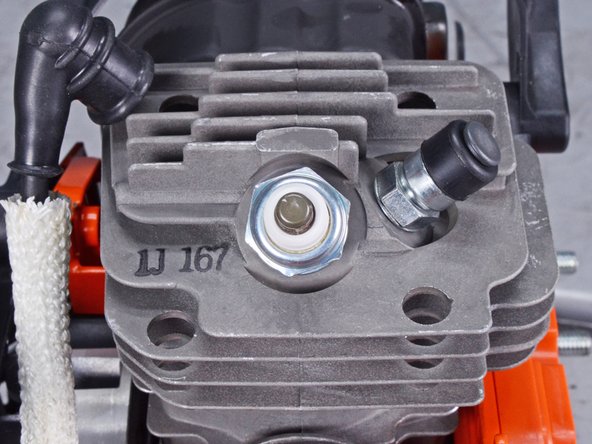

  25. Echo Chain Saw CS4910 2020 Oiler System Replacement, Loosen the spark plug: crwdns2935265:025crwdnd2935265:01crwdnd2935265:02crwdne2935265:0 Echo Chain Saw CS4910 2020 Oiler System Replacement, Loosen the spark plug: crwdns2935265:025crwdnd2935265:02crwdnd2935265:02crwdne2935265:0
    • Use a spark plug socket to loosen the spark plug.
  26. Echo Chain Saw CS4910 2020 Oiler System Replacement, Remove the spark plug: crwdns2935265:026crwdnd2935265:01crwdnd2935265:01crwdne2935265:0
    • Remove the spark plug.

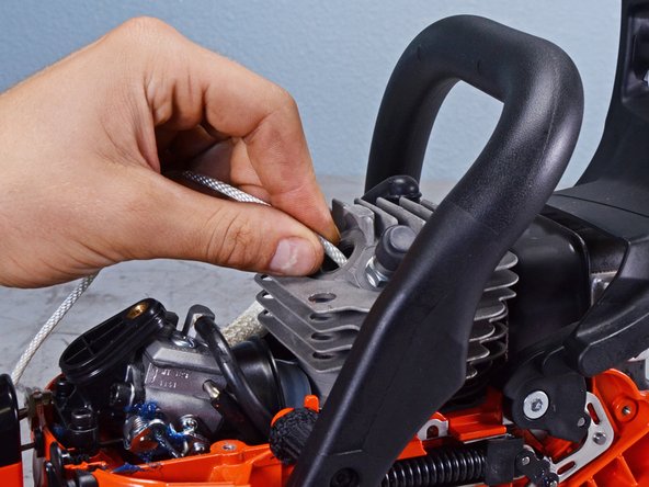

  27. Echo Chain Saw CS4910 2020 Oiler System Replacement, Insert a rope: crwdns2935265:027crwdnd2935265:01crwdnd2935265:03crwdne2935265:0 Echo Chain Saw CS4910 2020 Oiler System Replacement, Insert a rope: crwdns2935265:027crwdnd2935265:02crwdnd2935265:03crwdne2935265:0 Echo Chain Saw CS4910 2020 Oiler System Replacement, Insert a rope: crwdns2935265:027crwdnd2935265:03crwdnd2935265:03crwdne2935265:0
    • Insert a piston stopping cord or rope through the cylinder head into the combustion chamber until the crankshaft can no longer turn over.
    • Do not insert the entire cord into the combustion chamber.

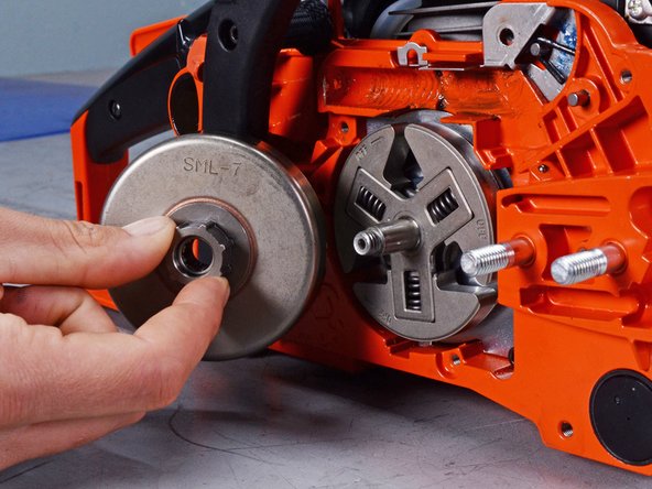

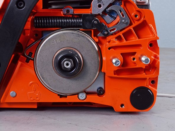

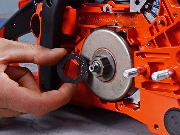

  28. Echo Chain Saw CS4910 2020 Oiler System Replacement, Remove the clutch drum nut: crwdns2935265:028crwdnd2935265:01crwdnd2935265:02crwdne2935265:0 Echo Chain Saw CS4910 2020 Oiler System Replacement, Remove the clutch drum nut: crwdns2935265:028crwdnd2935265:02crwdnd2935265:02crwdne2935265:0
    • Use a 13 mm wrench to loosen and remove the clutch drum nut.

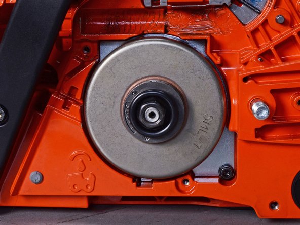

  29. Echo Chain Saw CS4910 2020 Oiler System Replacement, Free the clutch drum: crwdns2935265:029crwdnd2935265:01crwdnd2935265:03crwdne2935265:0 Echo Chain Saw CS4910 2020 Oiler System Replacement, Free the clutch drum: crwdns2935265:029crwdnd2935265:02crwdnd2935265:03crwdne2935265:0 Echo Chain Saw CS4910 2020 Oiler System Replacement, Free the clutch drum: crwdns2935265:029crwdnd2935265:03crwdnd2935265:03crwdne2935265:0
    • Remove the washer.
    • Remove the rim sprocket.

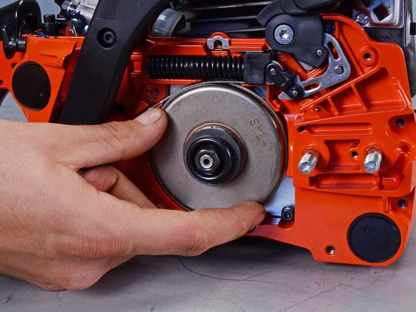

  30. Echo Chain Saw CS4910 2020 Oiler System Replacement, Remove the clutch drum: crwdns2935265:030crwdnd2935265:01crwdnd2935265:02crwdne2935265:0 Echo Chain Saw CS4910 2020 Oiler System Replacement, Remove the clutch drum: crwdns2935265:030crwdnd2935265:02crwdnd2935265:02crwdne2935265:0
    • Pull the clutch drum straight off the clutch assembly to remove it.

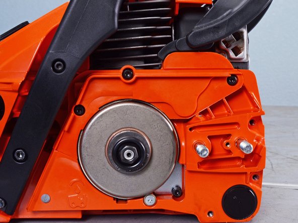

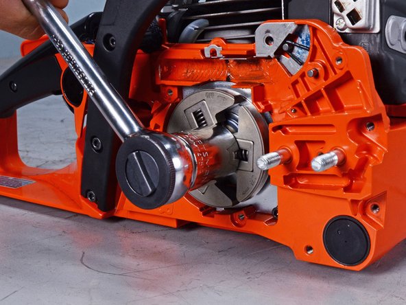

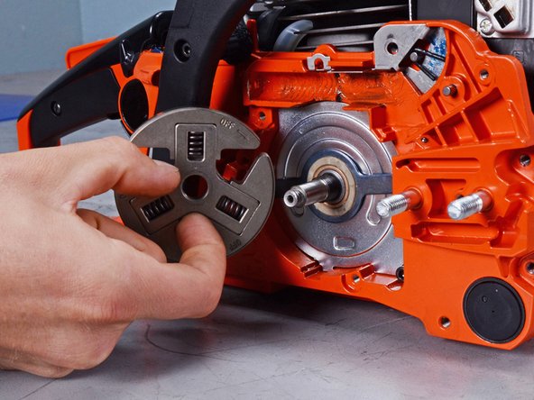

  31. Echo Chain Saw CS4910 2020 Oiler System Replacement, Remove the clutch assembly: crwdns2935265:031crwdnd2935265:01crwdnd2935265:02crwdne2935265:0 Echo Chain Saw CS4910 2020 Oiler System Replacement, Remove the clutch assembly: crwdns2935265:031crwdnd2935265:02crwdnd2935265:02crwdne2935265:0
    • Use a clutch removal tool to loosen the clutch assembly.
    • Rotate the wrench clockwise instead of counter-clockwise.
  32. Echo Chain Saw CS4910 2020 Oiler System Replacement, Remove the clutch assembly: crwdns2935265:032crwdnd2935265:01crwdnd2935265:02crwdne2935265:0 Echo Chain Saw CS4910 2020 Oiler System Replacement, Remove the clutch assembly: crwdns2935265:032crwdnd2935265:02crwdnd2935265:02crwdne2935265:0
    • Remove the clutch assembly.
  33. Echo Chain Saw CS4910 2020 Oiler System Replacement, Remove the worm gear assembly: crwdns2935265:033crwdnd2935265:01crwdnd2935265:02crwdne2935265:0 Echo Chain Saw CS4910 2020 Oiler System Replacement, Remove the worm gear assembly: crwdns2935265:033crwdnd2935265:02crwdnd2935265:02crwdne2935265:0
    • Pull the worm gear assembly off of the crankshaft and remove it.

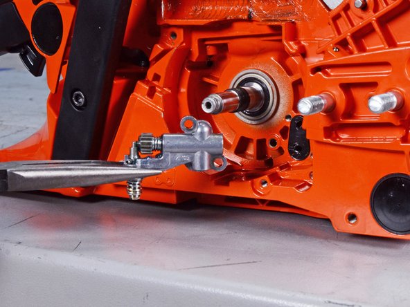

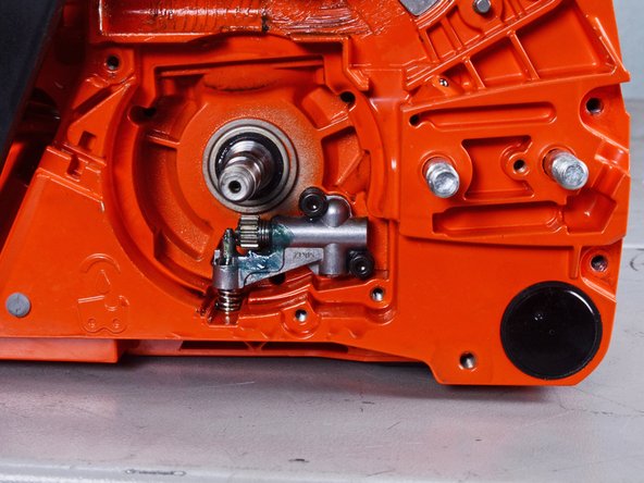

  34. Echo Chain Saw CS4910 2020 Oiler System Replacement, Unfasten the oiler cover: crwdns2935265:034crwdnd2935265:01crwdnd2935265:02crwdne2935265:0 Echo Chain Saw CS4910 2020 Oiler System Replacement, Unfasten the oiler cover: crwdns2935265:034crwdnd2935265:02crwdnd2935265:02crwdne2935265:0
    • Use a 3 mm hex key to remove the 18 mm-long screw securing the oiler cover.
  35. Echo Chain Saw CS4910 2020 Oiler System Replacement, Remove the oiler cover: crwdns2935265:035crwdnd2935265:01crwdnd2935265:02crwdne2935265:0 Echo Chain Saw CS4910 2020 Oiler System Replacement, Remove the oiler cover: crwdns2935265:035crwdnd2935265:02crwdnd2935265:02crwdne2935265:0
    • Use a pick tool to remove the oiler cover from its recess.
  36. Echo Chain Saw CS4910 2020 Oiler System Replacement, Unfasten the auto-oiler assembly: crwdns2935265:036crwdnd2935265:01crwdnd2935265:02crwdne2935265:0 Echo Chain Saw CS4910 2020 Oiler System Replacement, Unfasten the auto-oiler assembly: crwdns2935265:036crwdnd2935265:02crwdnd2935265:02crwdne2935265:0
    • Use a 3 mm hex key to remove the two 18 mm-long screws securing the auto-oiler assembly.
  37. Echo Chain Saw CS4910 2020 Oiler System Replacement, Remove the auto-oiler assembly: crwdns2935265:037crwdnd2935265:01crwdnd2935265:02crwdne2935265:0 Echo Chain Saw CS4910 2020 Oiler System Replacement, Remove the auto-oiler assembly: crwdns2935265:037crwdnd2935265:02crwdnd2935265:02crwdne2935265:0
    • Use tweezers, or your fingers, to remove the auto-oiler assembly from the chassis.

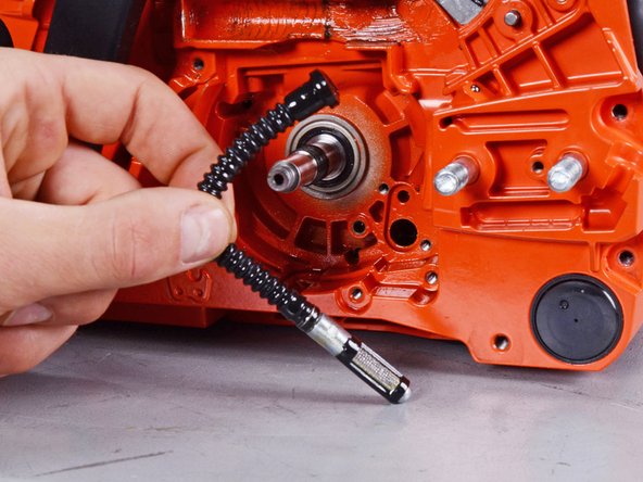

  38. Echo Chain Saw CS4910 2020 Oiler System Replacement, Remove the oil filter assembly: crwdns2935265:038crwdnd2935265:01crwdnd2935265:03crwdne2935265:0 Echo Chain Saw CS4910 2020 Oiler System Replacement, Remove the oil filter assembly: crwdns2935265:038crwdnd2935265:02crwdnd2935265:03crwdne2935265:0 Echo Chain Saw CS4910 2020 Oiler System Replacement, Remove the oil filter assembly: crwdns2935265:038crwdnd2935265:03crwdnd2935265:03crwdne2935265:0
    • Use a pick tool to pull the oil filter assembly through its hole in the chassis until you can grip it with your fingers.
    • Use your fingers to remove the rest of the oil filter assembly.
