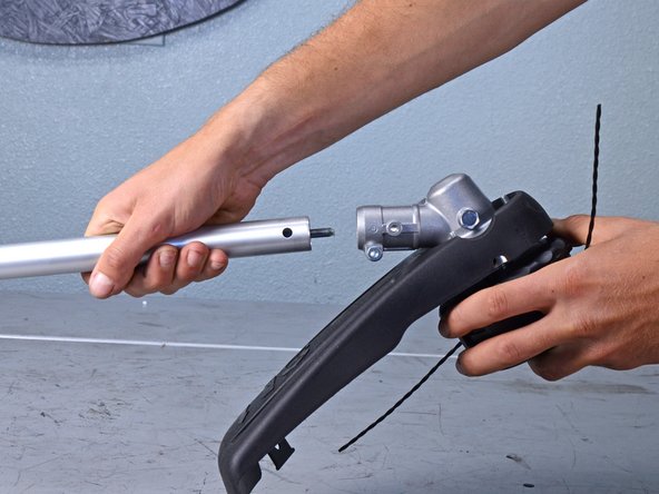

  2. Echo Brushcutter SRM2620U 2017 Flex Shaft Replacement, Remove the cutting head assembly: crwdns2935265:02crwdnd2935265:01crwdnd2935265:01crwdne2935265:0
    • This Echo device has an included multi-tool with a T30 Torx screwdriver, but any T30 Torx driver is compatible.
    • Use a T30 Torx driver to remove the locating screw from the gear case.
    • Use a T30 Torx driver to loosen, but not remove, the collar screw securing the main shaft to the gear case.
  3. Echo Brushcutter SRM2620U 2017 Flex Shaft Replacement: crwdns2935265:03crwdnd2935265:01crwdnd2935265:02crwdne2935265:0 Echo Brushcutter SRM2620U 2017 Flex Shaft Replacement: crwdns2935265:03crwdnd2935265:02crwdnd2935265:02crwdne2935265:0
    • Grip the cutting head assembly and pull to remove it from the shaft assembly.

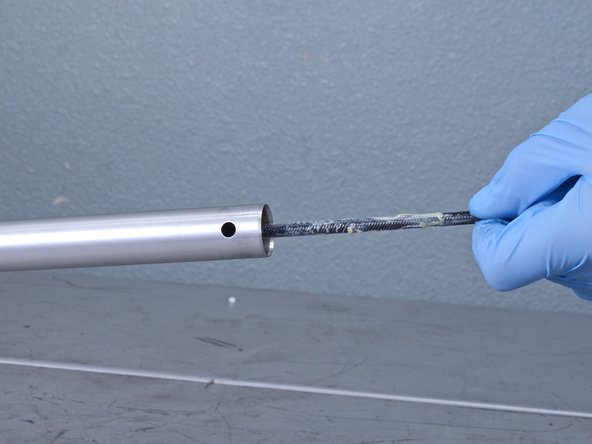

  4. Echo Brushcutter SRM2620U 2017 Flex Shaft Replacement, Remove the flex shaft: crwdns2935265:04crwdnd2935265:01crwdnd2935265:03crwdne2935265:0 Echo Brushcutter SRM2620U 2017 Flex Shaft Replacement, Remove the flex shaft: crwdns2935265:04crwdnd2935265:02crwdnd2935265:03crwdne2935265:0 Echo Brushcutter SRM2620U 2017 Flex Shaft Replacement, Remove the flex shaft: crwdns2935265:04crwdnd2935265:03crwdnd2935265:03crwdne2935265:0
    • Wear gloves when handling and greasing the flex shaft.
    • Grip the flex shaft and pull to remove it from the shaft housing.
    • During reassembly, push the flex shaft into the shaft housing. Spin the flex shaft until the square head seats itself into the clutch fitting.
  5. Echo Brushcutter SRM2620U 2017 Flex Shaft Replacement, Grease the flex shaft: crwdns2935265:05crwdnd2935265:01crwdnd2935265:01crwdne2935265:0
    • If you are re-greasing the existing flex shaft, wipe it clean with a shop towel or rag before reapplying grease.
    • During reassembly, coat the flex shaft with a thin coating of 15 ml (1/2 oz) of lithium-based grease.
    • Take care to not get any dirt or debris on the flex shaft.
