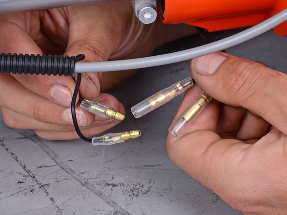

  2. Echo Brushcutter SRM2620U 2017 Clutch Shoes Replacement, Disconnect the control cables: crwdns2935265:02crwdnd2935265:01crwdnd2935265:02crwdne2935265:0 Echo Brushcutter SRM2620U 2017 Clutch Shoes Replacement, Disconnect the control cables: crwdns2935265:02crwdnd2935265:02crwdnd2935265:02crwdne2935265:0
    • Unclip the throttle cable routing clip from the main shaft.

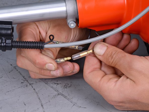

  3. Echo Brushcutter SRM2620U 2017 Clutch Shoes Replacement: crwdns2935265:03crwdnd2935265:01crwdnd2935265:03crwdne2935265:0 Echo Brushcutter SRM2620U 2017 Clutch Shoes Replacement: crwdns2935265:03crwdnd2935265:02crwdnd2935265:03crwdne2935265:0 Echo Brushcutter SRM2620U 2017 Clutch Shoes Replacement: crwdns2935265:03crwdnd2935265:03crwdnd2935265:03crwdne2935265:0
    • Grip both ends of one of the control cable bullet connectors and pull to disconnect it.
    • Repeat to disconnect the second control cable connector.
    • These connectors are interchangeable.

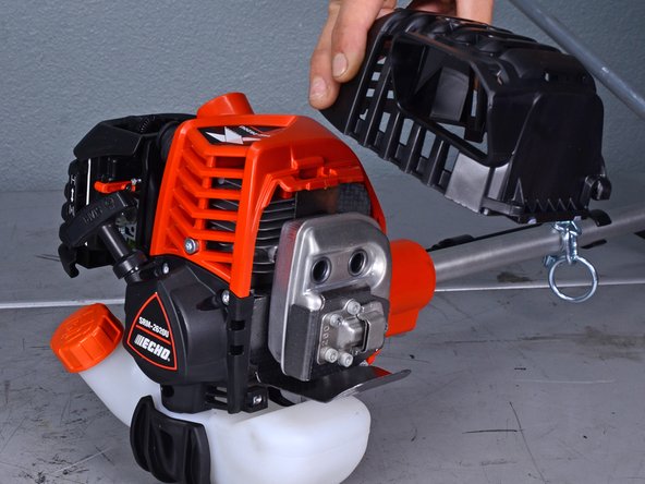

  4. Echo Brushcutter SRM2620U 2017 Clutch Shoes Replacement, Remove the muffler cover: crwdns2935265:04crwdnd2935265:01crwdnd2935265:02crwdne2935265:0 Echo Brushcutter SRM2620U 2017 Clutch Shoes Replacement, Remove the muffler cover: crwdns2935265:04crwdnd2935265:02crwdnd2935265:02crwdne2935265:0
    • This Echo device has an included multi-tool with a T30 Torx screwdriver, but any T30 Torx driver is compatible.
    • Use a T30 Torx driver to remove the two screws securing the muffler cover.
  5. Echo Brushcutter SRM2620U 2017 Clutch Shoes Replacement: crwdns2935265:05crwdnd2935265:01crwdnd2935265:03crwdne2935265:0 Echo Brushcutter SRM2620U 2017 Clutch Shoes Replacement: crwdns2935265:05crwdnd2935265:02crwdnd2935265:03crwdne2935265:0 Echo Brushcutter SRM2620U 2017 Clutch Shoes Replacement: crwdns2935265:05crwdnd2935265:03crwdnd2935265:03crwdne2935265:0
    • Lift the muffler cover up and pivot it on its top edge to unlatch it from the engine cover.
    • Remove the muffler cover.

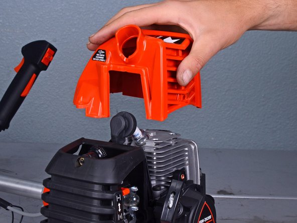

  6. Echo Brushcutter SRM2620U 2017 Clutch Shoes Replacement, Remove the engine cover: crwdns2935265:06crwdnd2935265:01crwdnd2935265:02crwdne2935265:0 Echo Brushcutter SRM2620U 2017 Clutch Shoes Replacement, Remove the engine cover: crwdns2935265:06crwdnd2935265:02crwdnd2935265:02crwdne2935265:0

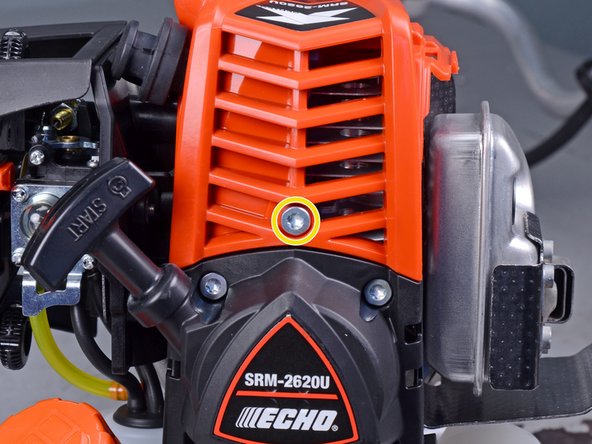

    • Use a T30 Torx driver to remove the two screws securing the engine cover.
  7. Echo Brushcutter SRM2620U 2017 Clutch Shoes Replacement: crwdns2935265:07crwdnd2935265:01crwdnd2935265:02crwdne2935265:0 Echo Brushcutter SRM2620U 2017 Clutch Shoes Replacement: crwdns2935265:07crwdnd2935265:02crwdnd2935265:02crwdne2935265:0
    • Lift the engine cover straight up to remove it.

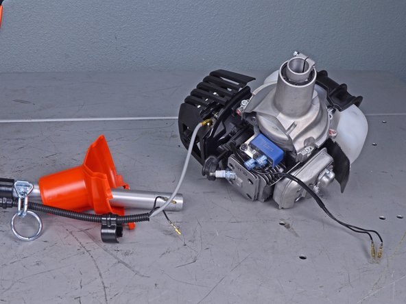

  11. Echo Brushcutter SRM2620U 2017 Clutch Shoes Replacement, Separate the shaft from the engine assembly: crwdns2935265:011crwdnd2935265:01crwdnd2935265:01crwdne2935265:0
    • Use a T30 Torx driver to loosen, but not remove, the collar bolt securing the main shaft to the engine assembly.
  12. Echo Brushcutter SRM2620U 2017 Clutch Shoes Replacement: crwdns2935265:012crwdnd2935265:01crwdnd2935265:03crwdne2935265:0 Echo Brushcutter SRM2620U 2017 Clutch Shoes Replacement: crwdns2935265:012crwdnd2935265:02crwdnd2935265:03crwdne2935265:0 Echo Brushcutter SRM2620U 2017 Clutch Shoes Replacement: crwdns2935265:012crwdnd2935265:03crwdnd2935265:03crwdne2935265:0
    • Grip the engine assembly and pull to remove it from the main shaft.
    • With the engine assembly removed, take care to not put any strain on the still-connected throttle cable.

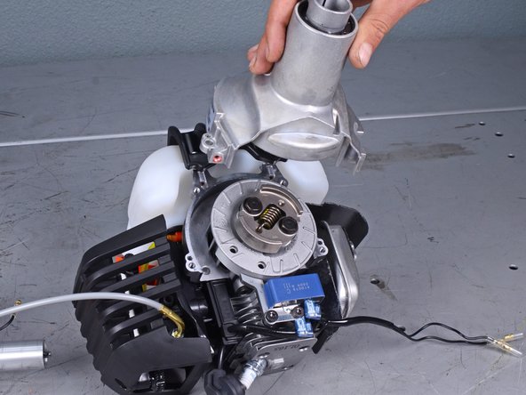

  13. Echo Brushcutter SRM2620U 2017 Clutch Shoes Replacement, Remove the clutch cover: crwdns2935265:013crwdnd2935265:01crwdnd2935265:01crwdne2935265:0
    • Use a T30 Torx driver to remove the two screws securing the clutch cover.
  14. Echo Brushcutter SRM2620U 2017 Clutch Shoes Replacement: crwdns2935265:014crwdnd2935265:01crwdnd2935265:02crwdne2935265:0 Echo Brushcutter SRM2620U 2017 Clutch Shoes Replacement: crwdns2935265:014crwdnd2935265:02crwdnd2935265:02crwdne2935265:0
    • Remove the clutch cover.
